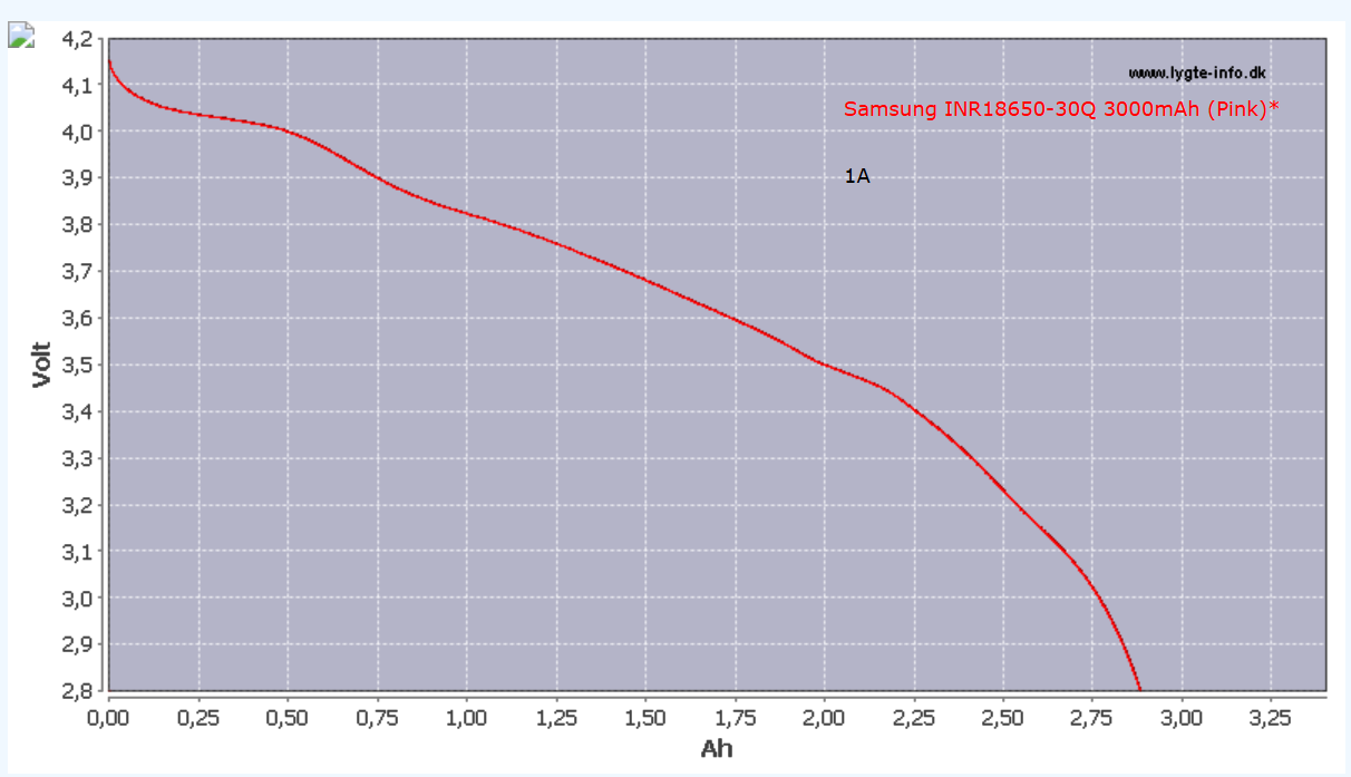

Maybe it’s been already commented, but how come a 3.7V cell when charged measures 4.2V?
Why not calling them 4.2V directly?
It’s confusing, because at 3.5V my flashlight already drops the turbo mode, ramping down in steps and blinking, yet you would think that 0.2V from the nominal value is nothing.

The 3.7V is a nominal “average value” that is useful for calculations, especially when comparing battery performance across different chemistries.
If you want to determine the energy stored in a battery, you need to integrate the below curve (voltage versus mAh discharged) to find its area, which is a difficult task. However, if you were to smush that area into a rectangle of equal base (thus preserving the mAh rating), then its height would be around 3.7V. This is the average voltage during the discharge, and you can express the area (and thus energy) as a much simpler expression: (mAh rating)*3.7V, no integrals involved.
In other words, the 3.7V nominal rating enables you to apply the naive formula (energy equals V times mAh) despite the fact that voltage is not a fixed number.
Thanks a lot, q/p!
Super explanation!
