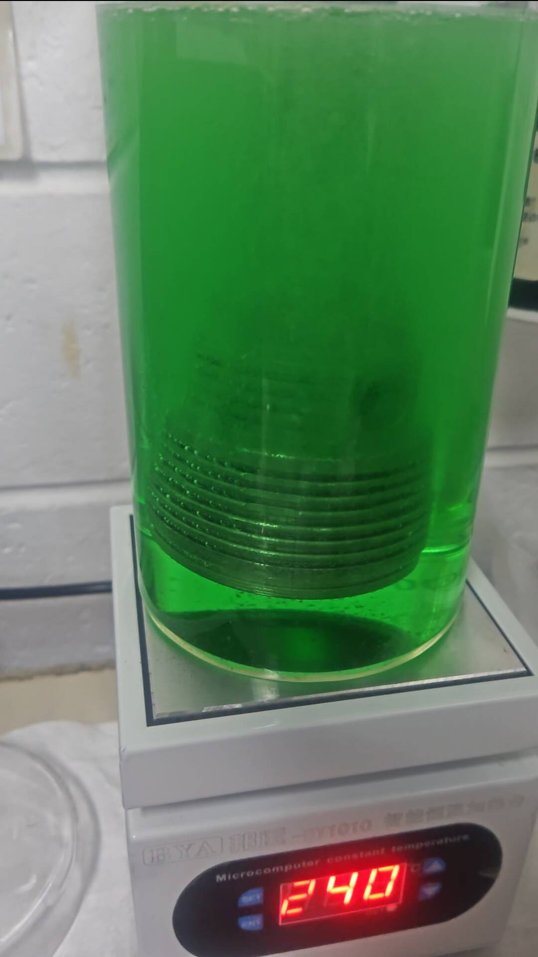

I was using a 3-part electroless nickel plating solution, purchased on taobao.
Before everything, I used 5% Caustic soda(NaOH) to remove the original anodizing. Then I polished the bare aluminium with steel wool and scotch brite. After that, the host was dipped into the first part, an acidic wash/activator, then the second part, the nickel plating solution and then the last part, the finish coating.
I think I can do better in polishing it.
A picture of it in the nickel solution.
It was heated to ~90°C working temperature.
6 Thanks
Got it. So no electroplating is involved. Straight chemical plating.
