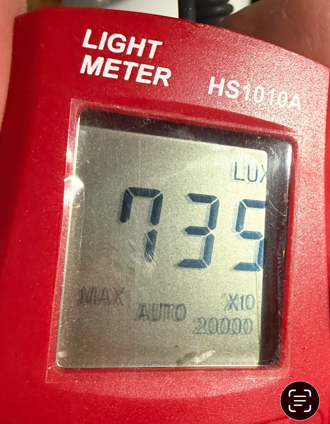

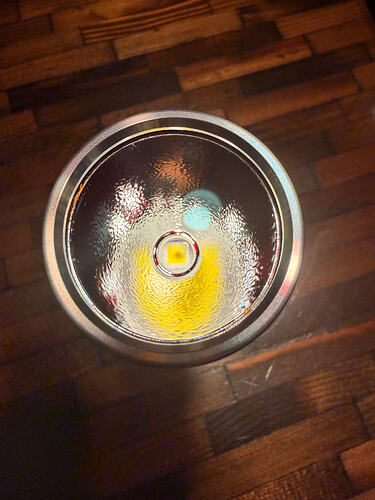

This is from Kai Domain. The K2G. Mechanical switch. 22mm 3v 20 amp Convoy buck driver and a LHP73b in 5k. Beautiful beam and over 7000 lumens measured in my lumen tube! I really like these hosts. They are very well built and zero branding. This one came with an extra switch. The only issue I had with this build was soldering a spring to the host side to make contact with the small diameter post on the driver.

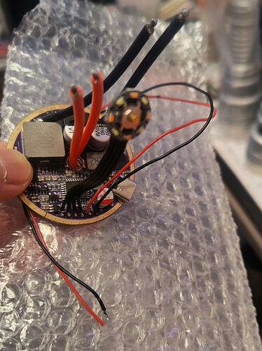

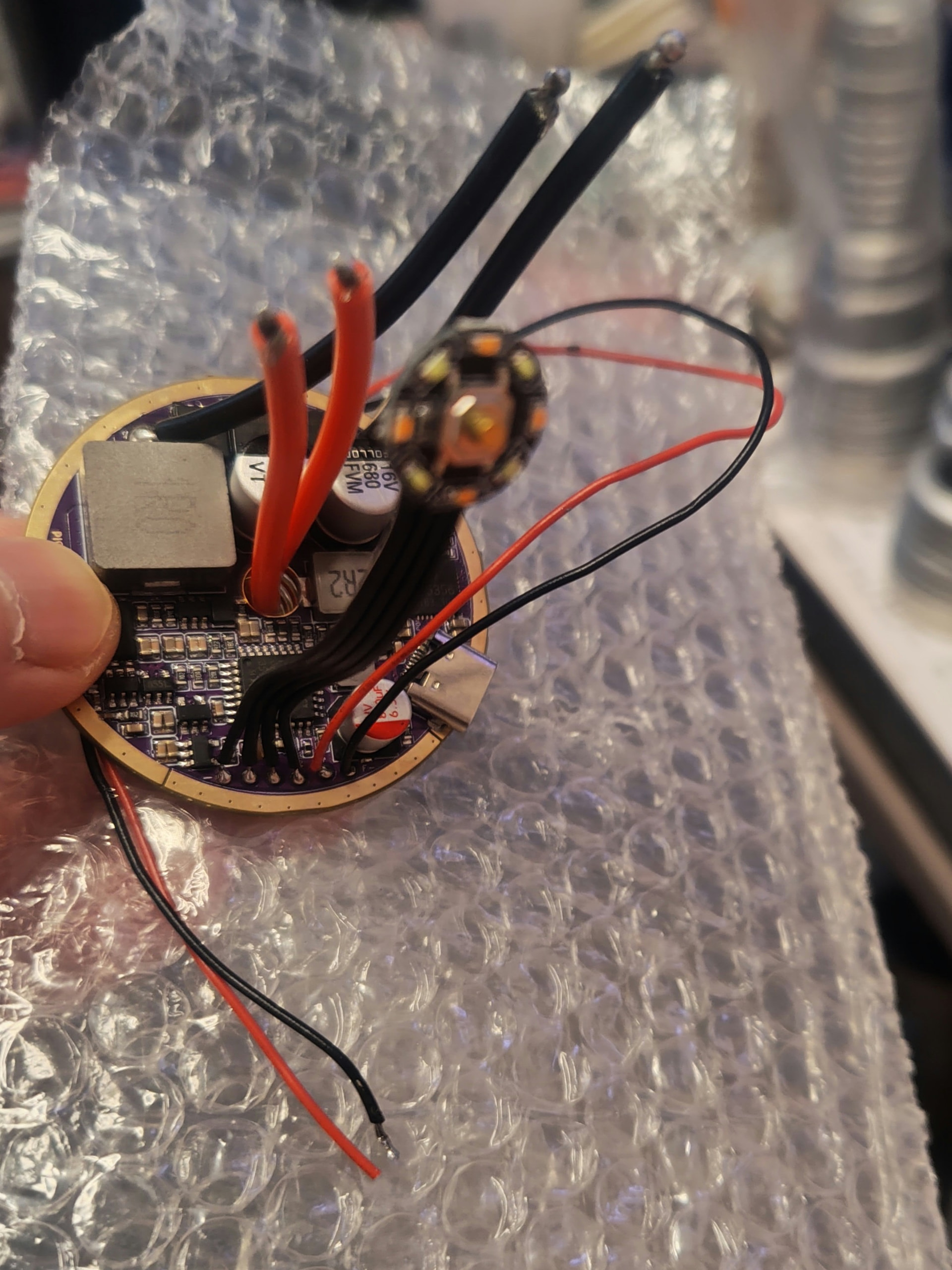

It’s a simple 16A buck + FET driver, with integrated USB-C charging(22.5w) and a custom UI.
