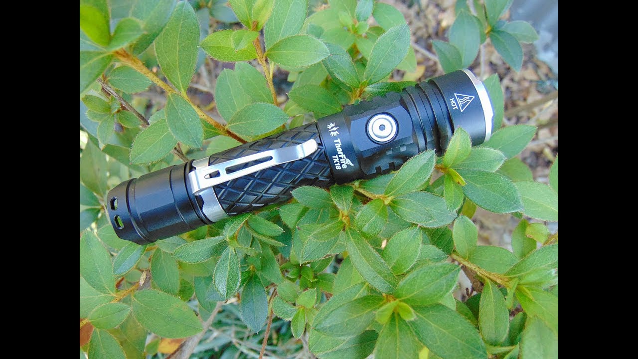

The TK 18 is the newest in the Thorfire lineup of EDC lights. It is an 18650 sized light , but also will accept 2 x CR123A cells. The light comes with the basic user manual and extra O-rings. The UI is a 2 group mode with the “Ramping” and you can also change over to the regular L/M/H/Turbo if you desire the regular modes.
The ramping mode is a little bit slow on the second half of it , although the first half (from moon to around medium) works pretty fast. The regular mode group works as it should. I think Thorfire will probably get this lined out with the lights though given their track record listening to what is said from the end users.
There is a tail switch and side switch both. The tail switch is used for on/off and also for momentary , with a half press and the side switch for the ramping or regular mode changes. The side switch is lighted with a Green light showing when the light is turned on and then it also acts as a voltage indicator turning to Orange when the cell gets below 3.4 volts and then it starts blinking red once the cell is at 2.8 to 3 volts, to let you know the cell is nearing depletion.
The TK 18 has mode memory and it will memorize the last used mode in the regular mode group and come back on in that mode once turned off. In the Ramping mode the light will memorize whatever level you are at and come back on at that level.
The mode groups are changed by 4 quick clicks of the side switch when the light is turned on. In the ramping mode of course you simply press and hold the side switch down to get the desired level of brightness you want and then release the button to stop there. In the regular modes the brightness increases with each click of the side switch and then once you reach the highest setting the order will reverse back down with each click and then vise-versa.
I have found NO sharp edges or any flaws in the anodizing anywhere.
All the threads are well machined square cut threads ,very smooth and were lubed well when I received the light.
The knurling is a large pineapple design and looks very nice , while maintaining a pretty good grip surface still. The fins seem to handle the heat from the light just fine also.
The TK 18 has the XP-L2 emitter in a nice neutral tint , mounted on a DTP all copper board and uses an orange peel reflector , giving a good balance of both throw and coverage , or flood.
