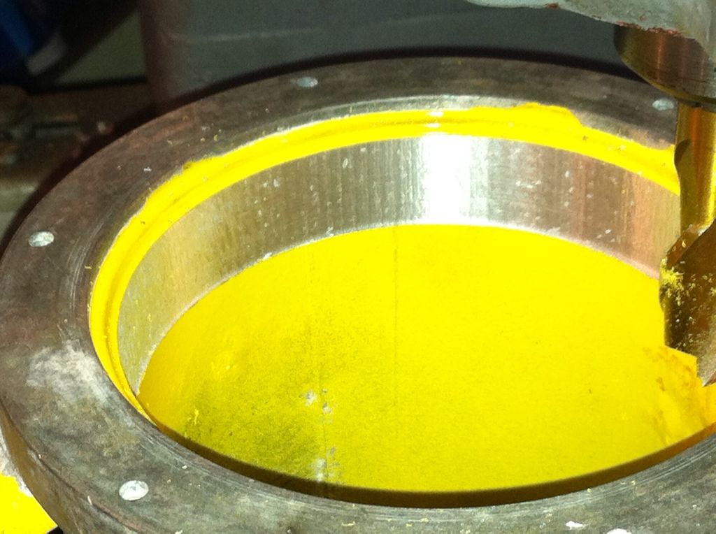

The ID after milling the head is 110mm. It will have 7 XML 35mm reflectors behind a 12 mm acrylic lens. Driver is still in question.

It’s an Allen light. Used for diving, it has a 10-D battery holder and originally housed a 105mm plastic reflector and a reed switch. Allen made dive lights here in Ca. and this is one of the old school type. A client of mine has some machining tools and a few months ago I took the opportunity to do the groundwork on this light. Here it is with the step milled partway to the depth of the reflectors plus heat sink.
Seriously that thing is bigger than my coffee cup. So this monster is going to drive a solitair emitter? I hope your not going to make one of them, I cant see a driver, light this big baby up.
How many Solitaires do you think you could fit in that thing ?
