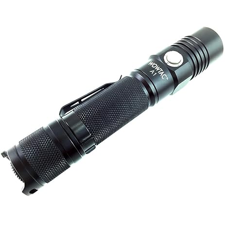

Because of you’re affirmation on great knurling relating to “all” Thrunite lights it just occurred to me that their Wowtac line may share the same awesome knurling, I don’t own a Wowtac (yet) but it sure looks that way:

I noticed Thrunite had a less expensive line-up. I’d like some quality comparisons of both.
