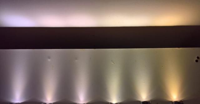

(L-R) sw-45 - swX - sw/smX - sm403 - sw40 IS - sm353
The CREE XPL-HI 3A is said to produce a balanced ‘white’ combination of all colors, good enough to be considered tintless (without color) by many.
When needing Chromotherapy, you can have wall paint custom mixed if the factory doesn’t make what you want.

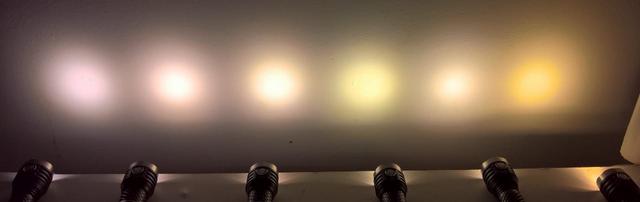

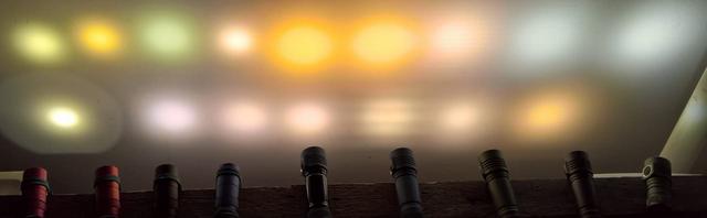

Upper row L-R
XPL Hi 5D - XPL Hi 3000k. 80+Cri - XPL 3D - sw40 - sm273 - sm303 - sw40 - sm50X - XPL Hi 3A
Lower row L-R
sm40X - sw45 - swX - sw/smX - sm403 - sw40 IS - sm353
Six on table - swX - sw/smX - sm403 - sw40 IS - sm353

The following short hand key using Nichia bin nomenclature is used here for these photos.
sw40 I.S. - refers to a 219b 4000k. 92+ Cri Nichia formerly sold by Illumination Supply.
No longer available, its popularity and distribution for an extended period of time made it a reference many can relate too, even without photographic assistance.
sm50X - refers to 219c 5000k. 80+ Cri emitters (sm503, 505, 507), in this case from the first Emisar D4 (version 1) prototypes made available to RMM before general release.
sm40X refers to the 219c 9050 emitter (~sm405) in an Eagtac TX30 thrower appearing only once, as reference in the 16 beam photo.
Unless otherwise mentioned, the rest of the Nichias are from Clemence…
sw45 refers to 219b 4500k. 9080
sw40 refers to 219b 4000k. 9080
sm403 refers to 219c 4000k. 9050
sm353 refers to 219c 3500k. 9050
sm303 refers to 219c 3000k. 9050
sm273 refers to 219c 2700k. 9050
sm4070e refers to 219c 4000k 9050 sextant binned 7 step ‘deviants’
…………selected for being mostly below the ANSI BBL.
swX refers to 2 x sw45 9080, plus 1 x sw40 9080
sw/smX refers to 1 x sw45 9080, 1 x sw40 9080, and 1 sm4070e 9050 all L2 voltage.
smX4 refers to 2 x sm50X and 2 x sm303, all L1 voltage.
smX3.5 refers to 2 x sm403 and 2 x sm303, all L1 voltage.
Rose refers to a mixture of pink and magenta.
Champagne Rose adds a slight yellowish hue to magenta-rose for balance.
Pink lacks the magenta factor (sm4070e).
*Significant changes in tint can result from alterations in the level an emitter is driven.
Gaming here refers to strait line extrapolation while mining the region below the curved BBL.
Endogamy refers to marriages within Family groups, in this specific case to maintain and enhance features such as tint.
(Use of the words mix, match, blend and combine can have other connotations.)
Images were not adjusted, manipulated, or enhanced by me.
Daylight balance was used with a Lumia 950 cell phone camera.
Wall and table top were ‘high noon’ cold daylight white, similar to calcium carbonate whitewash or titanium dioxide pigment.
Batteries were fully charged, beam distance no longer than arm length.
Emitters were selected and combined in parallel, respecting forward voltage rank (L1 & L2).
TIR optics in the MecArmy PT triples and Emisar D4 Quads eliminate the ‘reflector factor’.
Varying outputs associated with specific MecArmy levels were used, showing from Low (5 - 10 lumens) to Turbo (800 - 1000 lumens).
The PT triple displayed current ripple at times, but never visible to my eyes. It identifies the sm403 or the sm4070e substituting it after an emitter swap.
Summary.
The smX3.5 appears similar to the sm353, arguably exhibiting more rose/pink.
The benefits of gaming are more pronounced with the smX4.
(The higher lumen flux of the 5000k. emitter might boost the CCT average higher than 4000k.)
In preliminary comparisons, as in the upper right corner of the 16 beam group photo, the D4 with XPL-Hi 3A looked more neutral than the D4 with sm50X 80+ CRI emitters.
Pushed hard, the Nichia blossoms more rose.
Adding sm303 emitters, the change is radical.
Especially the Nichia 219c sm503 and sm403 are commonly found above the locus.
The sm303 added significant red to the sm50X 80+ Cri emitters.

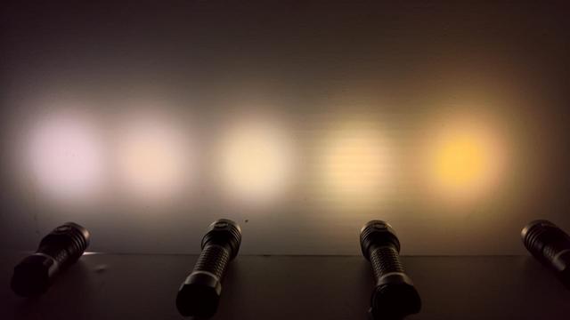

XPL-HI 3A vs. 219c smX4
sw40 IS vs. smX4
_
XPL-Hi 3A vs. smX3.5. vs. sm353
_
XPL-Hi 3A vs. sw40 IS. vs. smX3.5. vs. sm353
Low and High output
L-R. w45 - swX - sw/smX - sm4070e - sm353

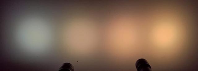

A Nichia sw40 amid CREE emitters.
The following photo compares 4 matched Astrolux S1 (BLF 6) reflectors lights.
First is the OEM CREE 3D
Followed by the Nichia 219 sw40 9080
Then two CREEs from RMM: (the 5D and the 3000k. 80+)

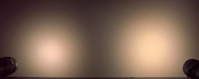

The first three photos show the same three Nichia Hi Cri emitters at varying output levels in PT triples.
Top 219b sw40 9080
Bottom Left 219c sm4070e 9050
Bottom Right 219b sw45 9080
The above photo compares

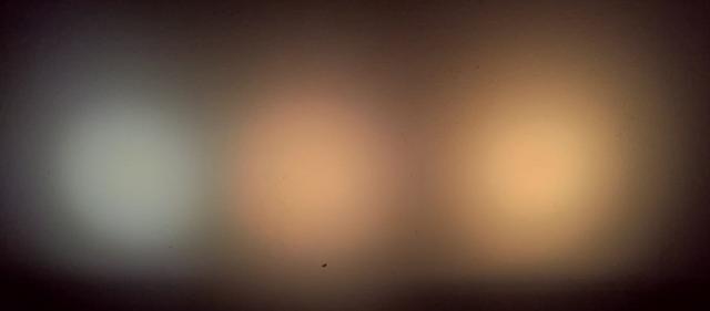

The last two photos below are beams of the same three emitters shown on a wall 10 feet away.
The second photo has been adjusted afterwards to reduce the exposure illumination in order to better differentiate the tint.
Top 219b sw40 9080
