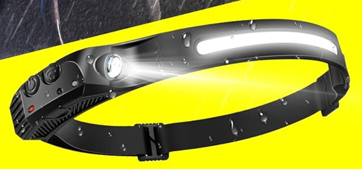

Do I understand this correct, you essentially want to reproduce something like this (just without the little spot thingy), just in rugged:
