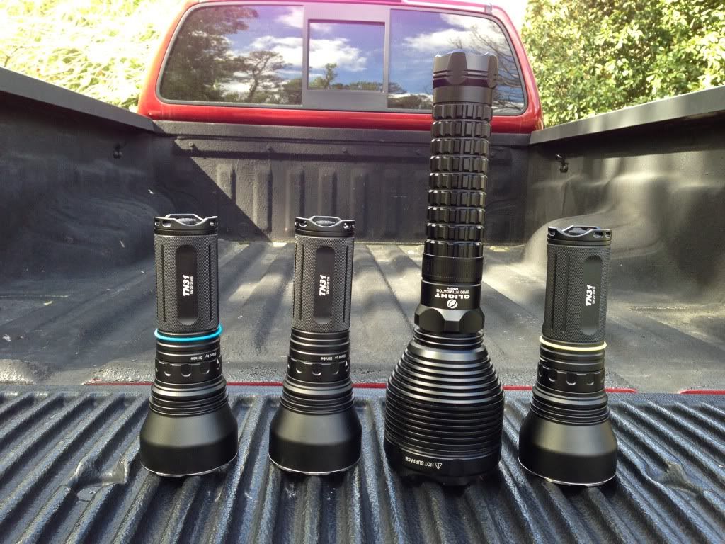

My brother(manxbuggy1) and I have just received a few of our lights back after having several mods done to them. These were done by a another member - unfortunately we don’t have the skills needed. The mods were as follows -

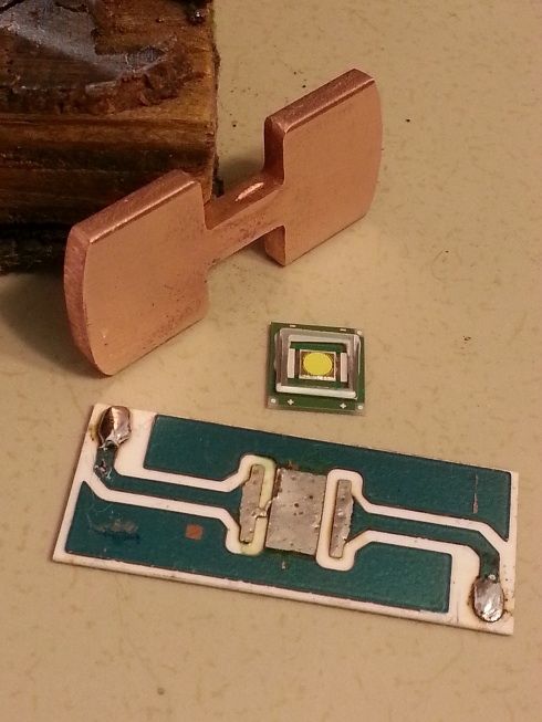

SR90 - a SBT-70 (NA123) was directly bonded on a custom copper heatsink. The reflector was trimmed and adjusted on the base to allow for the thick copper
Sinkpad and for focus. Wires and connections was inspected/replaced as needed
TN31 - a XM-L2 U2 was installed on a copper Sinkpad. All wires and connections were inspected/replaced as needed.
TN31 - a XM-L2 U2 was dedomed and installed on a copper Sinkpad. All wires and connections were inspected/replaced as needed.
Here are a couple shots of the nice work done on the SR90 -

The contestants (note the colored bands so we could tell one TN31 from the other) -
