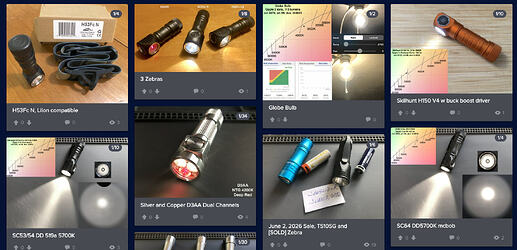

I just do that for myself mostly, to catalog when I get a new light.. I have an imgur library with a LOT of my lights, here is a screen shot of some the lights I have cataloged:
and each of those albums has a bunch of individual pics with more info about each light.
