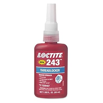

Use loctite when you reinstall them.
The ones from your link are the standart size ones with T8 head (and that ennoying protruding pin that prevents people from using the "normal" torx screwdriver but that's an other story)
For the threadlocker : Already done ;)
