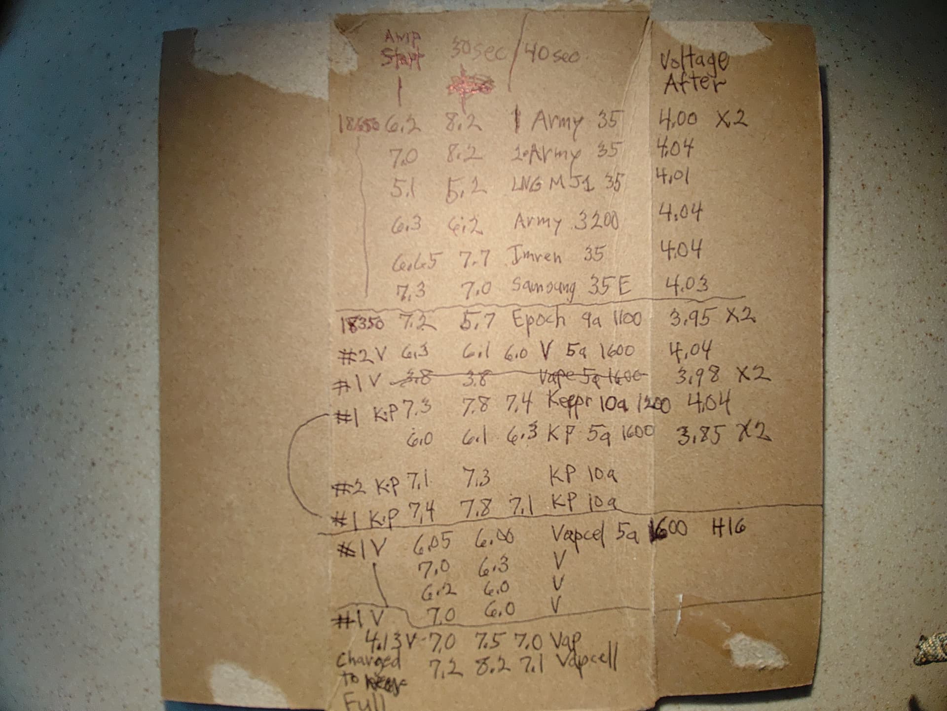

The scorecard might be a little confusing there were 2 vapcel (V) 5 amp labeled 1 and 2.
3 keeppower (KP) batteries. 2 were 10 amp and one 5 amp.
The last six lines were all the same battery with about a one minute rest between tests. And then two more tests with that same battery after I charged it to nearly full.
You’ll see I had a problem the first time I ran that #1V. I think one of the strands of the wire might have been touching the wall but I’m not sure.
I found it interesting that most but not all peaked in amps somewhere around the 30 second mark. I suspect it is in part due to the batteries warming up internally. Although it could be something going on in the driver. Most got fairly stable between 40 seconds and 1 minute. But I didn’t run many of them much beyond 1 minute.

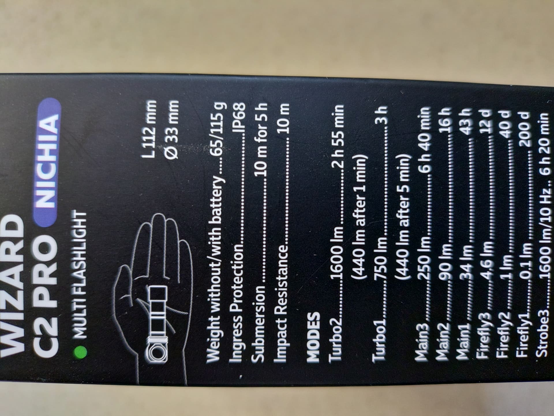

The specs on that wizard are for the 4500k not the 3000k that I have.
It is not the driver that is responsible for Amps jump after 30 sec, I experienced same with some brands of alkaline AA, after about 30 sec, they were able to supply 2x the current, while others brands did not. Believe it or not duracel optimum AA is able to supply 4A. Not for long, but still, 4A from alkaline AA is impressive.

A few of my Armytek loghts do exhibit that ramp up in Turbo, wth output peaking at 30-40 sec affrt turn on..
