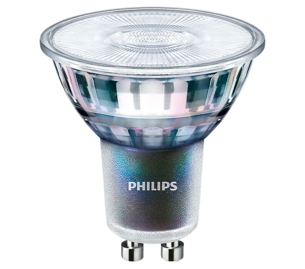

Professional lightning Philips CRI97 spotlights, I have them here in my living room
Philips Master GU10 LED Spot 5.5W 375Lm WW dimmable

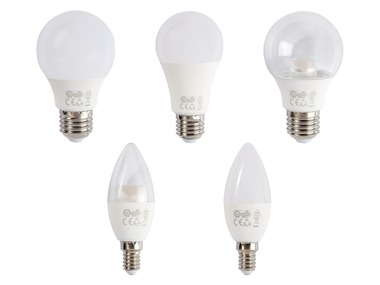

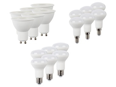

Livarno Lux bulbs from Lidl are advertised as high CRi (>95, sometimes 97 or even 100), they’re pretty cheap at 1,5-5€ each (depends on the country and model) and they come in various shapes, sockets (G10, E14, E27), from 250 to 806 lumens. Sources:
Germany
Poland
Spain

Philips >> GU10 CRI97 offering is great, for sure. Why don't they also make E27 bulbs out of it is a mystery. Maybe a double targetting bias, where GU10 is used to target shops/pro displays, whereas E27 is viewed as consumer only format, and consumer as deemed not interested in great CRI?

LIDL >> claimed specs are interesting, but I can't help but being dubious about a CRI100 offering (who would/could be their manufacturer?). That is making me "scientifically doubt" about pretty much their other claims too, as a consequence. Other bias in my reasonments is that with those "white branded" products, the inside of the product could change with each production run. Any tests (and more precise references) somewhere ?
