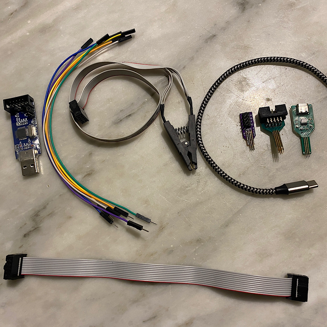

If you have crocodile clamp for Attiny85, yes

Ok you have a pogo for 3 pin for ATtiny1616
Asap I give you a picture of what I have for upgrading various flashlights.
Give me some time to organise my technical staff😌
Edit:
For Attiny85 you need the crocodile clamp you see and you have to connect to the Hank board in the left.
For Attiny1616 you have the pogo and it’s similar to mine pogo right
For Hank flashlights with Attiny 1634 (and some Attiny 85)you need the board and the pin adapter 4+6 you see near the other adapter.
For particular situations you mix all this staff and maybe you solve the problem :relieved:
you need an USBASP and a SOIC clip (the crocodile clamp @Light_Veteran is talking about)

Not particularly but keep in mind:
  • Not all the usbC cable are the same so for T1616 (3 Pin) if firmware installation do not work maybe it’s the cable.
  • Be patient with ZFlasher if you use an Android phone for upgrade driver. There are 2 usb protocol to follow
  • Buy a set of Dupont wires Male to Female, Female to Female, Male to Male for all type of connection.
  • The Hank set is assembled and ready to go for all his flashlight (you need only the UsbA adapter for MIcro
    Usb or UsbC for your smartphone)
For the rest ask without problem
