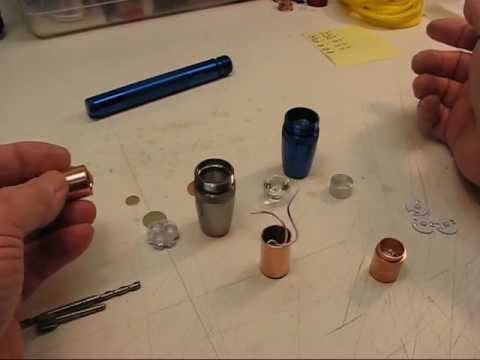

Video-Updated version of a heat sink/pill for the LED style AA Mini-Mags
Just a video of the updated version of the heat sink/pill that I am trying out on the LED Mini-Mag mods.

The copper tube that centers and supports the optic is an elegant solution. Solid!

I did not really think the ano would wear, but I like the Kapton tape as a safety net, to isolate.
Nice video Justin! Your narratives are easy to follow and well thought out. If you cut the threads on the battery tube of a AA incan and bore the head for a driver on both the head and the tube the ano is removed at those points allowing possible electrical contact. This makes isolating the driver ground from the copper sink almost mandatory since even if no ec is made and the cuts are filed, eventually the ano may wear through though the black ano seems much thicker and tougher than the colored minis. On my mods, those two raw edges overlap so I isolate the driver every time. If you don’t bore the head, then you may get away with grounding the driver to the pill but it seems an unnecessary risk.
How long does it take to remove say .5 mm from the head ID using the end mill bit? Using sandpaper on a smaller drill bit it takes me about an hour but the upside is a very smooth bore and I can hold the head in my hand and use either a portable drill or the press. A 3/4” hole saw is 19mm and I use that method to clean it up and get that last mm. Again, thanks for another great video.
It takes me about a half hour to remove the material from the inside of the head. I'm cutting out about 1mm+ of thickness, so .5mm would take less time. I am using a small end mill bit, versus a large one. The bigger the diameter, the more it wants to rip the head out of your hands and kill you. Somewhere around a 3/16" bit is good.
