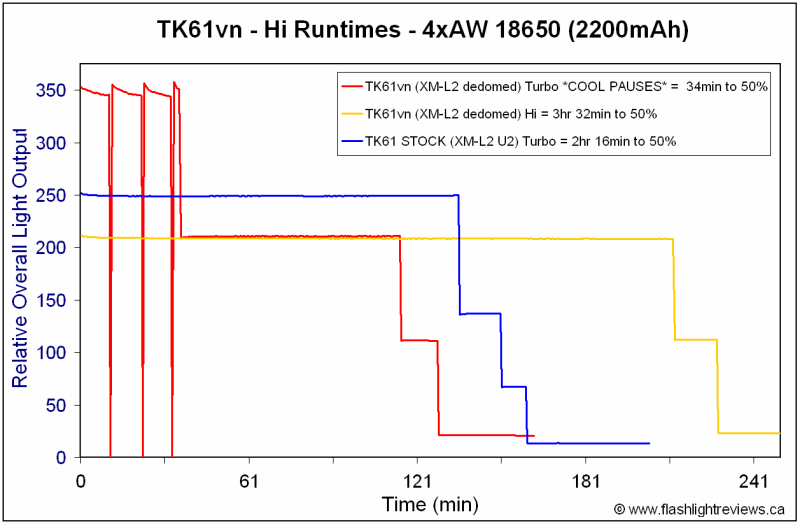

look at the blue line…0 drop, with cells which have huge vdrop……PF are like 0.30v better under load.
http://lygte-info.dk/review/batteries2012/Common18650comparator.php
And TK 75…
Pretty sure cells are around 3.5V when it drops to high, point being, the regulation is fantastic, and you shouldn’t lose almost any output until 3.6/3.5V (offline)
