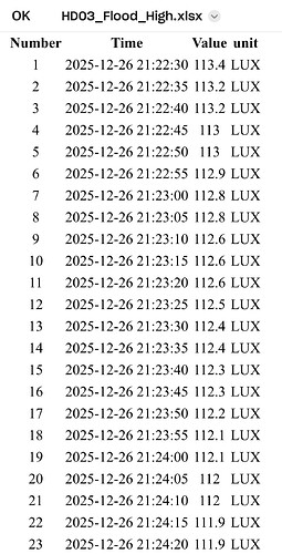

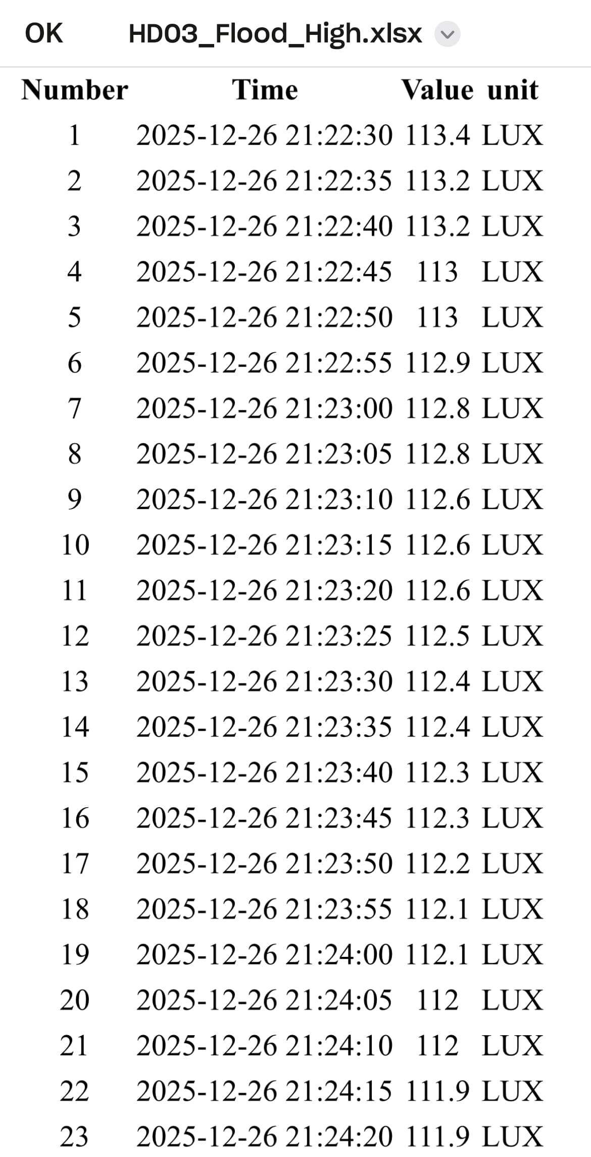

There are two issues here:
  1. How to get a graph
  2. What values to put on the Y Axis
Graph:
  • I have exported the results to Excel format
  • I have added two columns:
    • one with the time relative to the first sample’ timestamp (Time[n]-Time[1]), so I’ve got time starting from zero, and
    • second one with the values divided by the first sample (Value[n]/Value[1]), so I’ve got % values of the maximum
  • I have generated the graph in Excel:
Values on the Y Axis:
  • I don’t have a calibrated setup (integrating sphere + light meter) so the lux results I’m getting from my TASI cannot be considered the total lumen flux coming out of the flashlight (hence % / relative value on my graph instead)
  • I’m totally okay with that because that was my goal :slight_smile:
