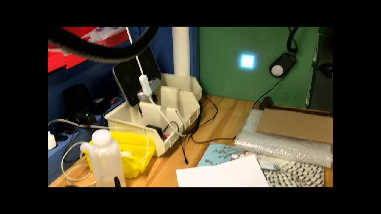

Well, when they show a wavien collar doubling output they tend to use a worst case example (a small lens with a very long focal length) this obviously shows the biggest gain from a collar being added. but in reality with a sensible lens setup the gain will be far less impressive.
Here is an example
You can see there he has picked a lens with a monstrous 100mm+ FL to make the effect as dramatic as possible.
I am getting 600Kcd out of a 67mm lens with a 25mm FL no collar, I cannot get close to that with an L2/L6 size reflector
