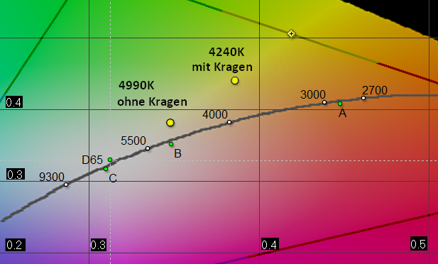

A cool-white LEDs phosphor produces yellow-green light, not orange or reddish light. It will never be truly “warm” like an incan. Only a sickly yellow-green which is warmer than standard cool-white, but not “warm”.
Here is a diagram from sma’s test . He measured the tint before and after. The clear shift of this de-domed XP-G2 towards yellow can be seen. It was probably a 6000K variant before de-doming.
“mit Kragen” means with collar:
