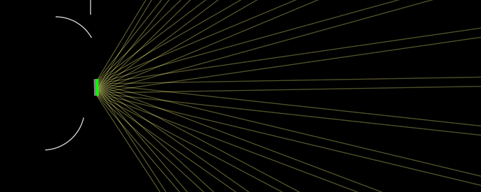

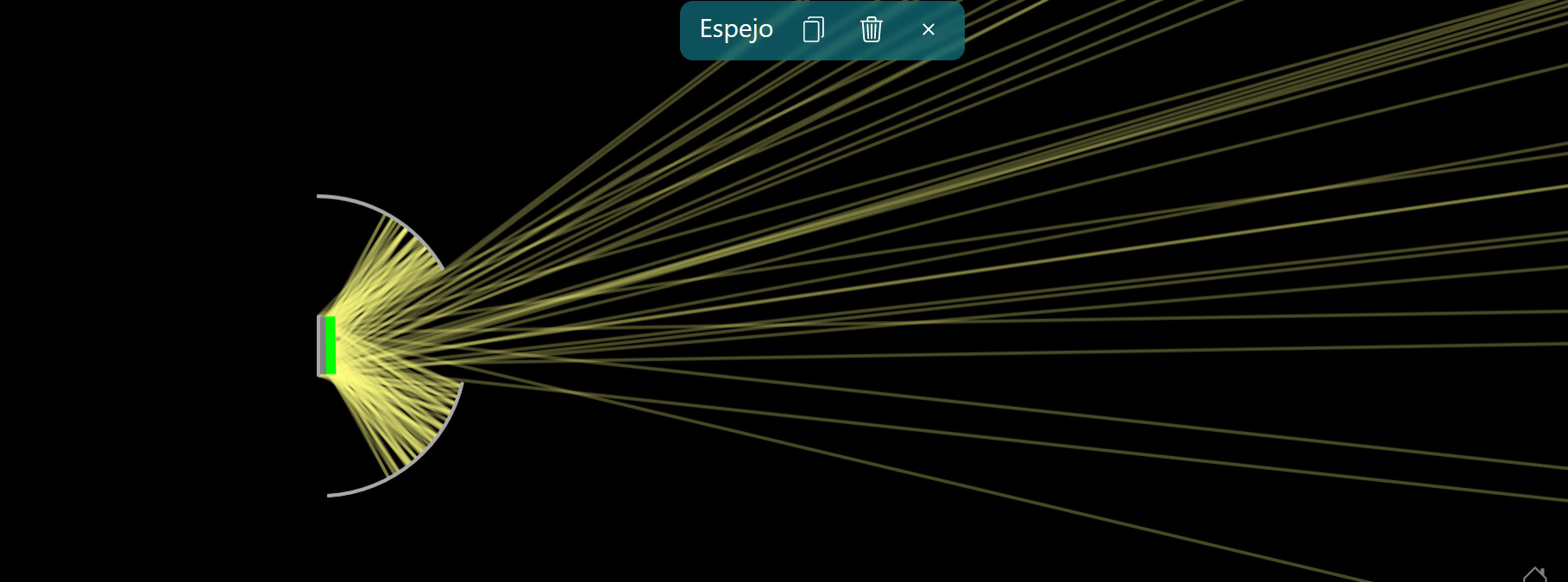

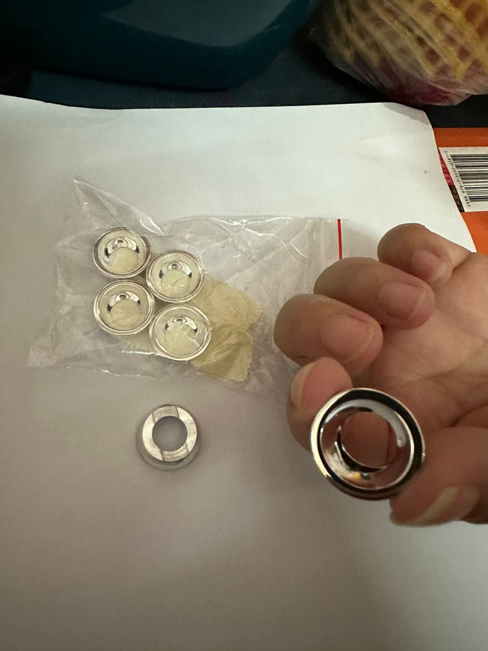

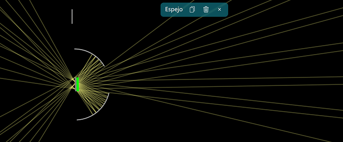

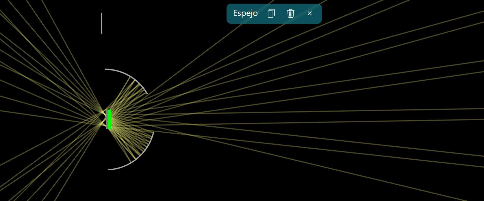

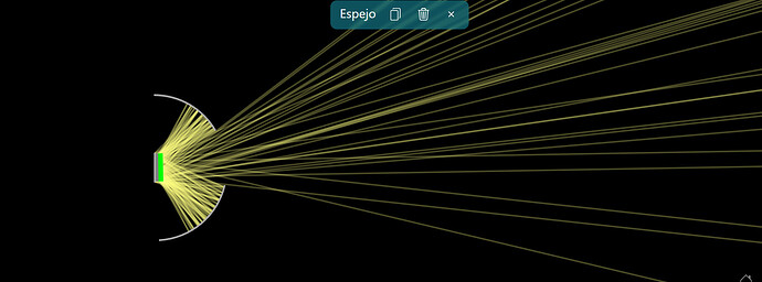

Sorry for reviving this thread, but I still don’t believe that anyone wanted to invest a few dollars and make a small batch of aluminum necklaces, as if it were a flashlight reflector.
I still have doubts about its real performance, since many people tend to inflate their results. But I guess it should work after doing simulations.
So I have already asked my contact in Shenzhen to produce a dozen samples with different apertures and I am going to test whether or not it is worth applying them to the sbt90 led clones, or even to the yinding 5050, in the case of the Osram does not make much sense because the emission area is so small that a precollimator lens gives very good results for a light for practical use.
But the sbt90 clone and the yinding 5050 are worth the test because it is virtually impossible with medium optics and standard focal lengths to achieve good intensity levels.
In a couple of days I will have them on their way and I hope to receive them in a month.
If they work (my version is small, just 20mm external) in the b158 modules as I hope, I will have news for you. At first glance they looked just as you would expect them to.
The real big doubt I have is because no Chinese company has applied them to any model. My concern is that this type of technology would only work with the older LEDs with large emission areas, and not with the more modern ones that have much smaller emission areas.
Or the other reason could be that the very precise alignment they require rules it out for any low-cost flashlight production process.

I have always doubted this claim. The LED surface is a fairly large, especially with an LED like SBT90 or the Chinese round die LEDs. I don’t believe the light recycling effect requires ultra precise ground glass optics, or ultra precise focus. But maybe I am wrong about that.
actually all plastic lens from china have super quality, specially the frenel kind. May be 10 or 12 years before to found a good lens not was so easy ( i am collecting samples since that times and not all was well designed or produced)
I run a lot of simulations in ray optics simulator ( combinating several kinds of lens) and the only option that worked to increase the intensity were the inverted half sphere, then the theory is the system should work. But i believe the kety is to use the leds over his rated by factory current. If you have a led for 10w and push in 30w ( like do the most of brand flashlights in his “turbo” modes) will not exist posibility of to got more creations of photons in the surface of the leds.
But with large leds, and a normal current would work, in theory.
