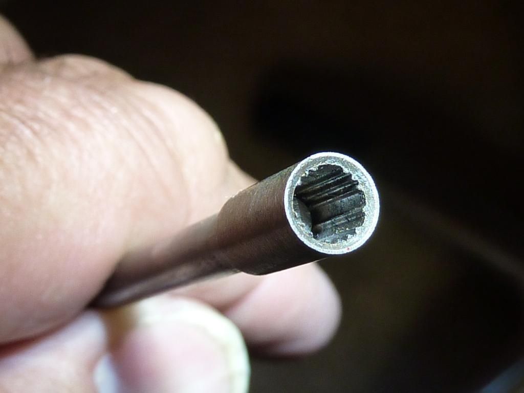

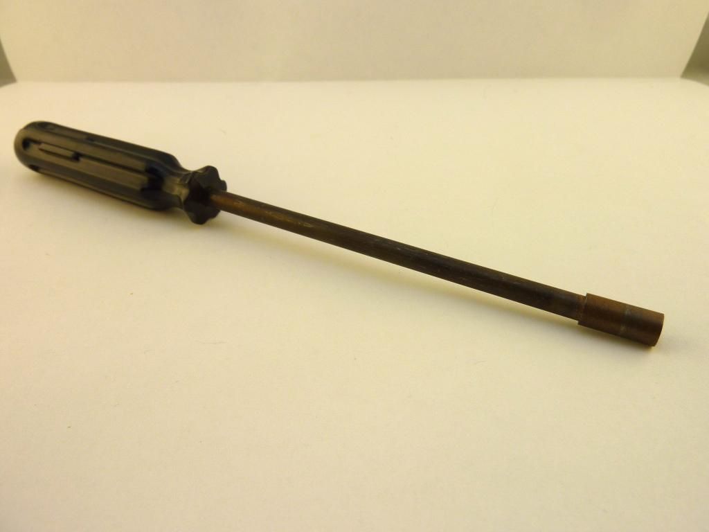

Yeah, I just went through the same sort of thing last year with my pole chainsaw. I replaced the diaphragm with one from another machine but I couldn’t get it started until I ordered a carb adjustment tool off eBay. It was around $7
