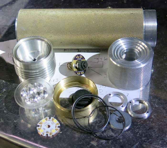

Waiting on a driver to finish.
@MRsDNF - 26650 ?
Close. 2 x rechargeable D cells. This lights for a member here that has given me far to much over the years. The battery tube is from an old D Mag shortened then cooked. Its pretty close to brass in colour.
Very nice looking pile of parts you have there, MRsDNF!
Looks awesome, whoever gets it will be very lucky to have it :smiley:
