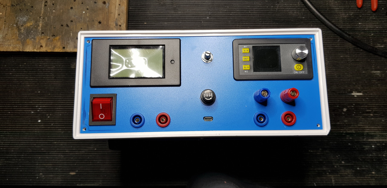

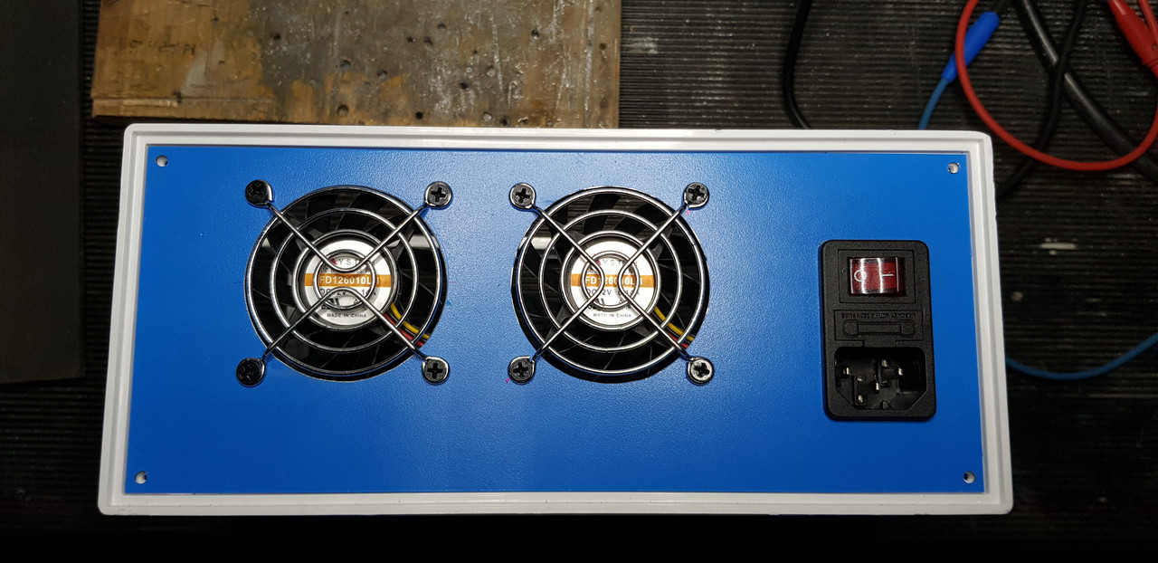

I am a step closer to get my Bench PSU ready. Front and back are finnished now. The internal 480W PSU case is also modded to get better airflow and cooling. Now i have to cut new Air inlets on one side and wire the internals. But i am getting close.
