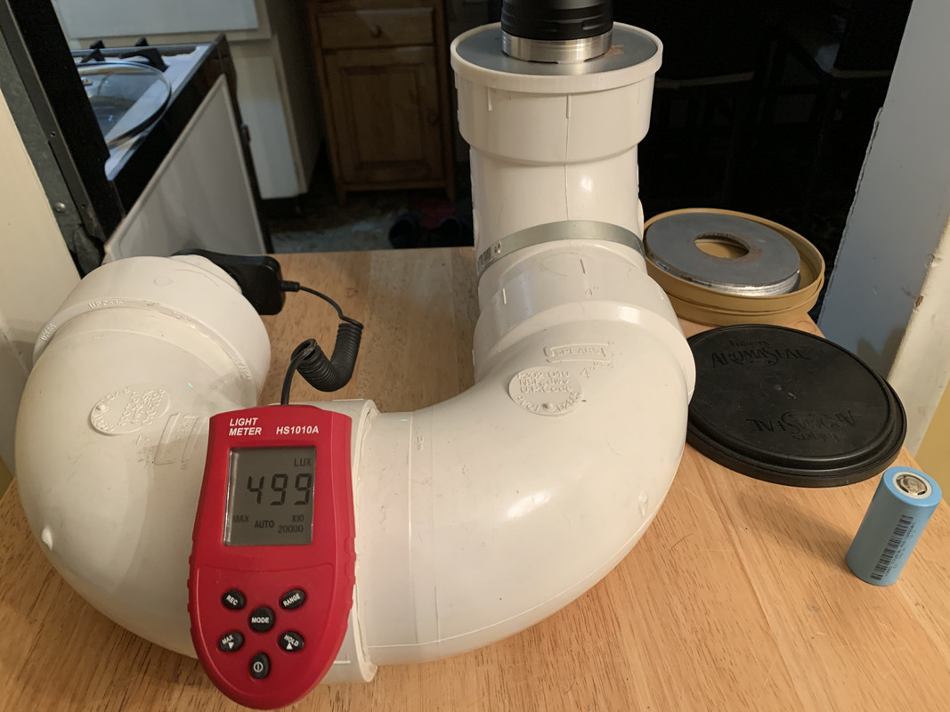

OK here is what I got so far, I swapped the lens and bezel out, UCLp lens added, tailcap spring bypass, stock driver, stock driver dual springs and leads… 30T battery.
5M 14200lux 355kcd
T/O 4990lm
Reset the meter while the light was still in Turbo, grabbed the phone camera and took a pic of the meter with out the lock/hold on…
Amp reading 30T off the charger 4.21v
Checked my LUX readings set-up against my stock FT03 but with a De-domed SST-40 1780lm I got 305kcd as it normally checks.
Need bigger MCPCB’s and Centering rings for this 90.2 and a reflector designed for it would help I think also…
