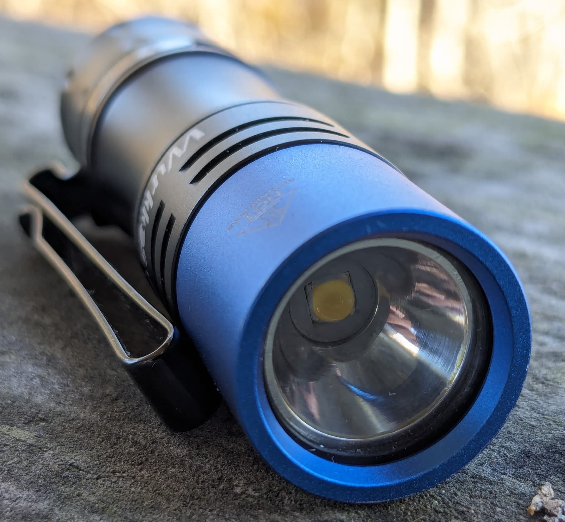

Recently I received an SP10 Pro with a defective switch, so I decided to disassemble the SP10 and make a single-emitter TS10.
| TS10 / SP10 Pro |
Emitter / Reflector |
I ground the face of the reflector to shorten it, so that the stackup would fit the TS10. While doing this, I think I let the reflector get too hot, as it wasn’t as reflective as before. I then attempted to polish the reflector, which removed the “orange peel” texture, and… kind of worked. I still need to wait for it to get dark to see if this reflector actually performs well at all.
I may try using a TIR, or a reflector from a Convoy T2/T3. I’ll also probably install a different emitter.
I wonder how this TIR would perform. I think it would be easier to install than a reflector, since it’s close to being the correct height for the combination of the SP10 bezel and TS10 head.
Edit:
In terms of illuminating distant objects (i.e. “throw”), it seems to be roughly equal to a stock TS10 when they are both set to the same ramp level. Probably this reflector isn’t performing as well as could be hoped, after what was done to it.

If I remember correctly the T2/T3 reflector has a 5mm opening so make sure you have a suitable gasket.
Convoy has 5mm gaskets for 3030 and 3535 emitters.

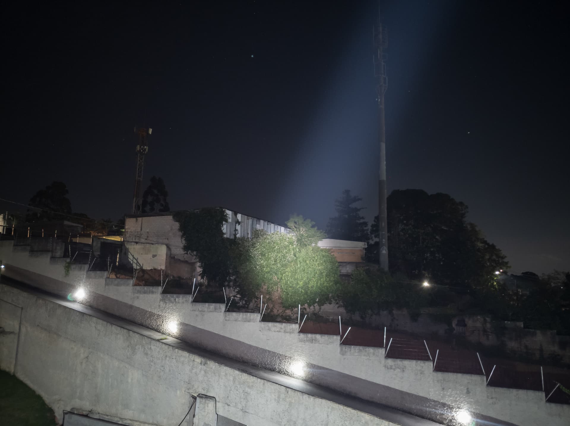

That’s the TIR I’m using on my TS10, it performs very good but the problem was the emitter i was using (519a), the beam pattern was very bad with it (square-ish beam, not much throw improvement over the stock TS10). Now I’m using the Yinding 6500K high CRI LED, and it gives the throw i was expecting with very nice tint and color reproduction, and it’s artifact free now, perfectly round hotspot. Hotspot temperature got down to about 5800K using the SP40a TIR.
Edit: Comparison between stock optics TS10 vs single:
Reference
Stock triple, CSP2323 6000K high CRI.
Single TIR, Yinding 5050 6500K high CRI.

Thanks for the info.
I just put the 5000k SFT-40 that I had recently installed in my PD35 into the TS10, and even with the poor, abused reflector, it now does have quite an improvement in throw.
The beam isn’t super nice looking, though. I wonder how this emitter would perform with that TIR. I will probably end up ordering some of those TIRs, to try. I may also grab some reflectors, and try to treat them more carefully.

Maybe this would be less bad if the reflector was in better shape, and/or by playing around more with the centering gasket.
Do keep in mind just how abused this reflector has been: face ground off, orifice drilled out, orange peel polished away, dented when my bench grinder shot it across my basement, etc.
Edit: With a piece of #3 film the beam looks perfectly fine, and still has more throw than a stock TS10. It did reduce throw somewhat, though.
