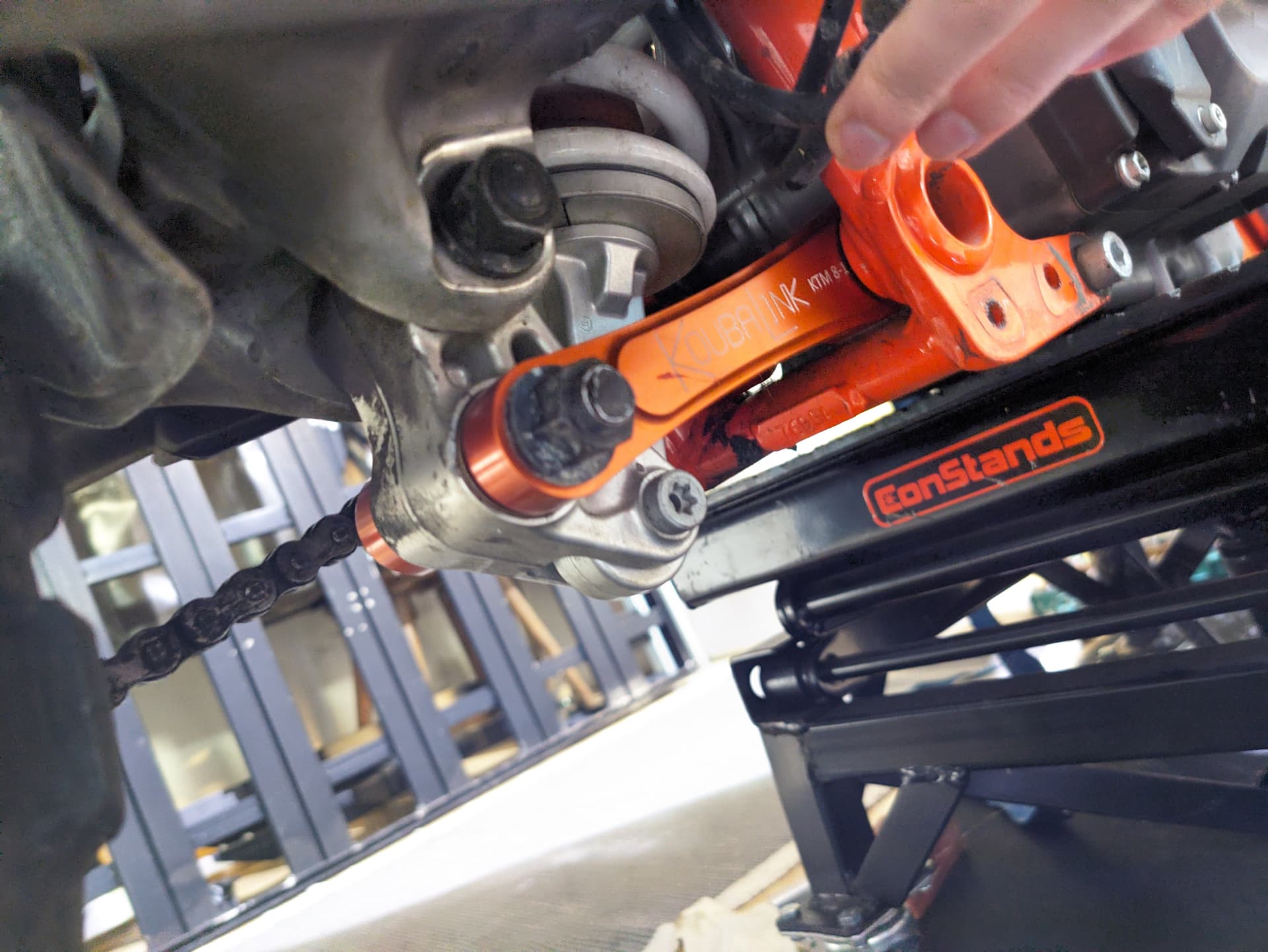

I Hope this thread ain’t flashlight modding only, but I modded my bike today. It even has (modded) LED headlights (4000lm low beam, 4000lm high beam). I wonder which LEDs sit in there, seems to be single emitters for both. That’s a lot of light at 4500K. No doubt low CRI, but I did not measure yet ^^ Today it was not about those though, those have been on for over a year.
Since I’m not particularly tall (1,75m) and the KTM 690 2019+ is one of the tallest bikes around I struggled getting my feet on the ground. Lowered it by ~2-2.5cm today by replacing a part of the rear suspension. Now it looks like a Dachshund, but it’s a whole lot easier for me to get my feet on the ground in tricky situations.

Damn, you’re the brave man. Aren’t you afraid the suspension lowering may trigger some unknown adverse effects?

Nah, this is a fairly well known kit made specifically for the bike. The manufacturer claims that as long as you lower the fork by ~20mm together with the kit on the rear spring, it won’t change the behavior of the suspension much. It gets a bit softer in the rear (in fact I’ll have to add some more tension to the spring), but no other adverse effects.
People who used it in various forums seem to agree.
Wouldn’t have done it otherwise. I’ll test and see how it behaves now. Worst case it’ll take me ~2 hours to get the bike back to stock - I only have to swap the lever back to the OG one.
