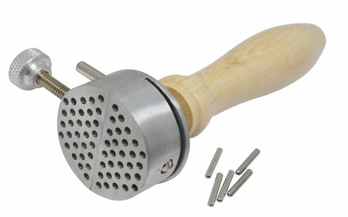

Just got one of these and took the wood handle off.
