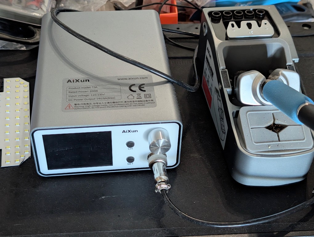

One of my favourite upgrades was when I ditched my 1990’s vintage temperature controlled soldering iron and bought one of the newer digital stations with the heat element built into the tip. It’s now only a couple of seconds from idle to hot instead of over 30 seconds. Plus the iron itself is so light and compact. Combined with the smart iron holder it automatically goes to “sleep” when the iron is replaced in the holder. Then reheats when you pick it up.
Same.
That’s the same soldering station I have. It works great.
Even in my heyday I only had/used equipment which was hardly more advanced than stone knives and bearskins.
I was hesitant to buy it but I’m glad I did. I was taught soldering in the late 1980’s and did a lot in the trade I was in. Back then it was 60/40 rosin cored solder and the soldering temps were easy to remember. These days the melting point of the solders used seems a bit of a guessing game.
The soldering stations we used were top notch, but you had different sized irons for larger jobs. The tech has moved on and the small one I’ve got now is so much better. Buy a couple of different size/ shape tips for the same handle and you’re set for 95% of your work.
The swapping of tips is so nice. I have 2 I use the most and a few I’ve tried only a couple times. I use a small bevel tip the most then a fine point usually for soldering wires to a driver.

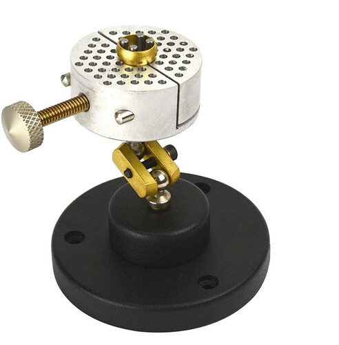

I use one of these I got from Amazon on nearly every flashlight project I’m working on. It can easily hold a driver or mcpcb. Or even the entire head, if needed. You can rotate it, angle it or move it in nearly any way you need. I honestly couldn’t imagine working on lights without it.
Search Amazon:
Universal Aluminum Work Holder Peg Clamp Base Jewelry Making Revolving Vise Bench Tool Set
6 Thanks
I have a pin vice like that clamped in my bench vice but the flexibility of that looks amazing.

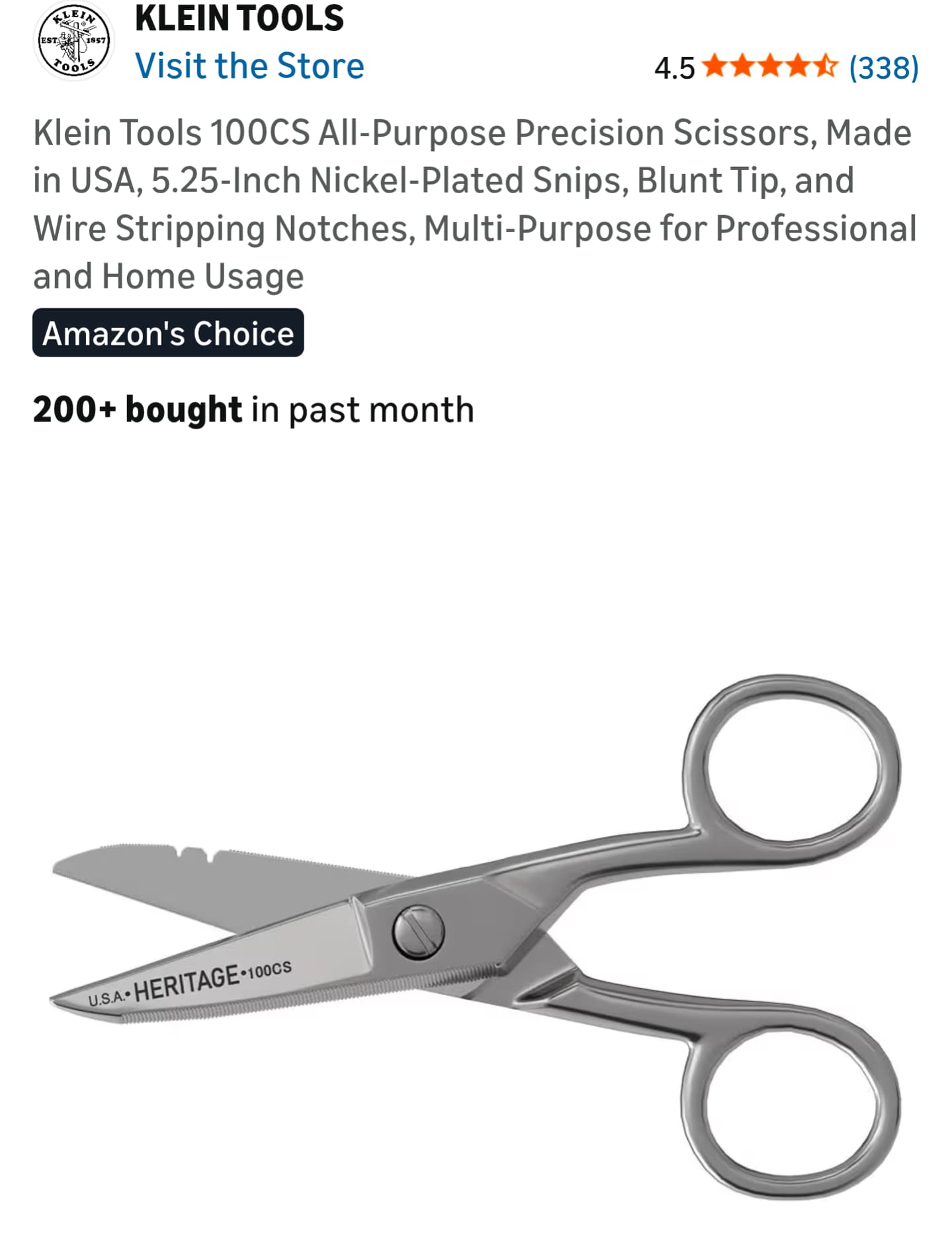

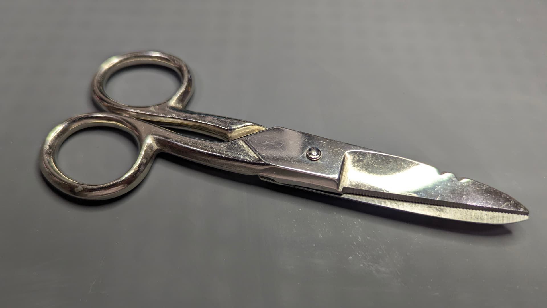

My other big one are these snips by Klein tools. A long time ago someone told me that if I’m doing anything with wire, I should be using these. They’ve come in very handy with flashlight mods.

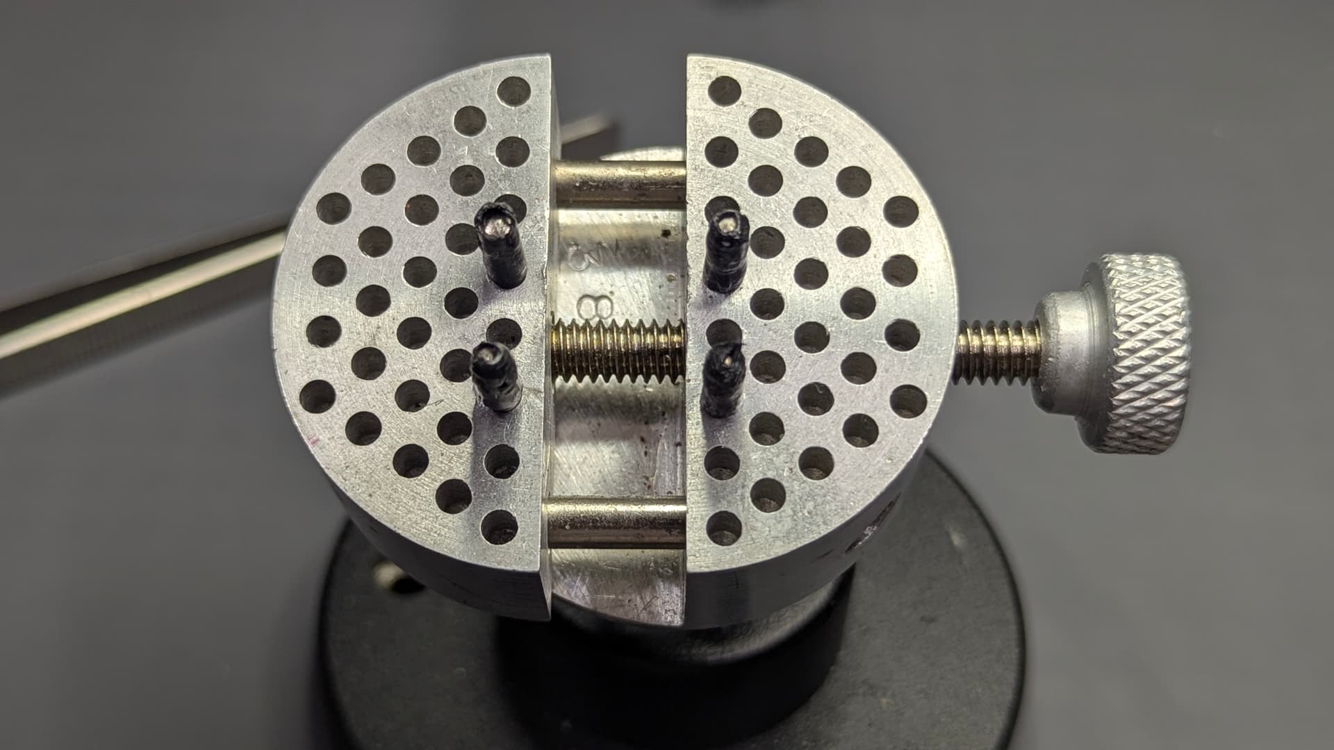

It really is great! I put some shrink tubing on the pins to help protect whatever I’m clamping in. I didn’t even bolt it down. I can move it all over. And the base is heavy enough that it has never once slid or tipped over.
What size snips?
Bought the vice and snips. Thanks!
