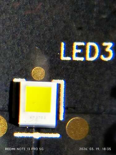

The 1-piece LED in series is KP3703 if I see correctly.

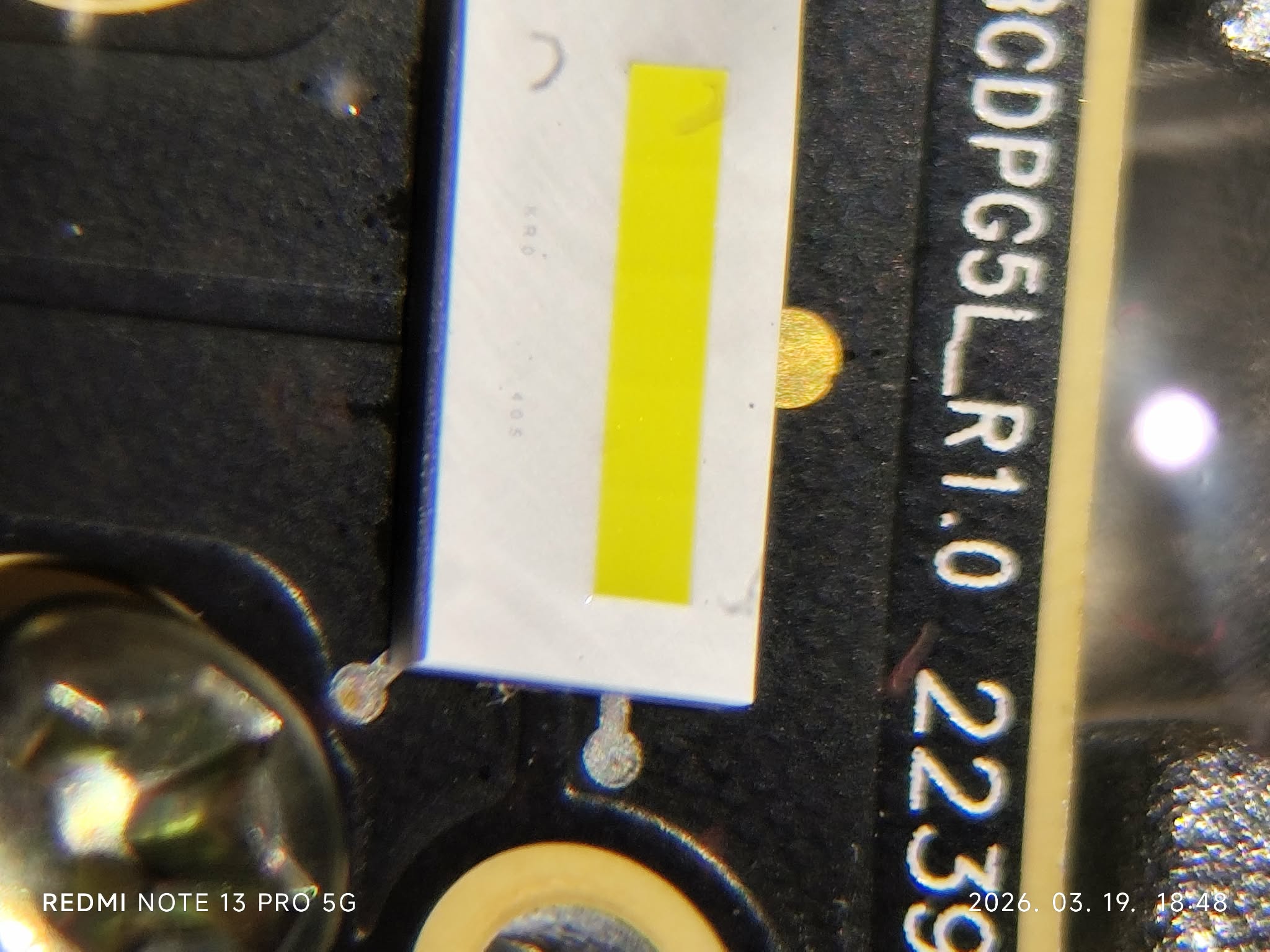

The “big” 5-piece LED in series is labeled KRO 405

The dimensions are:
1.9mm X 1.6mm (KR3703)
7.2mm X 3.5mm (KRO 405)
I’m looking for the type because then I can figure out what current limit to set.

If you’re trying to figure out how much current to set, you don’t necessarily need to know the exact LED.
If you can estimate the yellow area, the vast majority of LEDs can handle 1A/mm^2 easily, and generally can be driven much harder.
If you have a variable power supply, you can increase the current until the LED’s light goes from white to slightly bluish, and stop there. That’s the max current it can safely handle.
