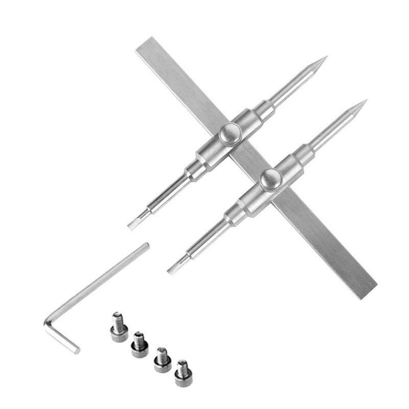

I would recommend a camera lens spanner - a bit dearer but will fit multiple lights. I haven’t got one, yet, but it’s my next purchase.

+1 Go for a camera lens spanner. A kit with adjustable bridge and multiple tips can be had for less than 15 bucks.

Good point, though it’s the kind of tool that has multiple uses and if you get it cheap enough it’s a handy thing to have in a toolbox for £8. As the previous poster said you can get ones with various ends/shapes which is even better.
This is a little more expensive at £11.59 but has more options. You can also more easily ‘angle’ the legs to fit in tighter spaces. LINK
