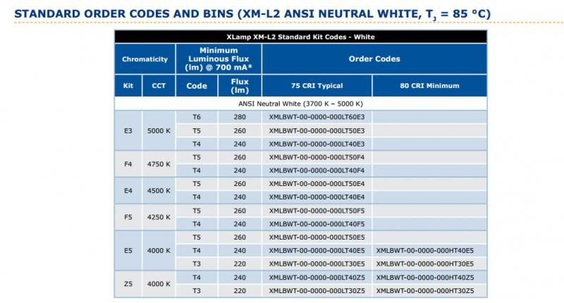

There is (officially) no such thing as T6 bin for 4C tint (about 4500K) Neither for XM-L or XM-L2.
Fast-techs distributor are the only one who have had “access” to that emitter it seems. Most likely they made it up! :wink:
T5 4C is much more likely… Yes, I am aware of your ceiling bounce. But still…
If you check the LED database (see my signature, and sort so that you see all XM-L2s) you will see that Mouser sell XM-L2 T5 4500K emitter. About the same Kelvin as 4C.

If you want more output than (80+ CRI) T4 5B1 it seems you will either have to buy T5 5C from Illumination supply, or T6 3C unless you order T5 4500K emitter from Mouser. Or wait around for days or maybe a year or more, until T5 4C becomes available from other vendors…
I would not bother waiting for a T6 4C… Most likely, its not real. Its not listed in the Cree datasheet, nor have it been sold by any of the trustworthy vendors or flashlight makers. At least, Im not aware of it…
