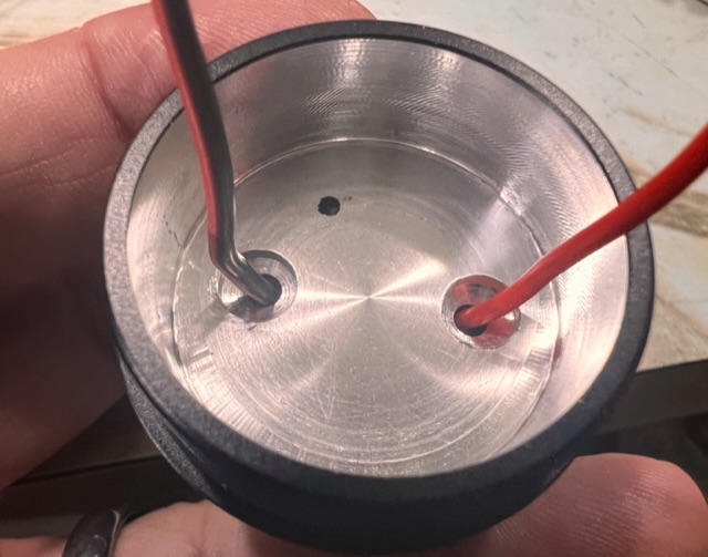

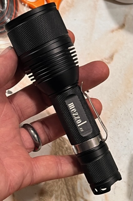

Built the first Mezzol X6 this morning.
Made a copper adapter ring, re-flowed the LD4 into the ring then put a beryllium copper spring and 20 ga leads on it. Machined the X6 head to accept the 35mm Noctigon triple MCPCB, used the center XPG pad to mount a sliced 90 CRI 5000K LH351D.
Set up the driver at 4Amps, 4 modes + middle level moon mode. “Turbo” is a 1000 lumens Constant Current.
Works nice, looks good.
Will have to check run time, need to dig out a high capacity 18650 and charge it up.

The nice thing about the LD4 driver is that it maintains Constant Current on all levels OR up to Turbo if you engage Direct Drive. In DD Turbo is essentially a full FET direct drive output. So it makes it easy to manage cell life. Adjustable on the fly.
So with it set to CC, 4A, it’s doing 1000 lumens. I’ll check what 6A does and switch to DD to check Turbo there. Nice options.
I don’t have any fancy charts or graphs, sorry.
On an old Panasonic NCR18650BD the X6 starts at 1004 lumens, over 10 minutes it drops to 955 lumens and the BD cell was discharged to 3.84V. Flashlight temperature at the finned head measured 133.9°F.
Dropped 49 lumens over a 10 minute run, on the light box surrounded by foam.
LD4 driver set on Constant Current, 4A.
