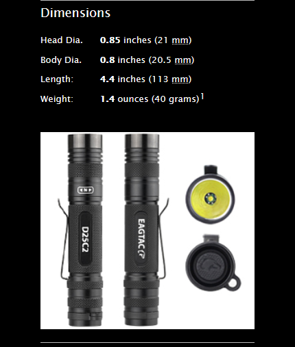

if the body tube is 20.5mm thickness, that’s usually the outermost portion. in the image, there seem to be portions that dip in at LEAST 0.5mm radius, so AT LEAST 1mm diameter, leaving you with 19.5mm Outer Diameter to bore. Playing it safe, take another 0.5mm, giving 19mm.
taken from that same spec sheet:
Inner Diameter UP to 17mm, but you want an 18650 cell in there, likely 18mm +0.3mm to 0.6mm for wrapping, branding, stickers, etc.
From the apparent deepest outside part of the body (the Oring grooves are probably deeper than that) to the expected bored ID, that’s 19.5mm minus 18.6mm. That would leave you with 0.9mm DIAMETER on a good day, or roughly 0.4mm diameter on a bad day. Your oring grooves probably wouldn’t exist anymore, as @gravelmonkey cautions.
**that means 0.45mm walls, or 0.2mm walls. If you estimate or measure other numbers, definitely correct me if my estimates are off.

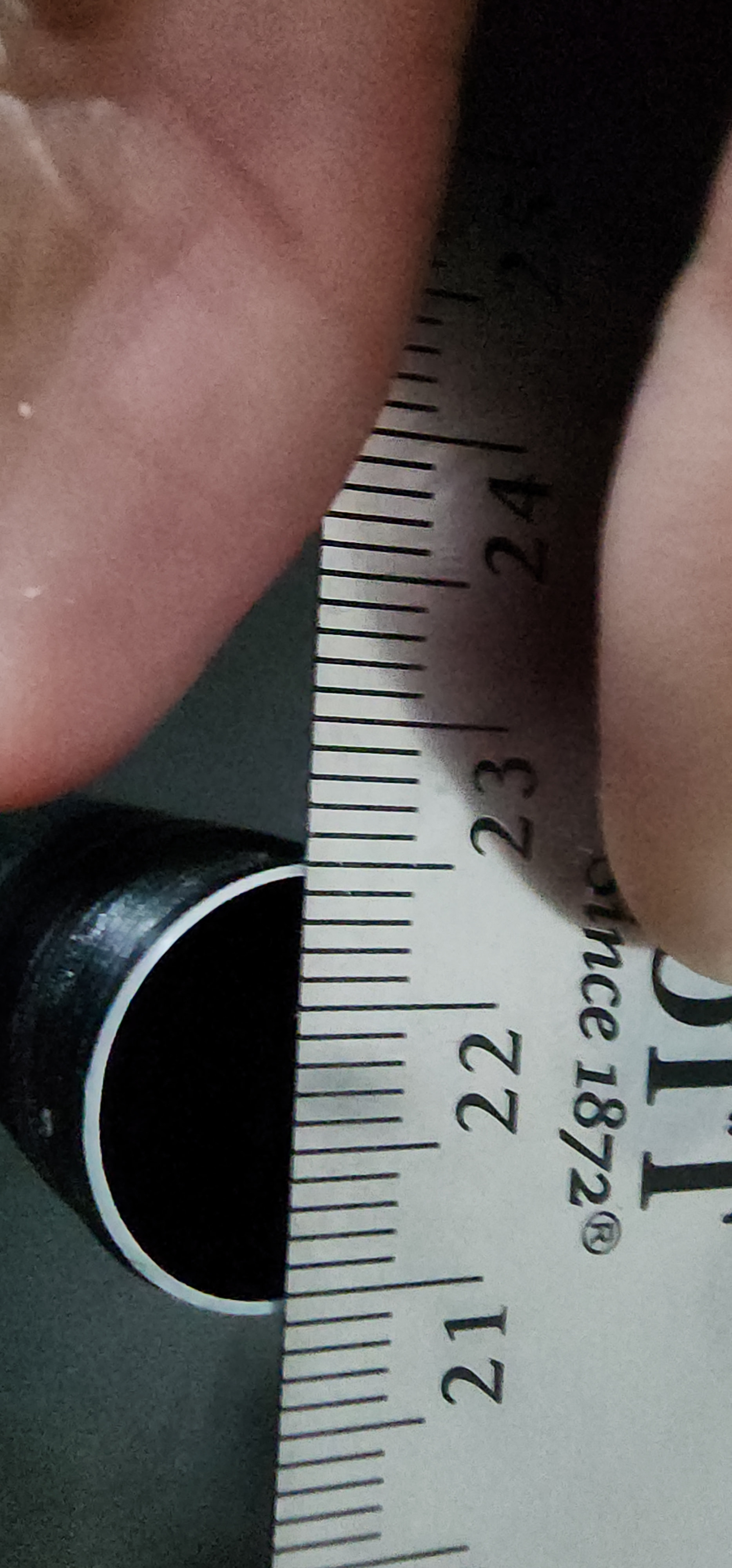

How thin were the walls at the o ring groove?
Its going to be a tight fit if I want to make it work. Doing measurements with my digital calipers ill have about 0.6. I have a d25c I would also like to bore out that has a bit more to work with no dips in the tube to fit an 18350.
