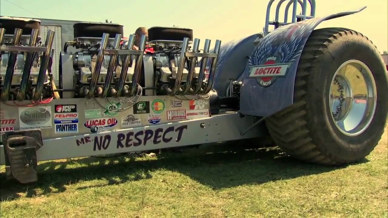

Check this video starting from 2:31 onward. So they put Loctite all over the screws, bolts and nuts on this “Mr. No Respect” horsepower monster. I guess that loosening of just a screw might lead to dreadful consequence.
http://youtu.be/99DRJDUezZs?t=2m31s
