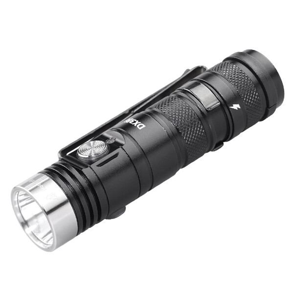

Will a usb c connector work for this Eagtac DX3B flashlight?
Will replacing this micro usb connector and soldering a usb c connector work out for charging this Eagtac DX3B flashlight?
Sure, it just needs power. You’ll have to find something with the same footprint and include some resistors for sink identification.
Can you tell me what the added resistors would be for?
https://community.infineon.com/t5/Knowledge-Base-Articles/USB-Type-C-connector-Rp-Rd-and-Ra-termination-resistors/ta-p/253544
How are your soldering skills?
For quick and dirty solution, I use cheap USB-C to Micro adapters from AliExpress for the gadgets I’ve got that use μUSB…
Edit, whoops, replied to wrong person, meant to direct that at OP.
Ive got good soldering skills and i would like to upgrade the micro usb to ubs-c if its possible.
