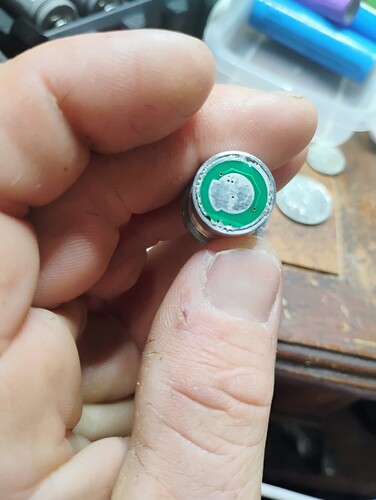

Okay y’all want to know the best upgrade .. that I can put in.. I don’t like what came in it.. I think I can do better with yalls help please
If you’re looking to upgrade the LED, you’ll need to remove the bezel, lens and the white plastic so we can see what you’re working with.
Okay let me get to it I’ll get back with y’all thank you very much

Difficult to be completely certain, but the LED that is currently in it, looks a lot like an Osram PUSRA1.PM, which is often also called the Osram ‘P8’ LED.

LED looks kind of like Osram P8/ P9 (3737 size). You can measure the size of the LED to check.
If you want more compatibility, you can get a 3535 LED board of the same size to replace this one. Something like an SFT-12 may be a good choice for small zoom light.
Is the opening 16mm?
If so and you want a narrow beam the SFT12 might be a good option as ControlTheController mentioned:
