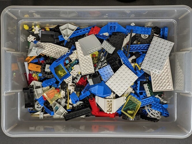

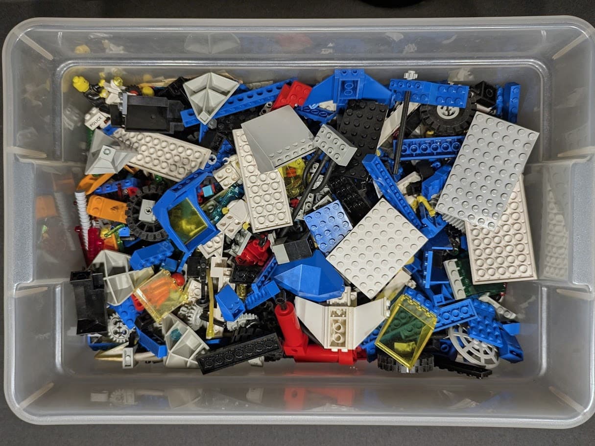

We all talk about Legoing lights together. Well, I’m going to attempt to build a light from Lego’s. This box is the Lego’s I’ve had since I was a kid. Obviously, some stuff in here can’t be used. However, I’m going to attempt to build the body of a light from this box. I may have to go buy more.

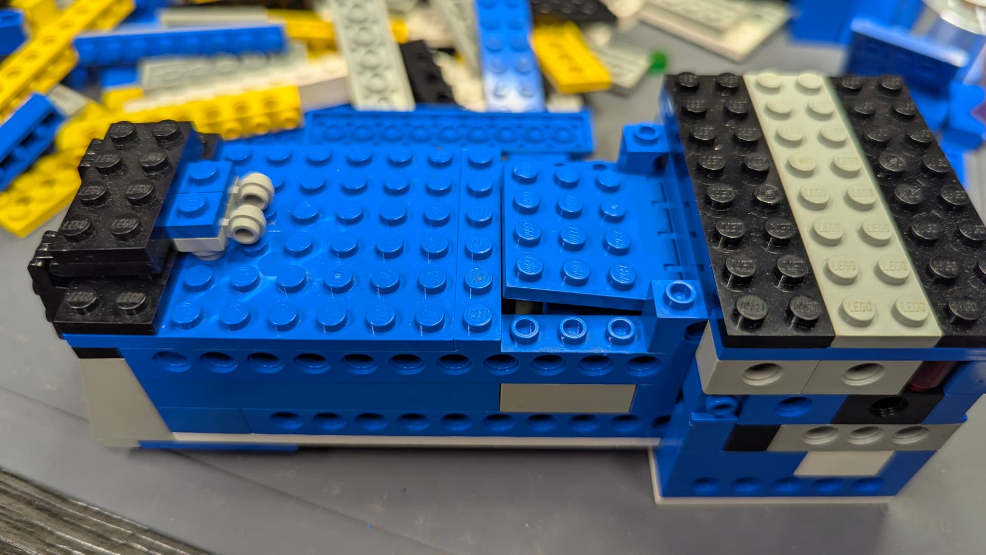

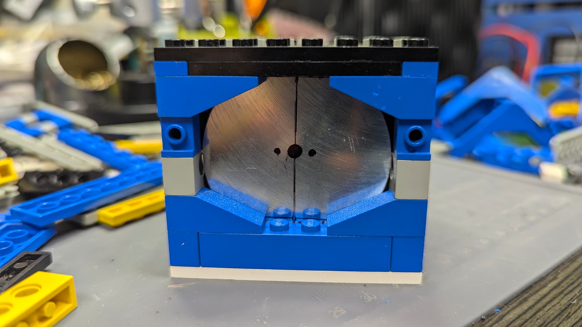

Had a lot of free time today since it was too cold outside to do anything. I think I got most of the body built… Maybe! I’m still working out ideas for a lens. But, I have an idea for that.
I’ve been trying to get as many holes around the pill as possible for airflow in hopes it doesn’t melt itself.

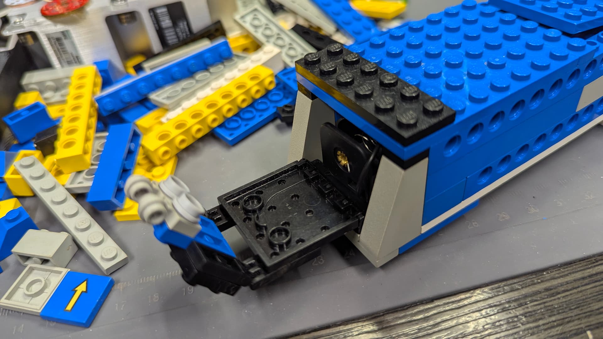

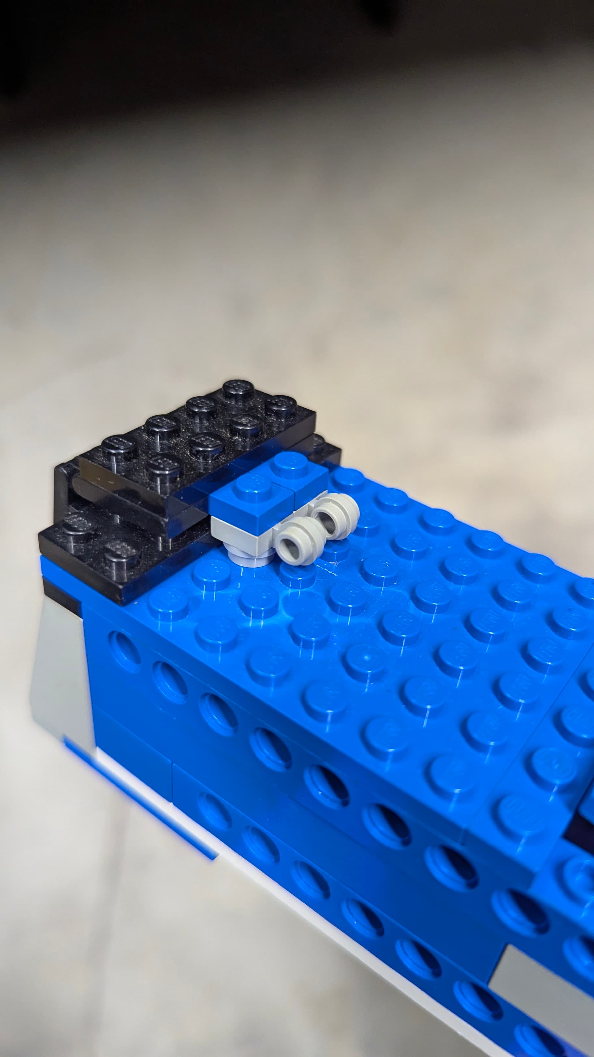

I created a handle for the flip down lid to the battery tray.

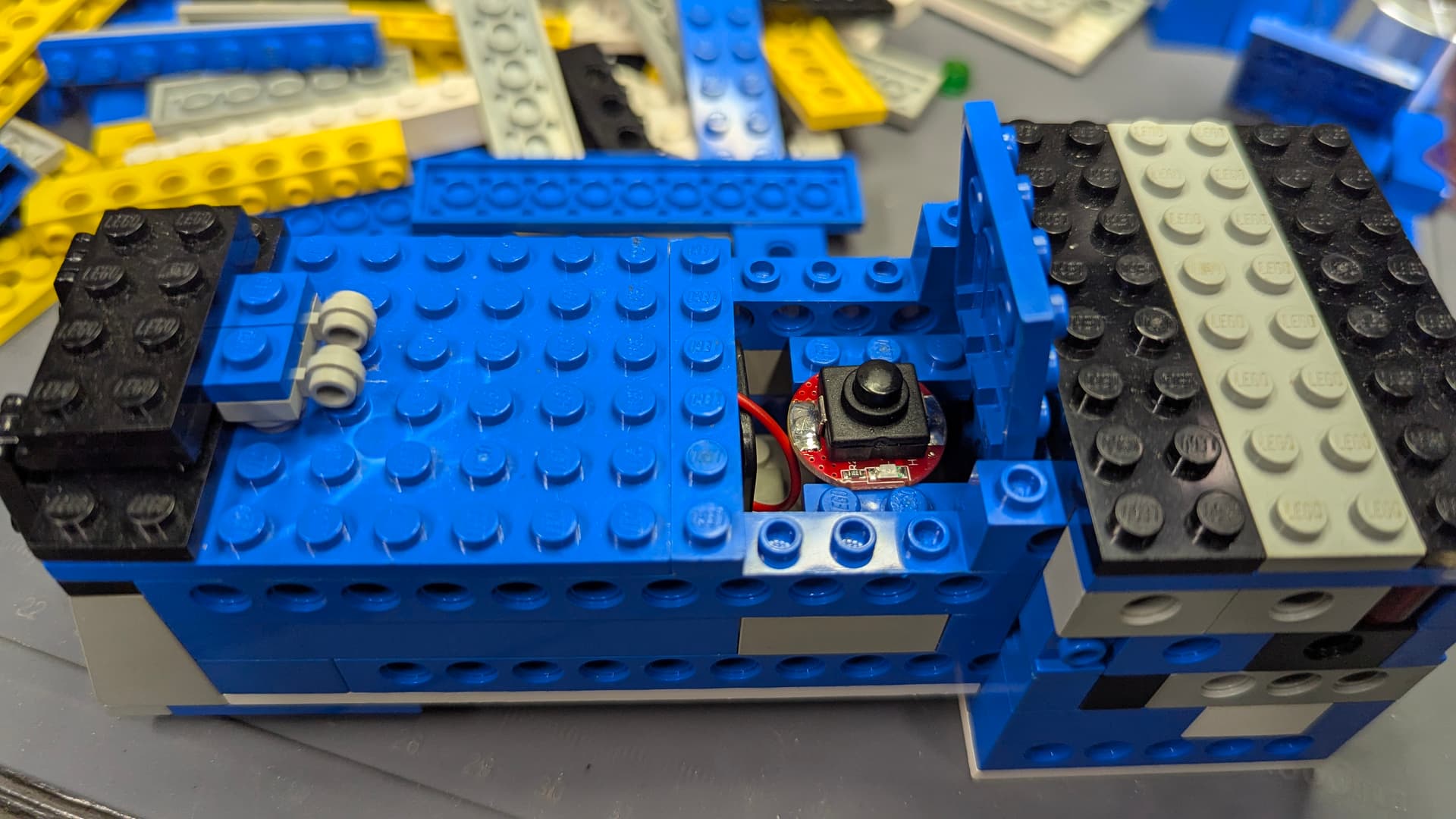

The tray itself
The switch
It’s just a hinged lid on top of an actual button that has had the spring removed. The battery tray wires will get soldered directly to the bottom of the button (+ directly to the driver, - to the button). And the button will get glued in place once this is all ready for final assembly.

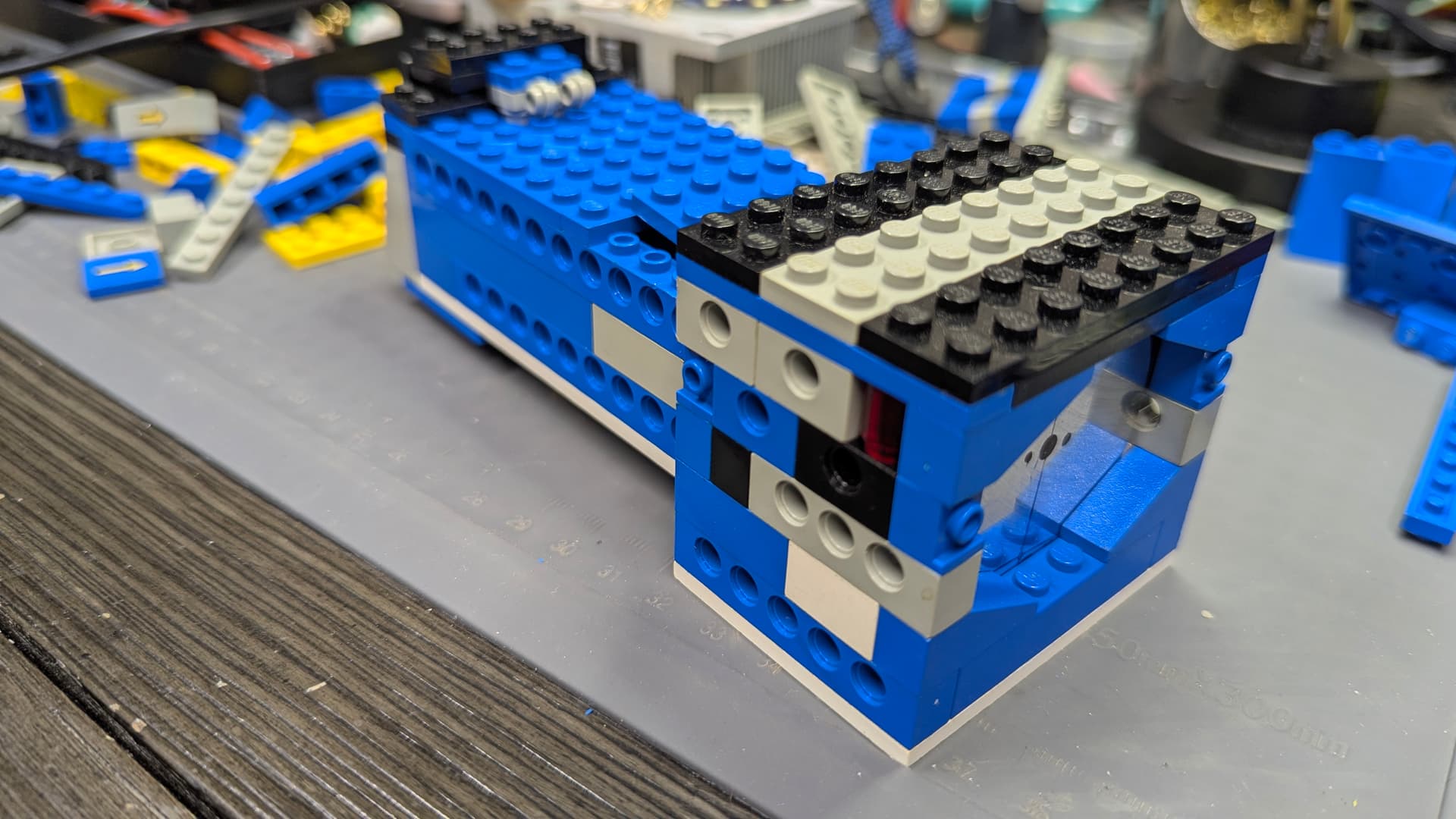

And what I have so far of the business end.
An Emisar 4x mcpcb will be screwed to the front with a hole going through the pill to the driver that will be attached to the back of the pill.

Will you be utilizing the lighted switch somehow?
That’s the plan, so far. It’ll have a nice glow coming out around that panel. That button with that panel also gives a very satisfying click

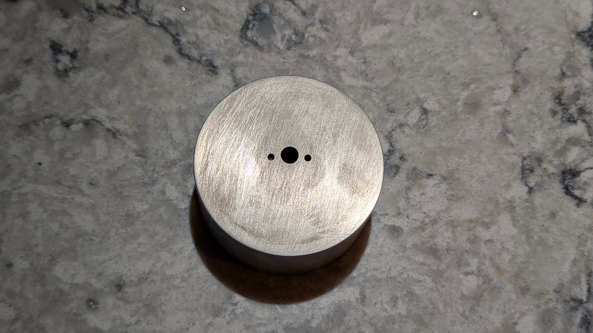

Borrowed a drill press from my neighbor and got the holes I needed drilled into the aluminum puck.
