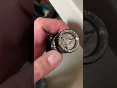

Just got mine today. Boy does it suck. I don’t think mine is working properly. From the hard off detent, you get about 60% of the ring travel with no light, then when it does come out it flickers horribly. I do not remember the original RRT01 being like this. I take mine has a problem? Also sorry about portrait mode… this video was quick and dirty.
Wow, that needs to be returned. My old RRT-01 has a solid “off ”detent, then just a tiny bit of travel before the almost imperceptible low output begins. Very smooth.
BTW, I’ve really been enjoying your YT reviews.
… what do you want for $80 :wink:
Ok that’s what I thought. I sent HK Equipment on eBay a message with a link to the video. Let’s see what they have to say. Thanks man! I hope I get around to reviewing this one!
I’m a simple bro… a working light. Also I paid $70
Hum, those detents are really “marked” while rotating, aren’t they? Nothing like the old model that goes smoothly :zipper_mouth_face:
I hope the vendor makes it right for you. It is such a super simple operation. No double clicks, long clicks, etc. to memorize. I don’t think I want to go back to a ” morse code” multi-level light. Looking forward to your thoughts on a properly operating RRT-01.
Reminds me of my Sunwayman V10R after I accidentally put in the battery the wrong way once. Even though that lasted for just a second before I noticed, it never worked right again.
Result: For the first 60–70 or so of the ring’s travel the light would be in moonlight mode, starting very low and gradually getting brighter. Then over a tiny distance, maybe 1-2mm of turn the light would rapidly ramp from around 1% output to 100%. The transition was so quick that it looked like it simply jumped from moon to max, but if you took a lot of care to turn the ring extremely slowly at the transition point you could see that it actually did ramp up and wasn’t instant.
Yeah, mine doesn’t do any of that nonsense. It should definitely go back for a replacement.
Mine starts so low you can’t see it till you get right up on the lens, and it just gradually increases to max output, which you don’t have to go into the max detent to achieve.
Mine too, definitely send it back. Something is not right with the driver.
