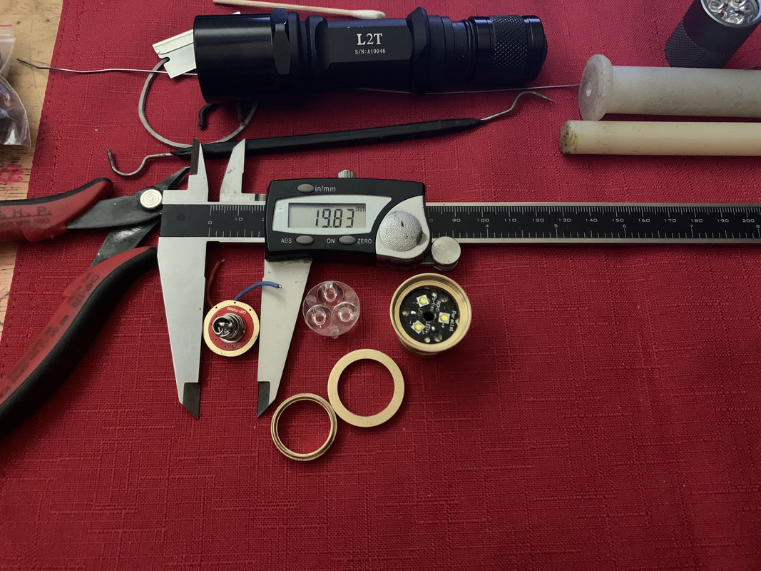

Right now, you can get KD’s triple XP-L Hi with the E6 host for 6 bux more! Good deal and if you go with 4000k, they are using 5A3 tint bin. One of the best XP-L Hi tint bins, IMHO.
Triple XP-L Hi with E6 host.
My orders from KD have been shipping and landing pretty quickly as well. I forgot to mention, their new P60 brass module design in singles, triples and quads is really nice. Have bought several just to cannibalize them.
FYI- the UI description from KD does not match what I received. My triple has 4 light modes and double click goes to blinkie. There is no turbo.
I also have the KD quad drop-in and it is different. It has 4 modes, double click goes to high (there is no turbo) and triple click goes to blinkies.
This is what is shown on Kaidomain.com-
Very Lo (1) > Lo (5) > Med (30) > Hi (100)
Double Pressed: Turbo
Triple Pressed: Strobe (8Hz)
(with memory mode function)
mattlward
(mattlward)
5
That will not matter to me a whole lot… If I don’t like the driver… it will get a 17mmDDm or a 17HF. The shells are the nuts for P60 users!
The KD triples use a 20mm driver…
mattlward
(mattlward)
7
Interesting… I have some of the new style early production singles that use 17mm drivers, have replaced a couple.
Yeah well triples are 20mm (just under)
