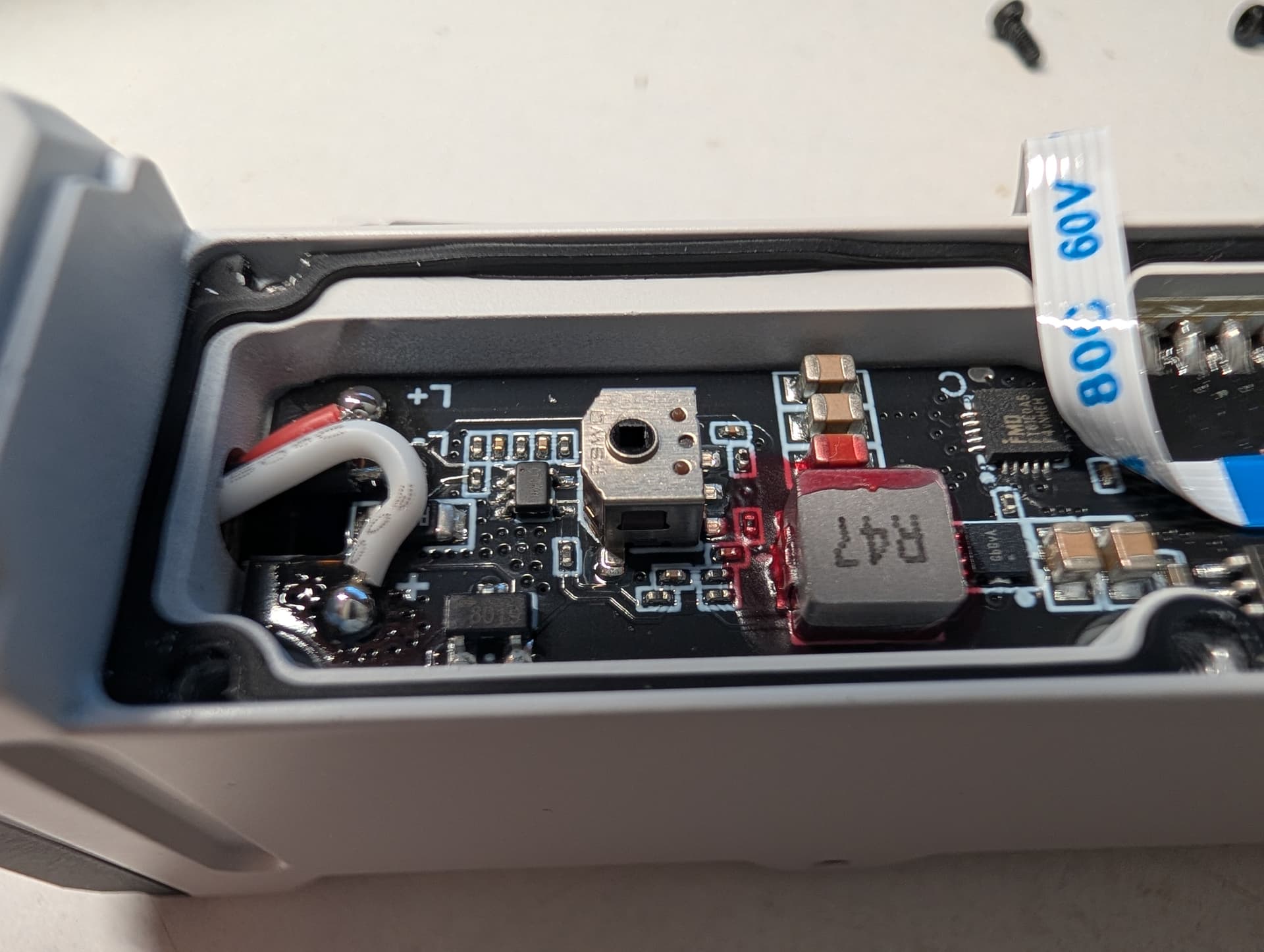

And now for the sad part for modders: It uses 2016 LEDs. So changing them to High CRI or different tints is not easy.
They use a healthy amount of thermal paste
And the MCPCB is quite thick. Nice!
If someone want’s to modify or repair the driver at some point: Good luck!

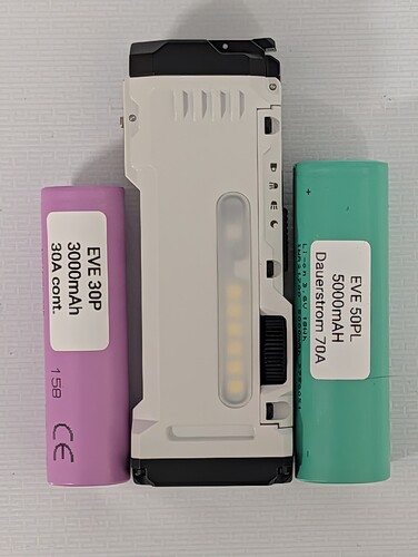

Little comparison to a selection of other 18650 lights:
Convoy S3, Sofirn SC31pro, Wurkkos TS10max, Wuben X4, Yemao A200
This light is smaller than I tought it will be, but it’s a very nice size!

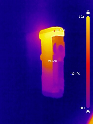

So then I whipped out the thermal cam:
After 1 Minute on Max.
After 2 Minute on Max.
After 10 Minutes on Max.
The whole body heats up, but it’s very clear that the light has some regulation to keep it below 40°C case temperature
