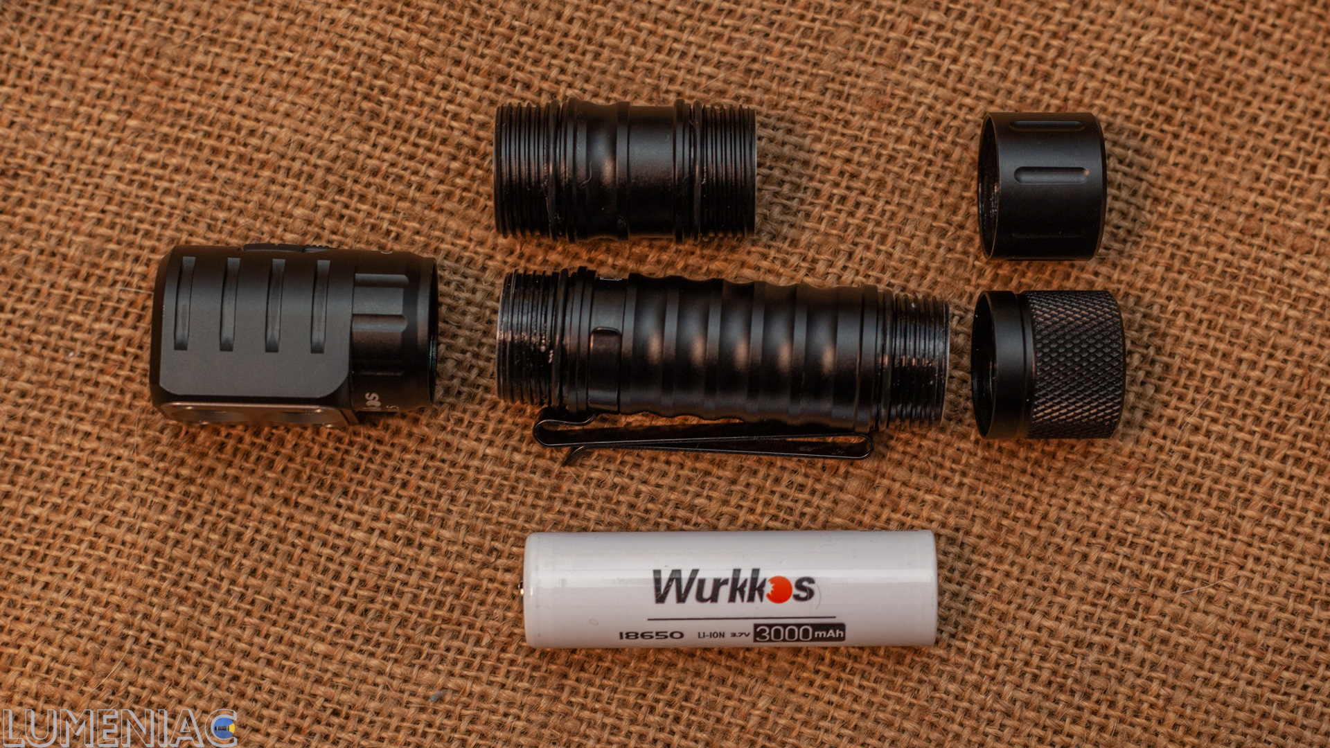

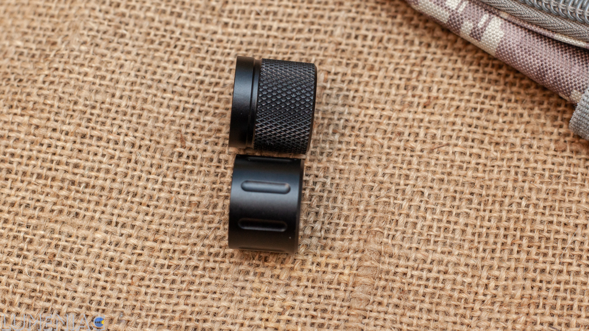

There is everything you may need in kit, including a short tube for those few who prefer 18350 batteries. There is also a replaceable non-manget tailcap. Good for carrying bank cards and flashlight in one pocket.
Interesting fact. Tailcap with a magnet is the same as that of Sofirn SP40, but non-magnet tailcap is designed in the style of Wurkkos HD20.

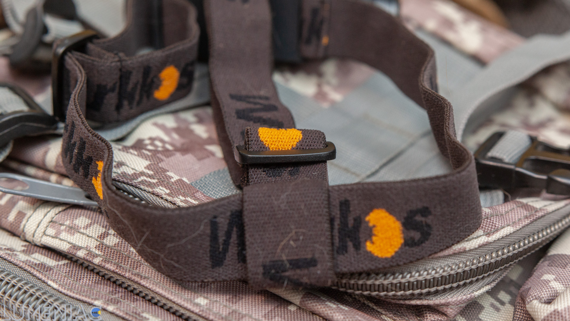

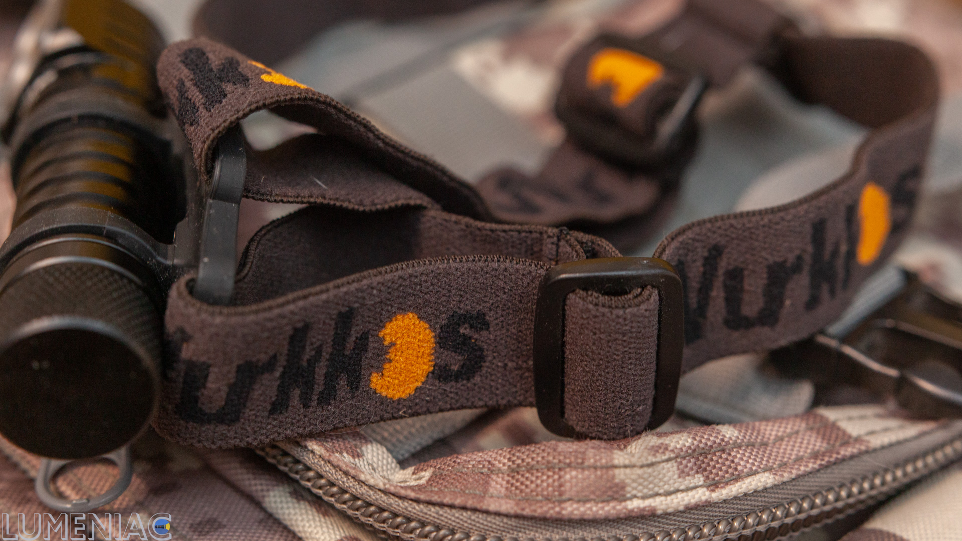

The headstrap is the same. Quite soft fabric, no bad, but really, really, budget. It would be cool if Sofirn start selling separate higher quality headstraps.

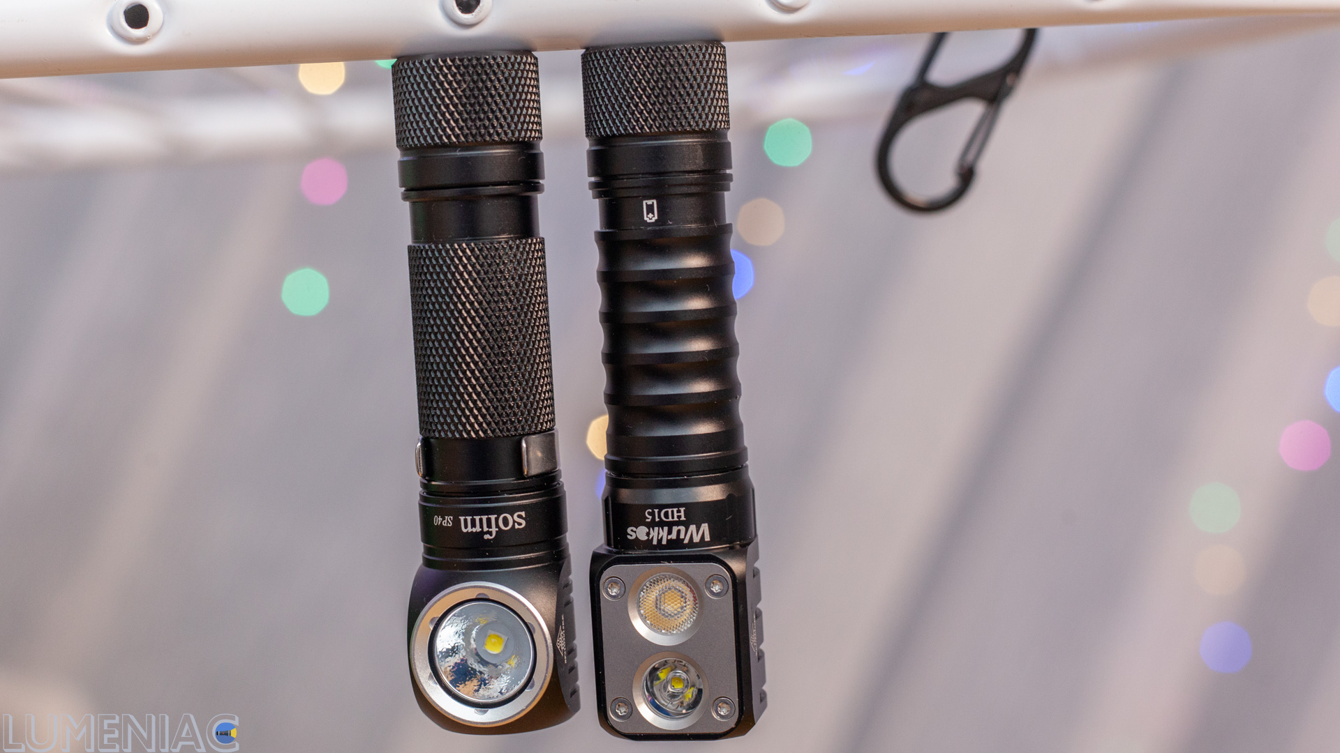

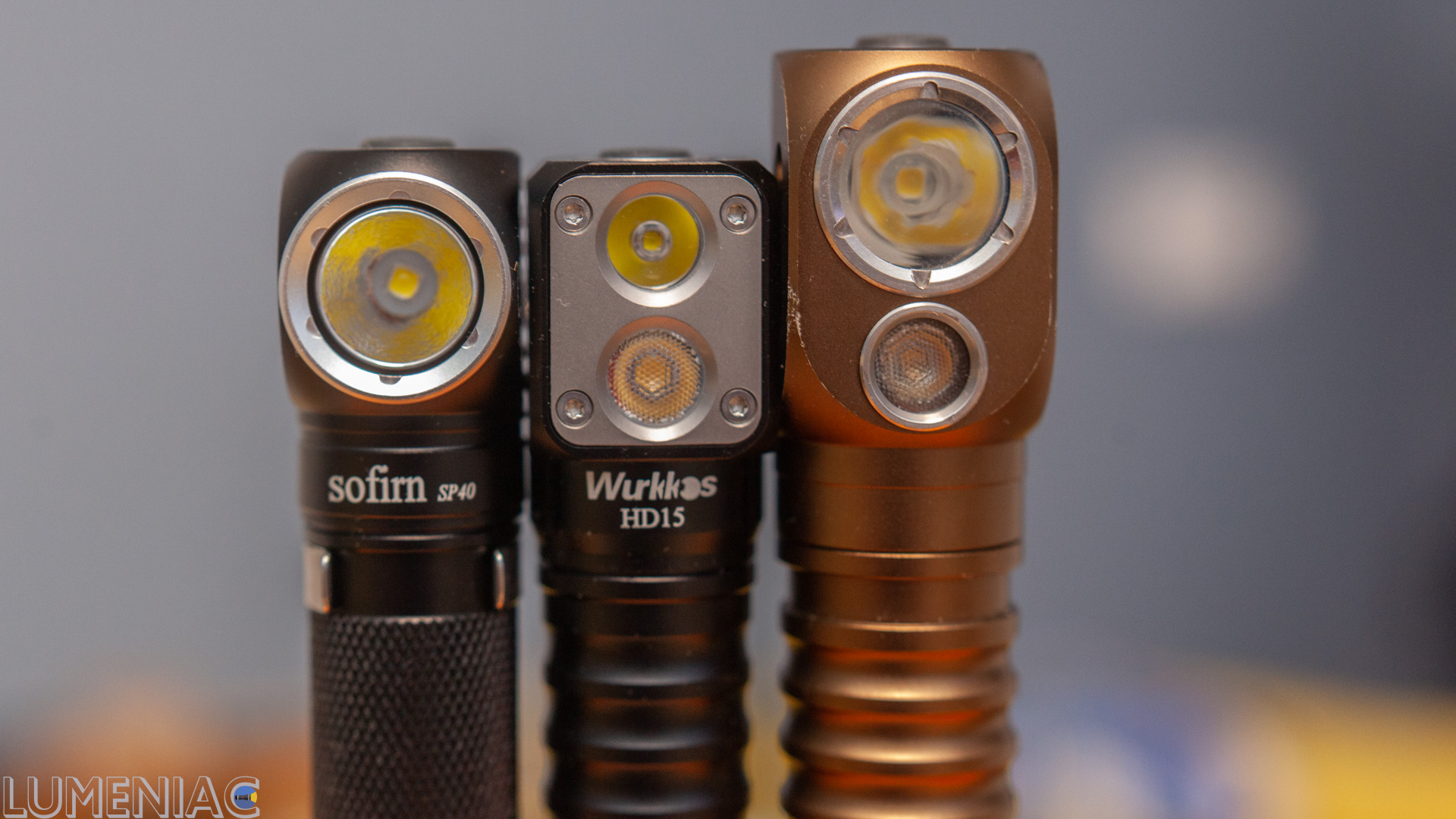

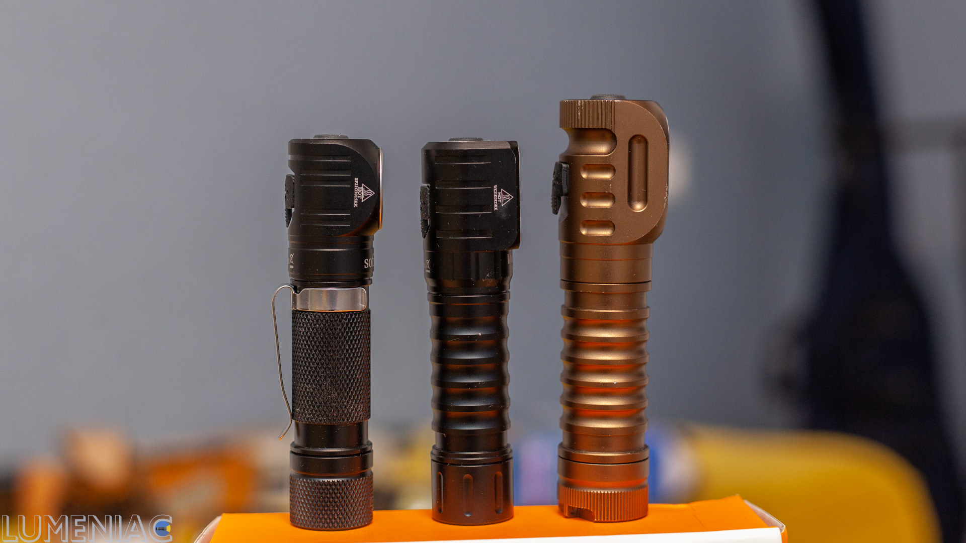

Sofirn and Wurkkos are technically separate brands, but they have the very same origin. So it is appropriate to show a family photo that will illustrate the design and size. The usual 11cm length of the Wurkkos HD15 is reduced by a third with the 18350 tube.
I definitely like new design. If only the anodizing was matte, and the headstrap was not so budget, then Wurkkos HD15 would look no worse than models from much more expensive brands.

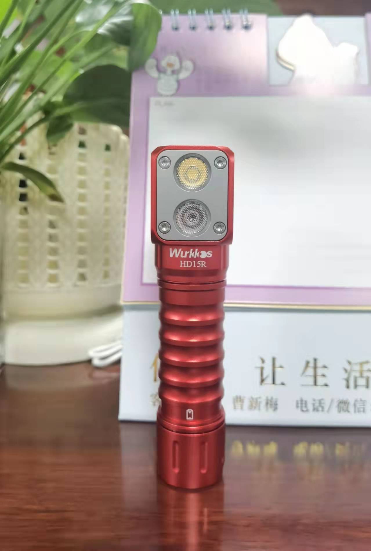

btw, there is coloured models now.

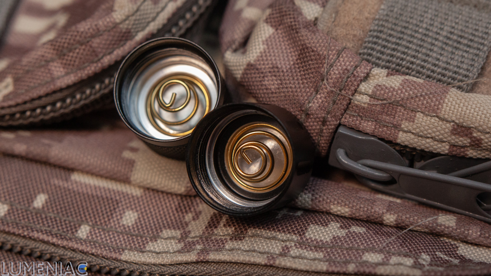

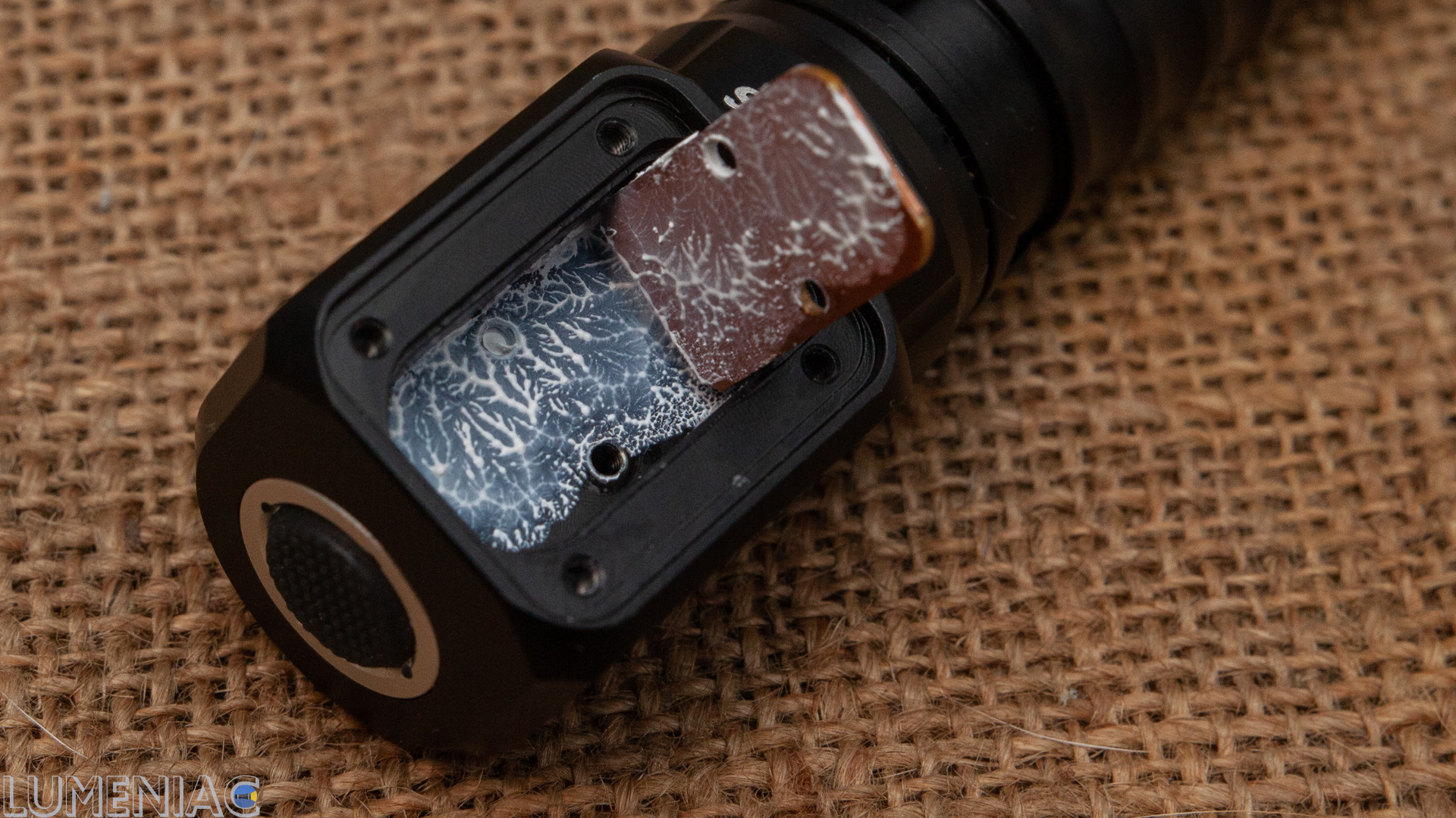

I mentioned the magnet in the tailcap. This one is strong.

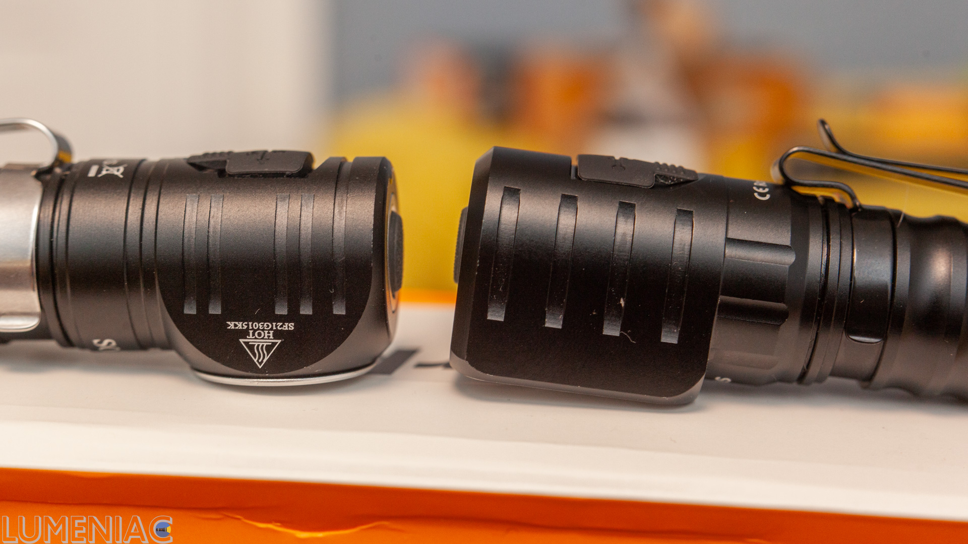

The headlamp body here is similar to the HD20, so the grip here is extremely reliable.

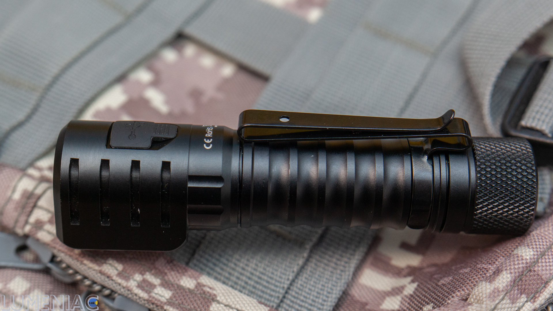

The flashlight is divided into three parts. In the regular position, the clip is mounted near the tail cap, which I don’t like
But! Nothing prevents you from turning middle part upside down, so clip will be mounted near head. Contact is good, Wurkkos HD15 works as supposed.

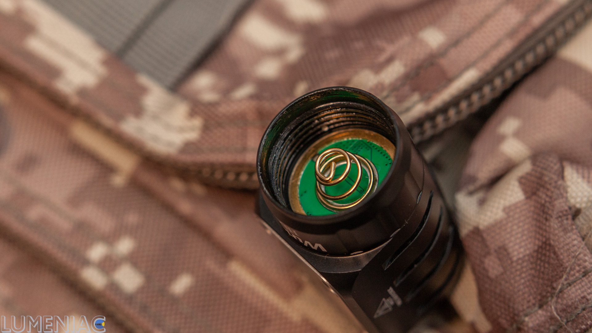

There are two springs, at tail and head.

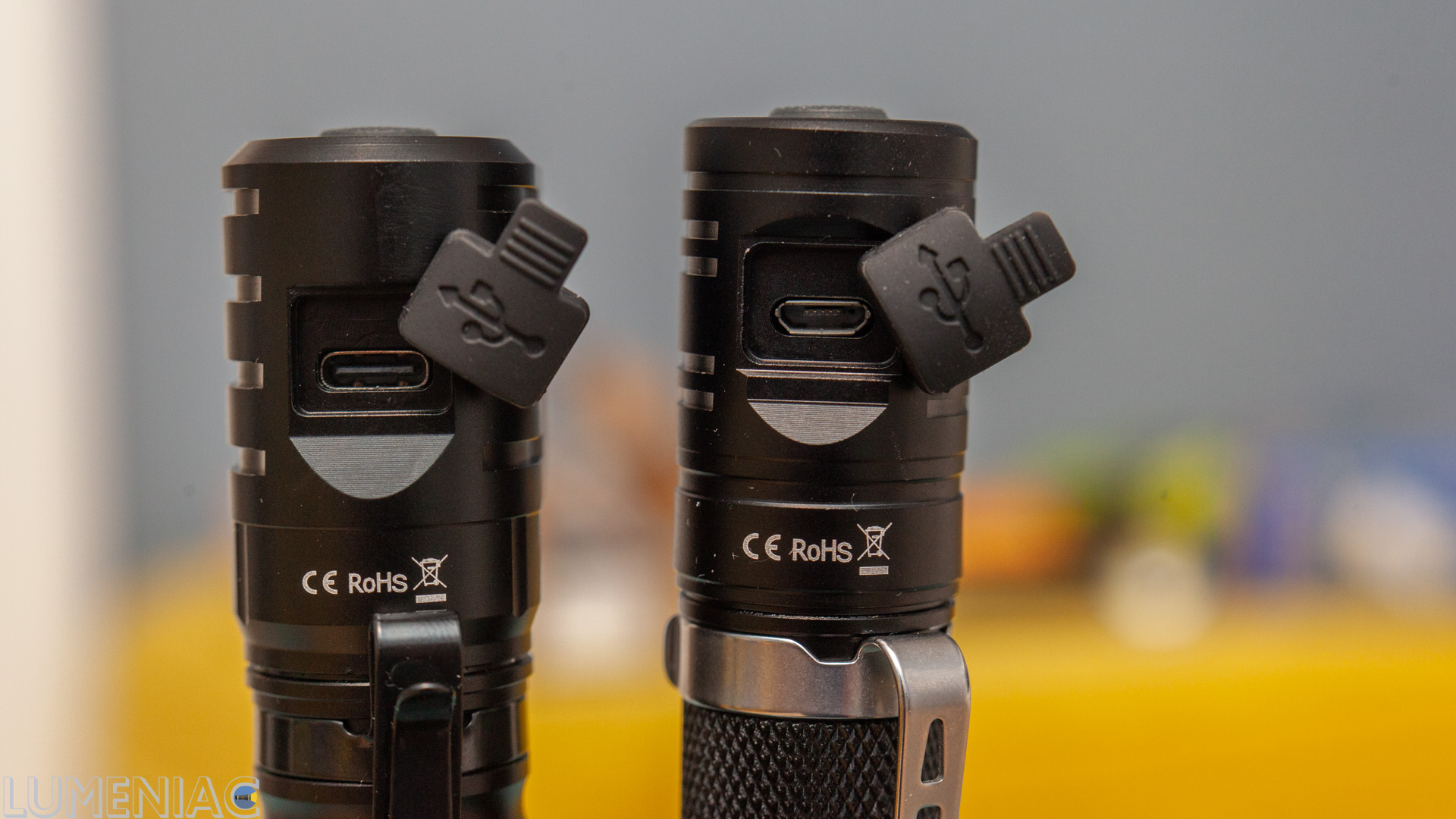

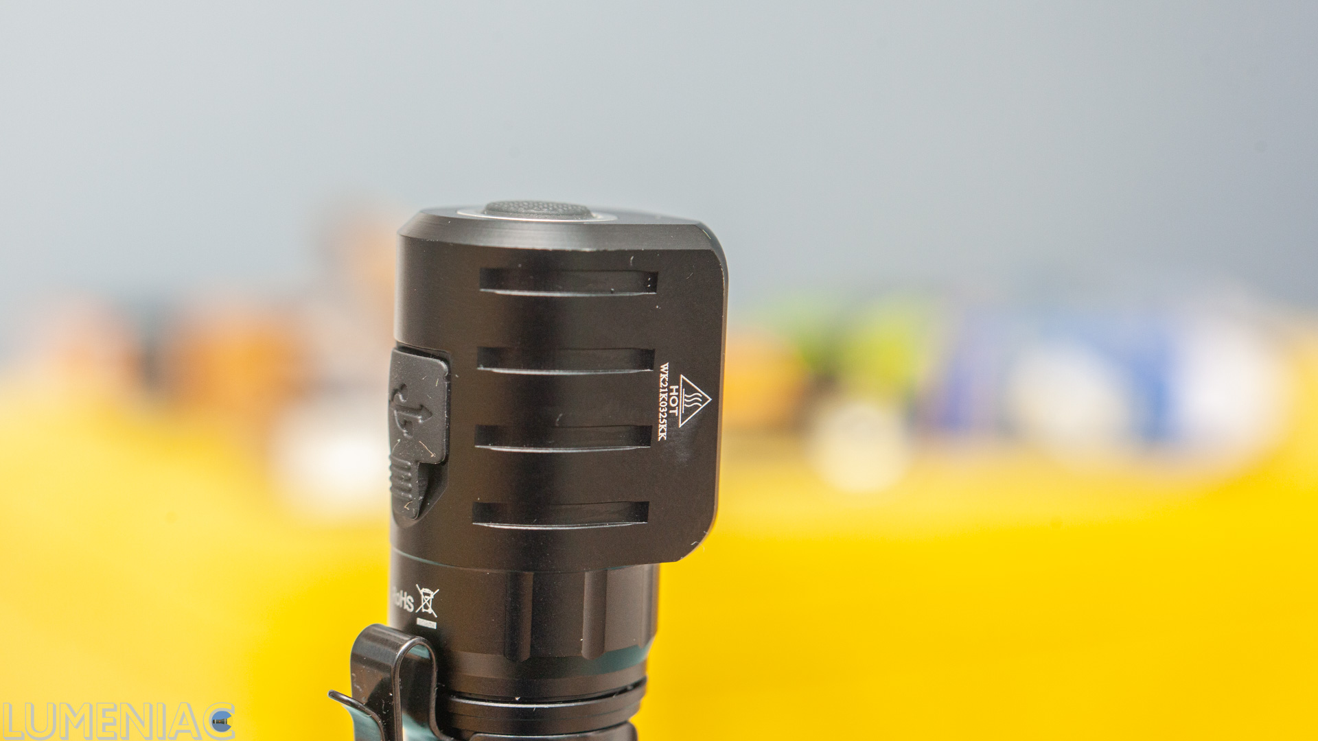

As usually, there is the charging connector at the rear side of head.
If Sofirn SP40 has Micro USB, then Wurkkos HD15 is equipped with reverse Type-C charging port. 2A charge power.
The cover is good and thick. I don’t see any chance of accidentally opening it.
The button is the same as it was, with the same backlight. Pretty handy button

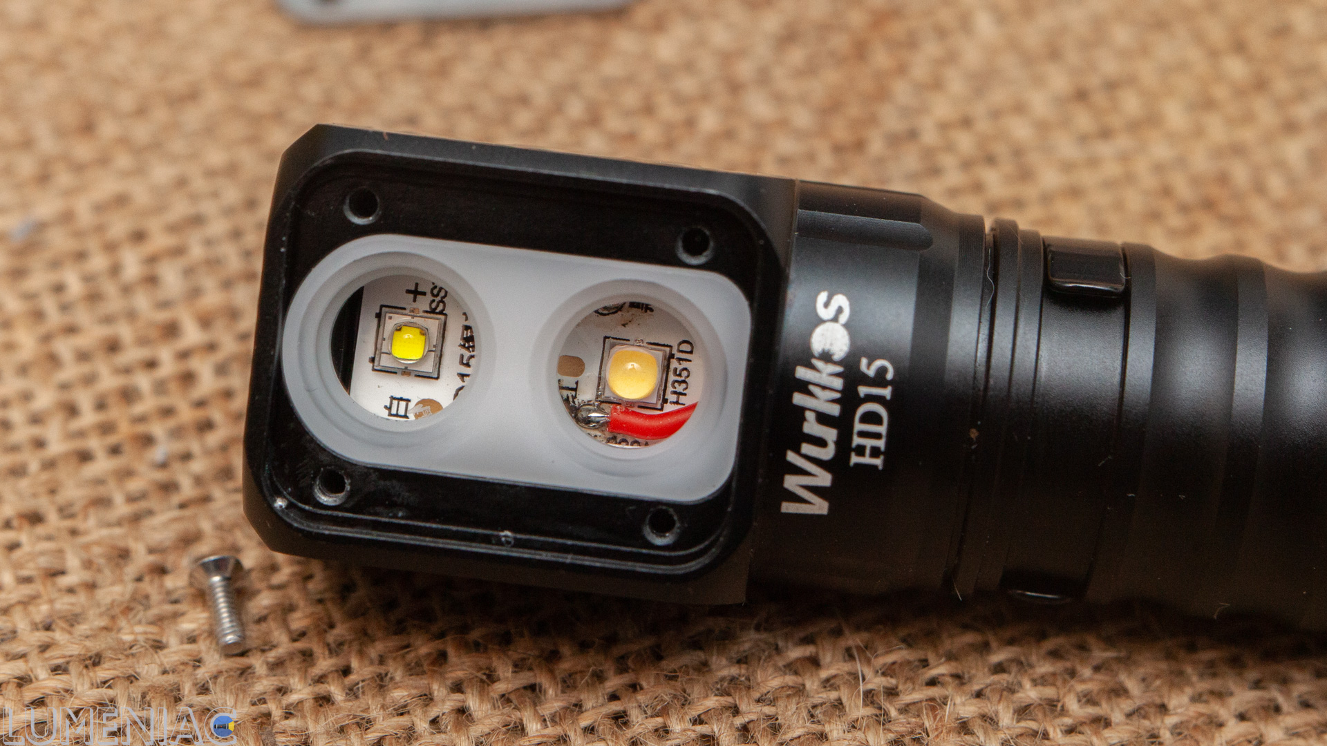

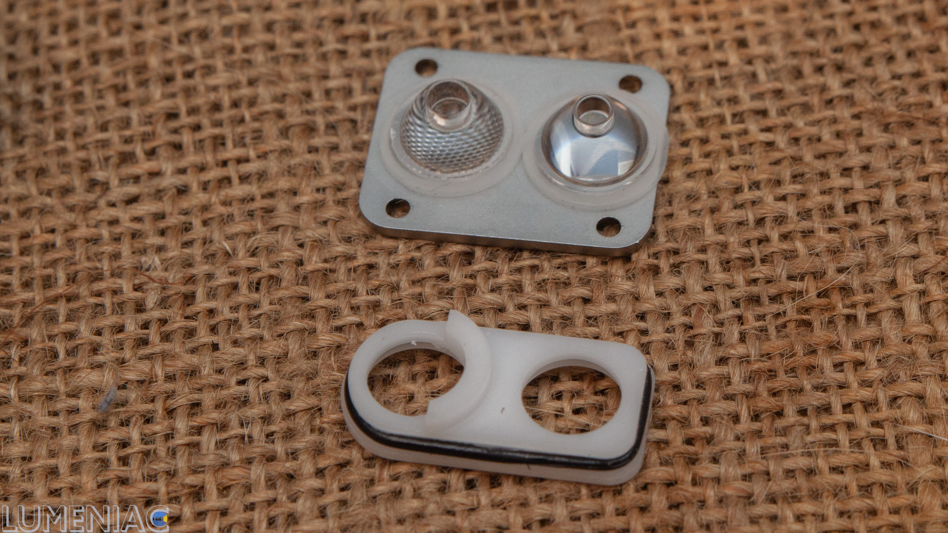

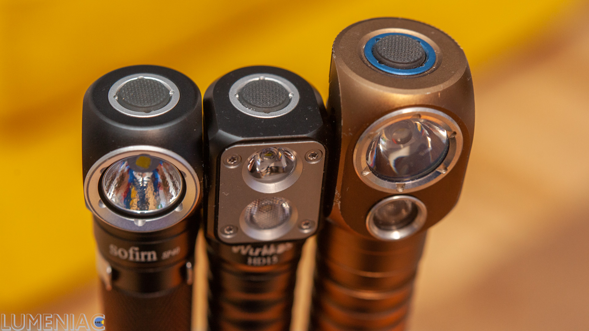

And here is the most important change. For some idiotic reason, being aware that so damn lot of people have asked for SP40A version with floody TIR optic and have had install such lens by themselves, Sofirn didn’t bother to release such version of SP40 and release good, but quite large Wurkkos HD20.
Sofirn SP40 is not bad as is, that is classic headlamp with reflector, definitely convenient for working at a medium distance, with decent throw (as far as this word is applicable to a headlamp). But it is really not that good for close range work.

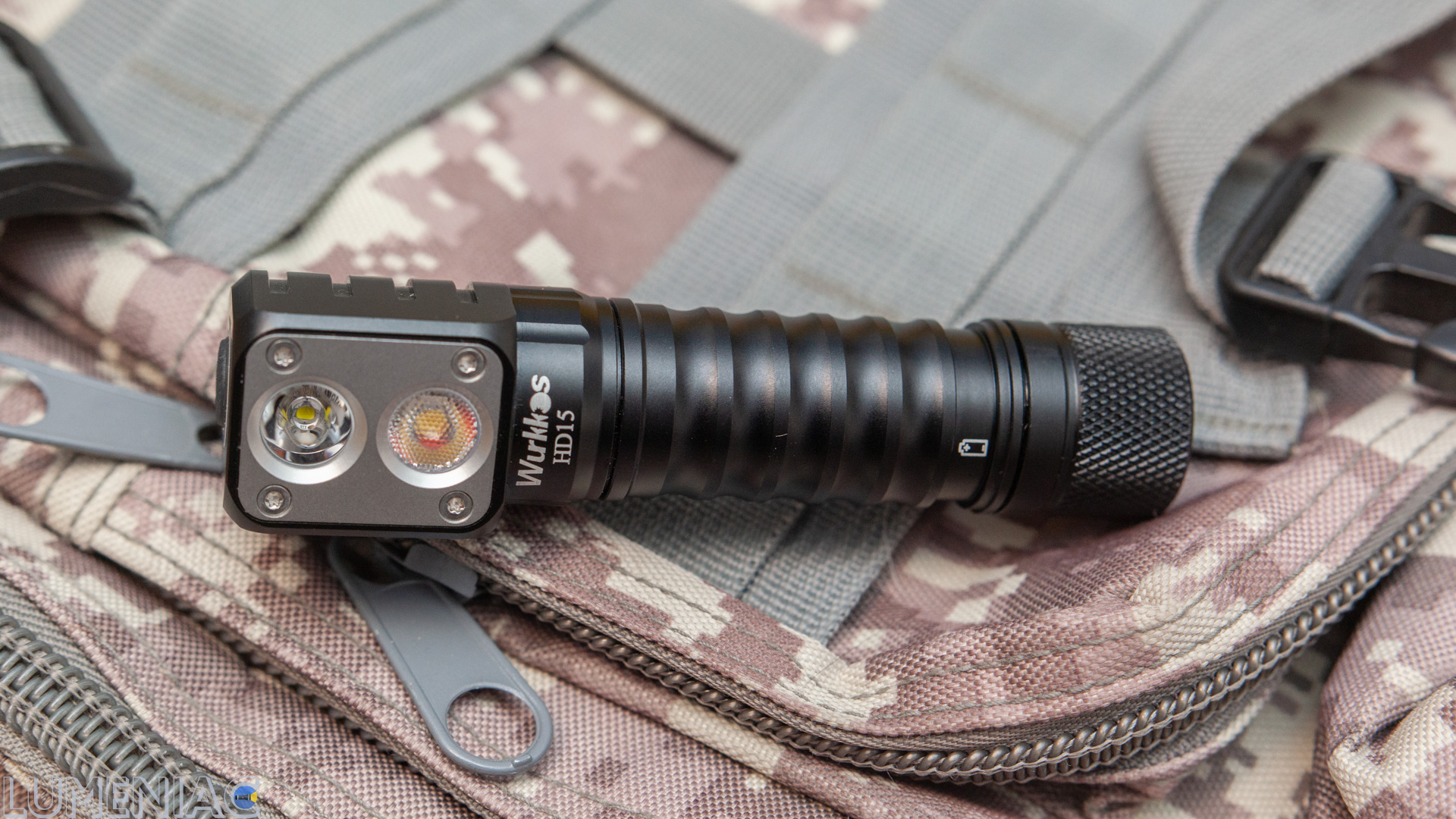

Well, now you have Wurkkos HD15 and this is completely what you need. The same size as SP40, but with both spot (SST20 ) and flood (Samsung LH351D Hi CRI) light.
I think that SFT40 would be better as a LED for Spot light. But increasing throw would result in worse color temperature.
Wurkkos HD15 looks more attractive then Sofirn SP40, but the appearance (and especially the package) still doesn`t allow you to confuse it with handsome models by big and expensive brands.
Design of Wurkkos HD15 is quite at it`s price level.
I did not see any flaws in the quality of manufacture.

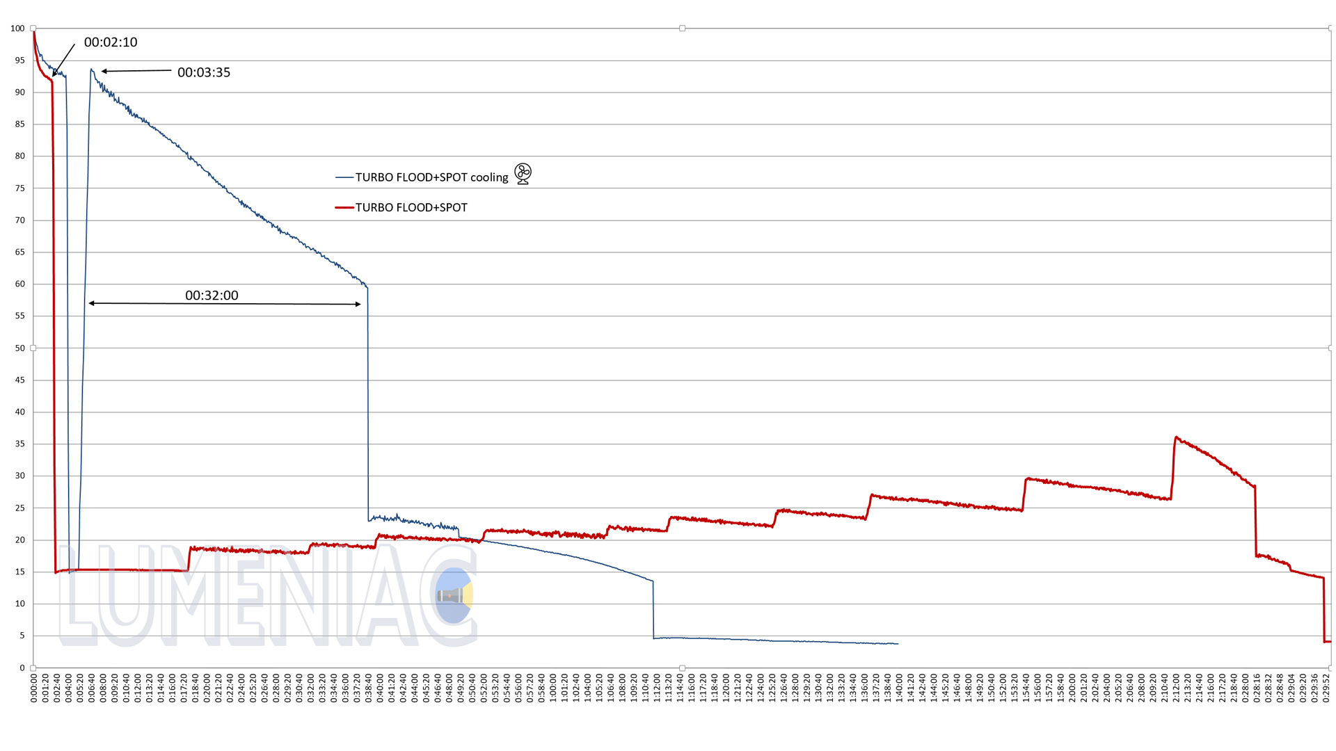

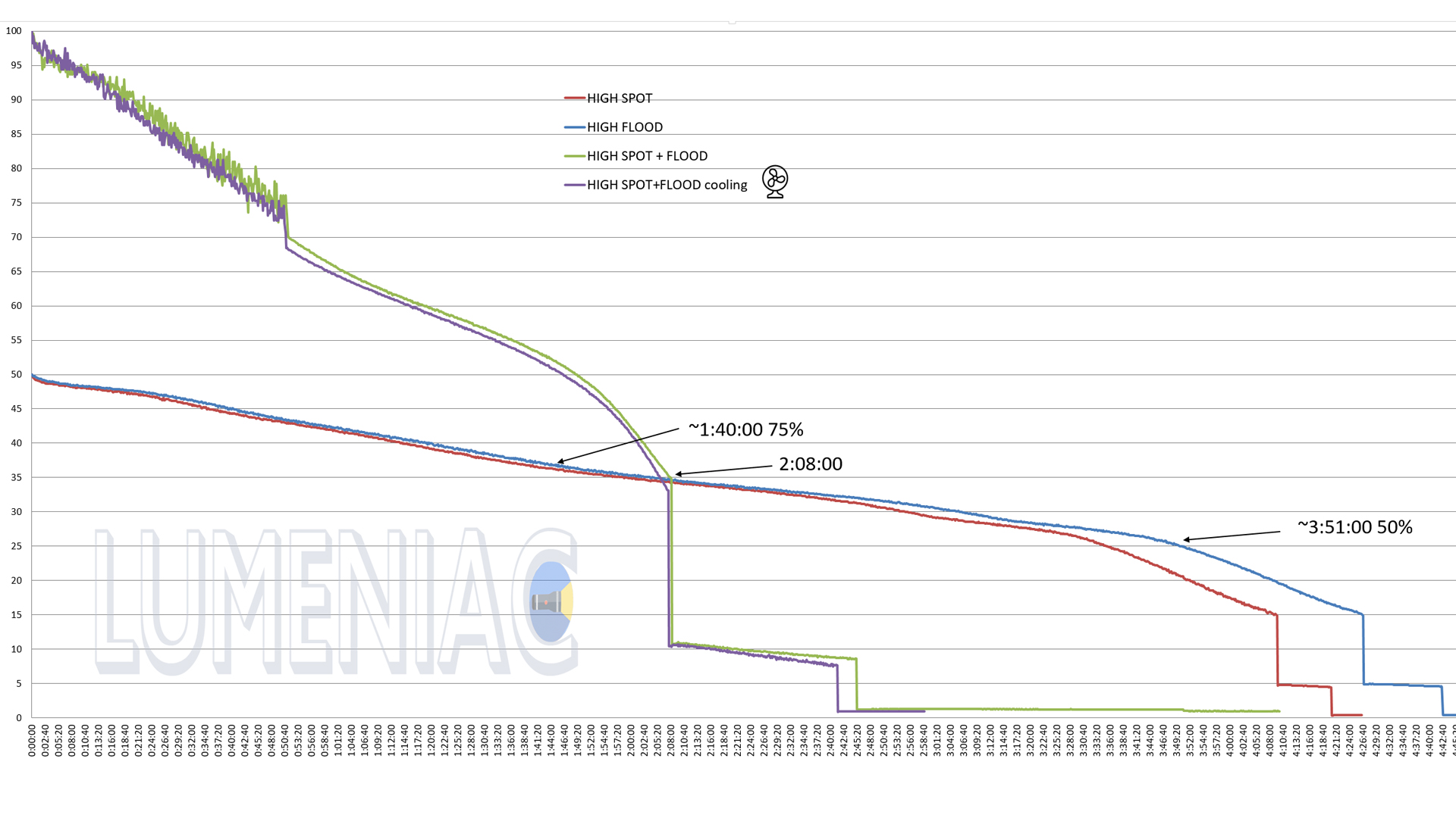

WURKKOS HD15 runtime and illumination

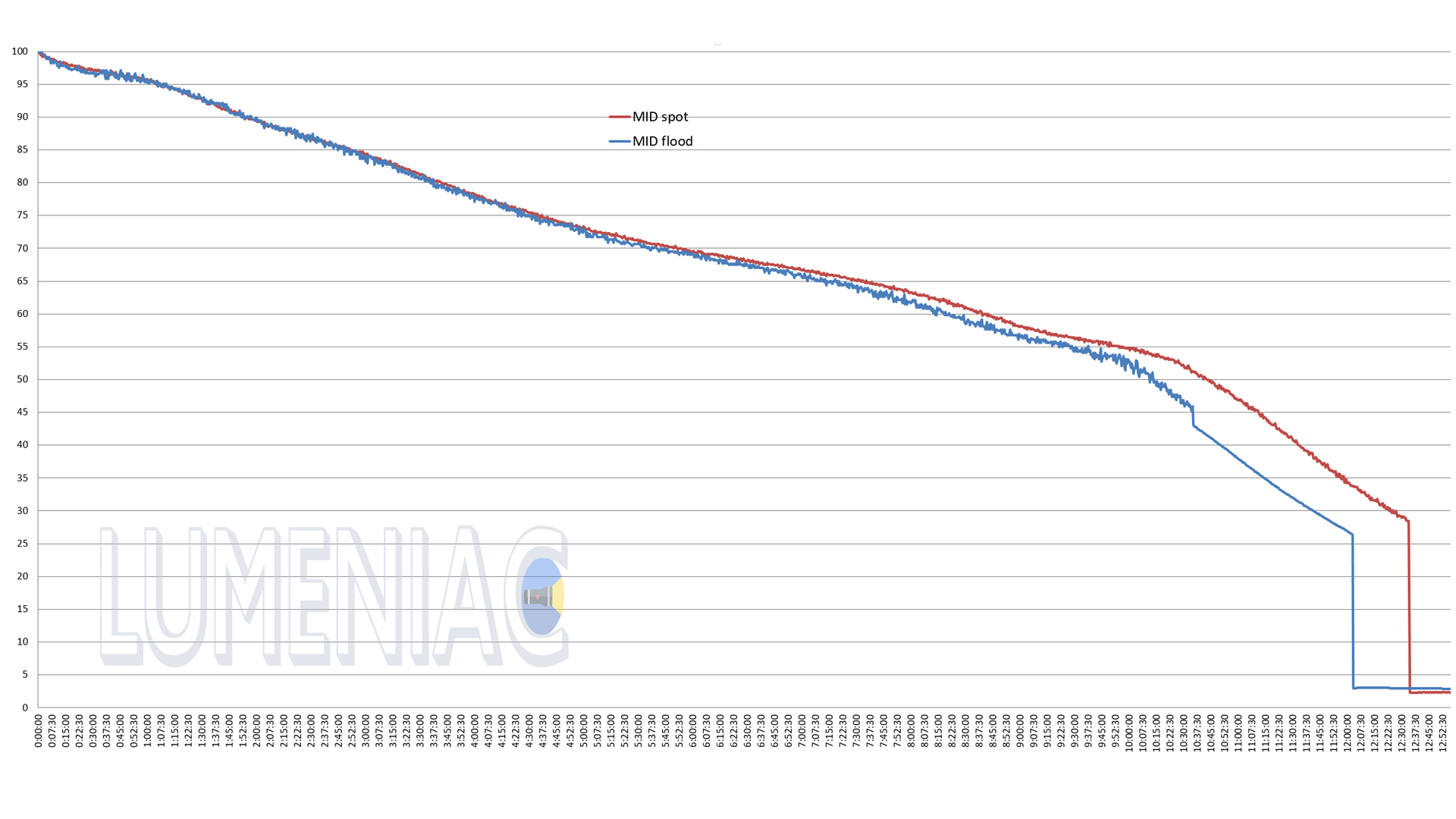

With such a combination of price and functionality, I don’t care at all that the flashlight does not have brightness stabilization.
It perfectly holds the higher modes and the difference in runtime between the LEDs is clearly visible here only in Turbo.
When it comes to flood light, you can safely count on the fact that it will work for an exceptionally long time without a real stepdown , especially when there is some wind cooling.
The eye, of course, perceives everything a little differently, but I’m sure you can catch the main difference. In terms of light versatility, the SP40 loses miserably here.

Interesting, I ordered a HD15 from wurkkos in october, it came with only one tailcap, the one with the few deep grooves.
It has a magnet though and is a bit longer, like on the photo you posted of the red one.
