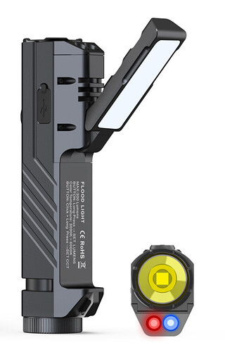

【Wurkkos WK30 PRO】combined with the “wings” series HD05
:joy:I think WK30Pro multi color combined with the wings series now, Model HD05
LUMINUS SFT70 2 6V 6500K *1
LUMINUS SST08-UV 3V UV 365nm *1
CREE XPE 2V 660 red *1
Buck driver and toggle switch, easy to operate, 3100LM 335m Throw, Rotatable 180° Wing Floodlight (3000–6000K)

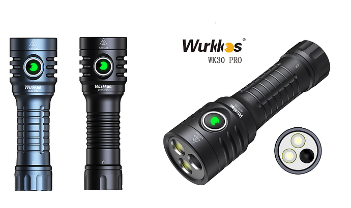

Hi Guys, as the first representative product of WURKKOS, WK30 has been discontinued for a long time. I know many people like it, and we have always had the idea of making an upgraded version,2 years has gone :joy: :sweat_smile:the plan seems ready to start, I recently received the first version of the design draft, and to be honest, a bit disappointed.,, feel like something is missing :cry:
According to the original plan that Terry and I discussed,the upgraded features:
①more compact, from 26650 to 21700
②more powerful, 1LH351D to 2519A(plan flood) or 1*XHP50.3HI(plan spot)
③more friendly, single red LED to triple red LEDs
④more professional, 365nmUV+ ZWB1 filter or 365nmUV+ZWB2 filter.
But as I said above,2 years has gone, :smiling_face_with_tear: I worried my plan outdated. I hope to complete the final design with our community all. What do you think we should do? Just leave your comment.
we need help , Give them some advice on what the WK30 PRO you want looks like~~
10 Thanks

This is a very minor issue, but I’m not fond of the new logo on the button. It resembles a button that’s either scratched or has some paint on it. Perhaps it’s a bit OCD, but I would greatly prefer a simple circle with a backlight, free of any marks.
@Wurkkos , Please make sure that the light can tail stand with a lanyard looped through the side of the tail cap.
and maybe it would also be better if the tailcap was wider
However I like the style of the first torch on the left and would make a higher steel bezel
Please give us a more sturdy look and feel (thicker material, especially for the battery tube), I know this cost a little bit more, but I always prefer look and feel over very low price.
I would like a neutral symbol for the lighted switch. An AR coated glass lens would be great to have.
+1 on AR coated glass. Wurkkos already has some flashlights that can compete with well known and established brands like NiteCore or Fenix etc. - those with stabilized drivers like F11C or TD01C, T26S. Only missing part is AR coated glass. Yes, there are some Wurkkos with such - time to make it standard like Convoy does for years :+1:
For AR coated glass, Green AR coating is best to help reduce Green tint from LEDs.
For the bezel, consider the possibility of Stainless Steel, it gives a premium appearance and has a reputation for reducing cosmetic damage if dropped. (though I prefer the lower weight of aluminum, and not to drop my light… lol)
