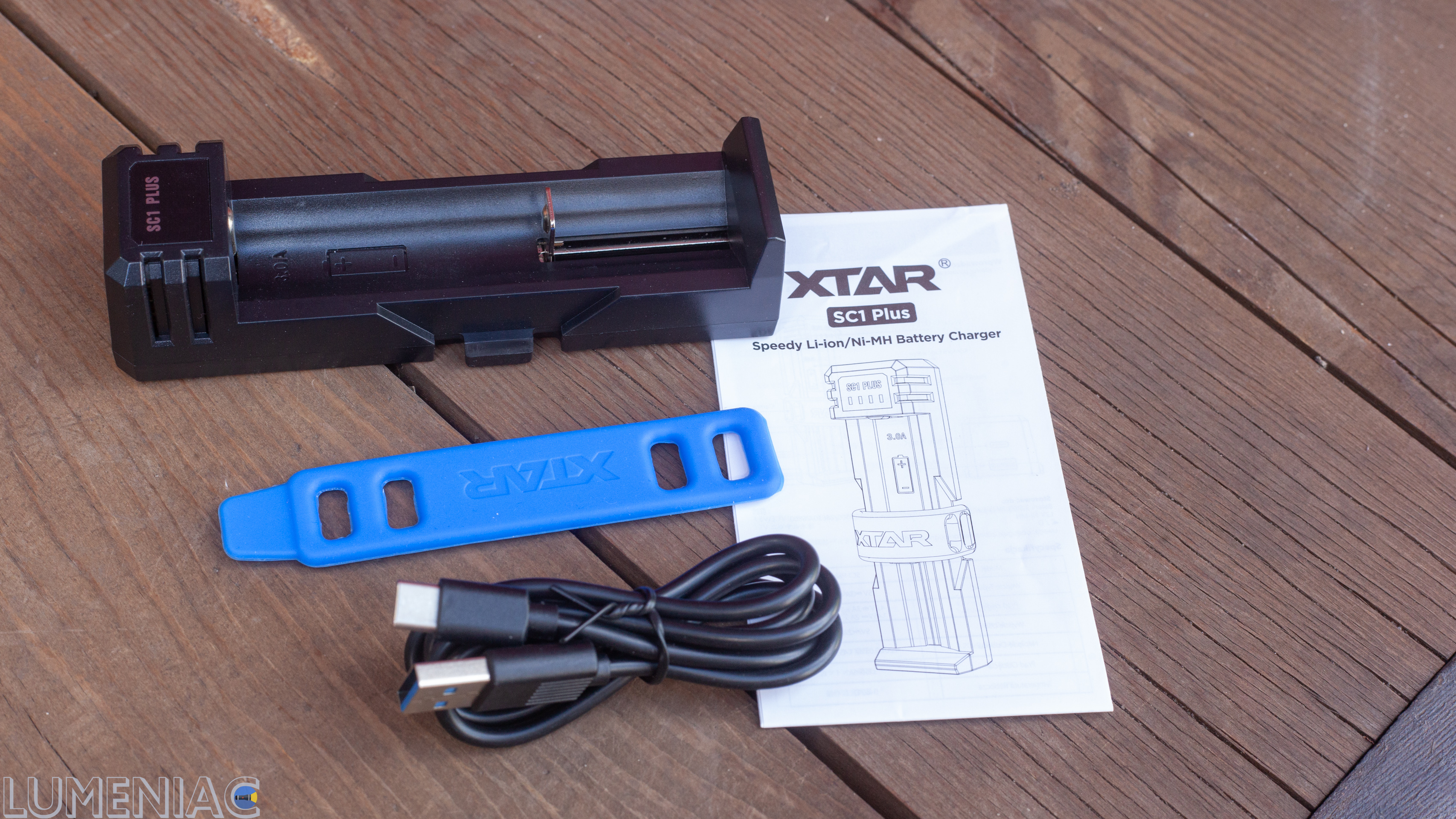

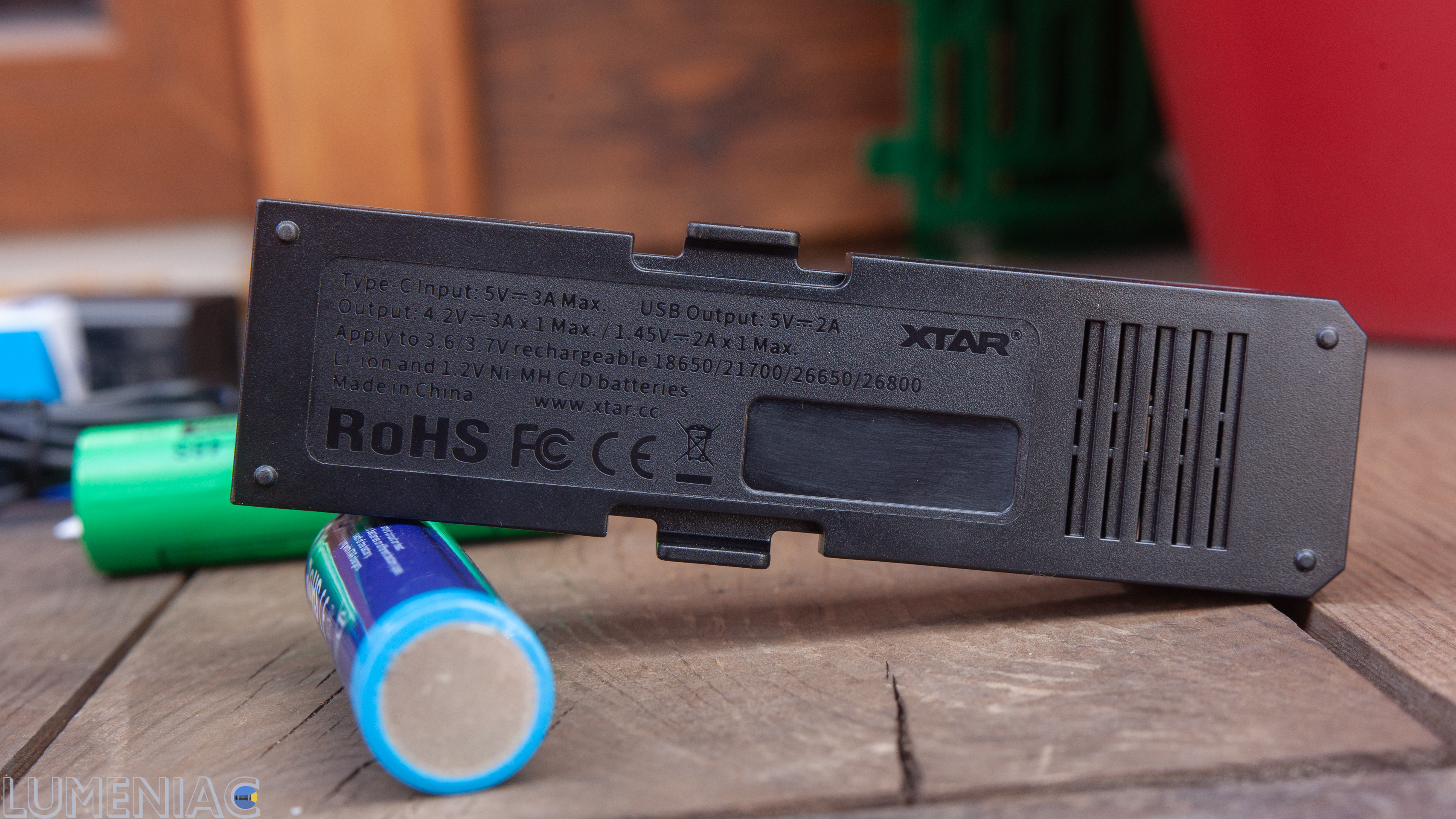

The kit includes a charger, a silicone strap and a type-c charging cable
In addition to the charger itself, you can buy a kit with an 18w power supply
Basically, Xtar SC1 PLUS this is the same Xtar SC1

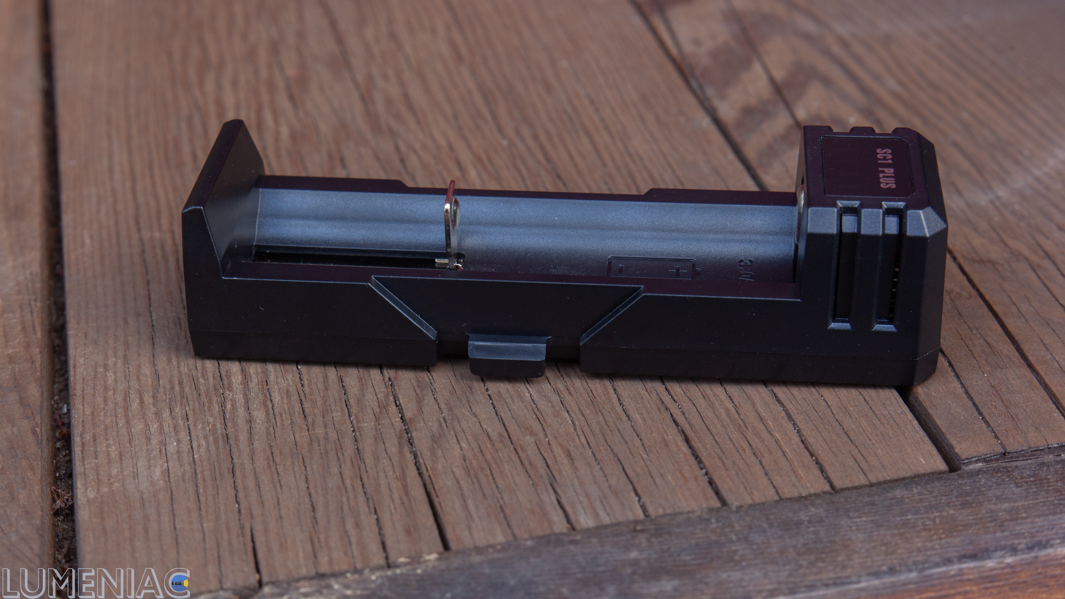

The main change is a cardinal increase in length. Now it cannot store only car battery -)

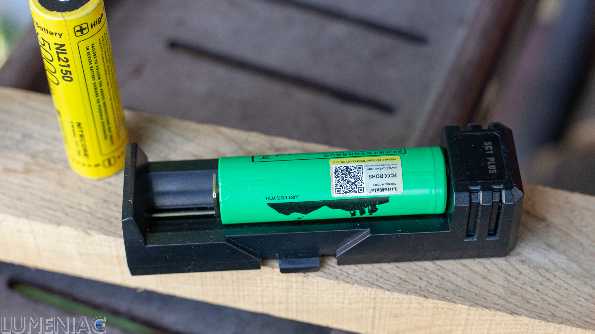

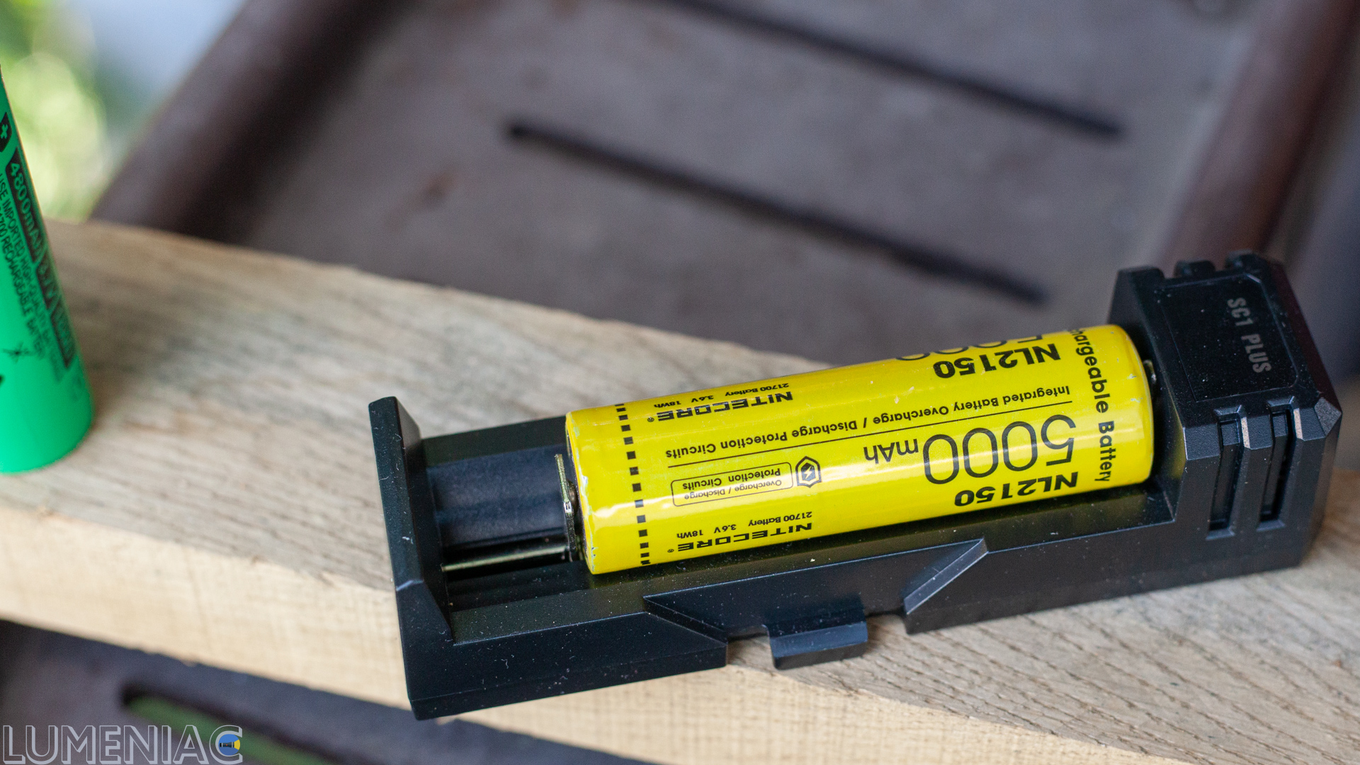

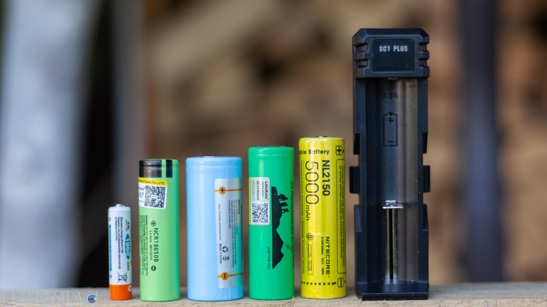

I do not have 26800 flashlights, but I can say that even the longest batteries I have, namely the 21700 modification by Nitecore, fit into the Xtar SC1 plus with a margin. Well, the same ones, with + - on each side and the price of a flashlight
No problem with usual unprotected 21700 and 26650 batteries, of course
and 18650…
I note that charger can technically also charge Ni-MH batteries, but the limitation on the minimum size of the battery does not allow you (and this is good) to charge anything shorter than extremely rare D-sized cells. Good because 2-3A current will be extremely harmful for AA or AAA battery, they will literally boil.

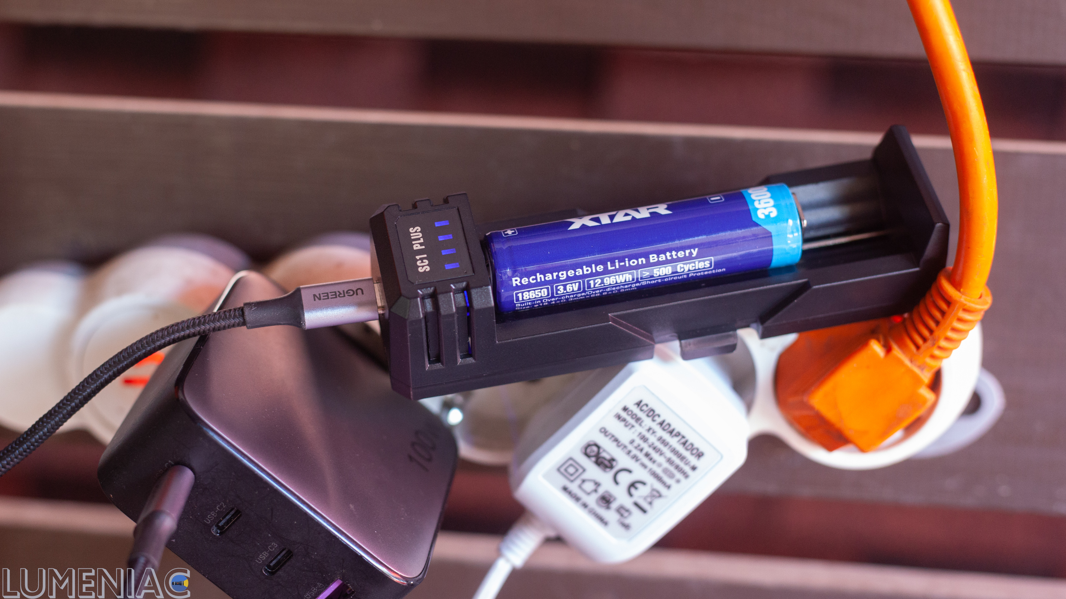

In addition to a large increase in length and a small in width, this charger for lithium-ion batteries also got a usb-A output, as well as taht the usual micro-USB input was replaced with Type-C along the way. Xtar like to stop halfway, not doing the obvious thing. And so is here, USB-C only works for charging. Well, at least this time it even supports USB-C cables…

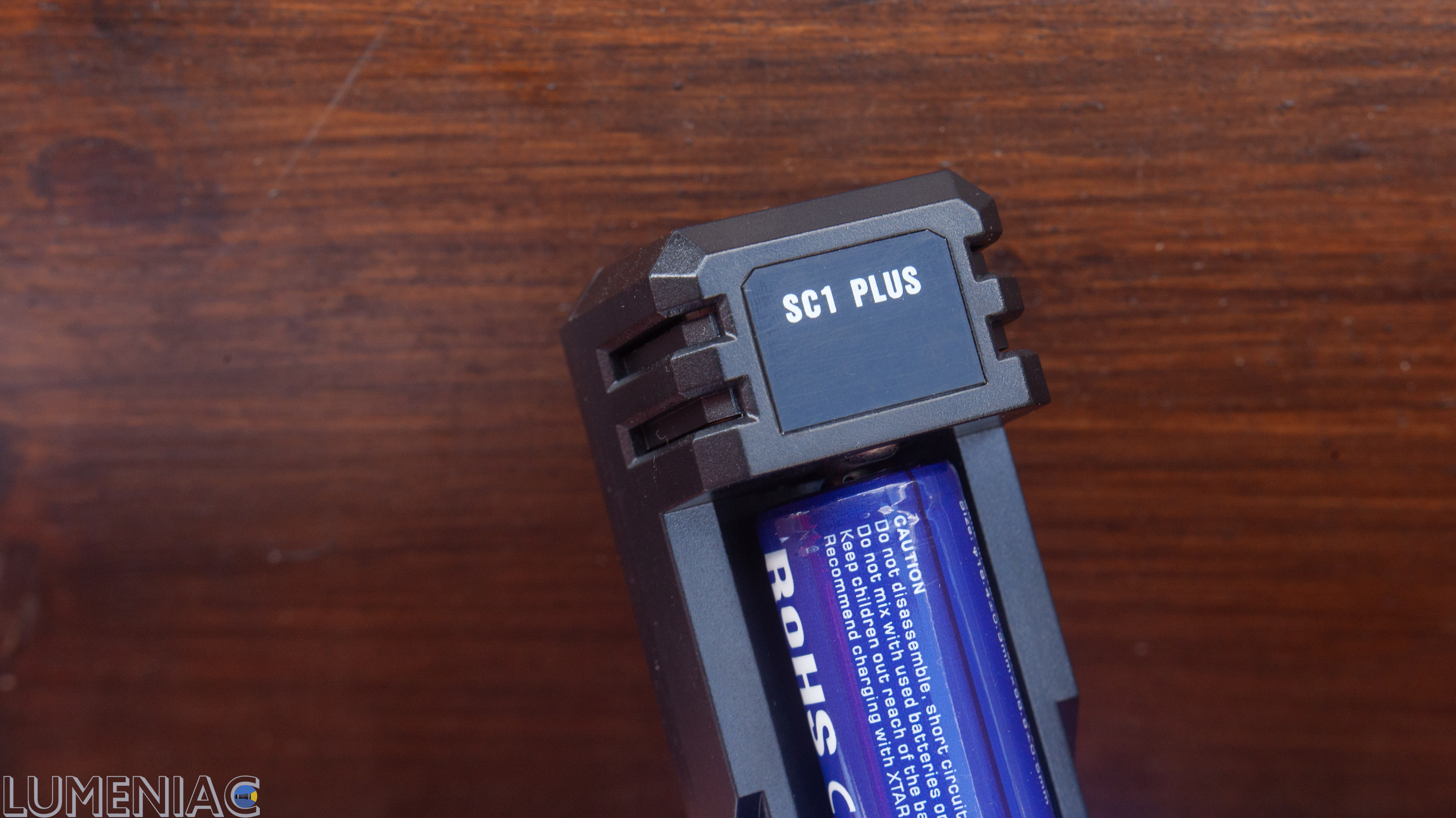

The indicator remained the same, the simplest 4-segment.

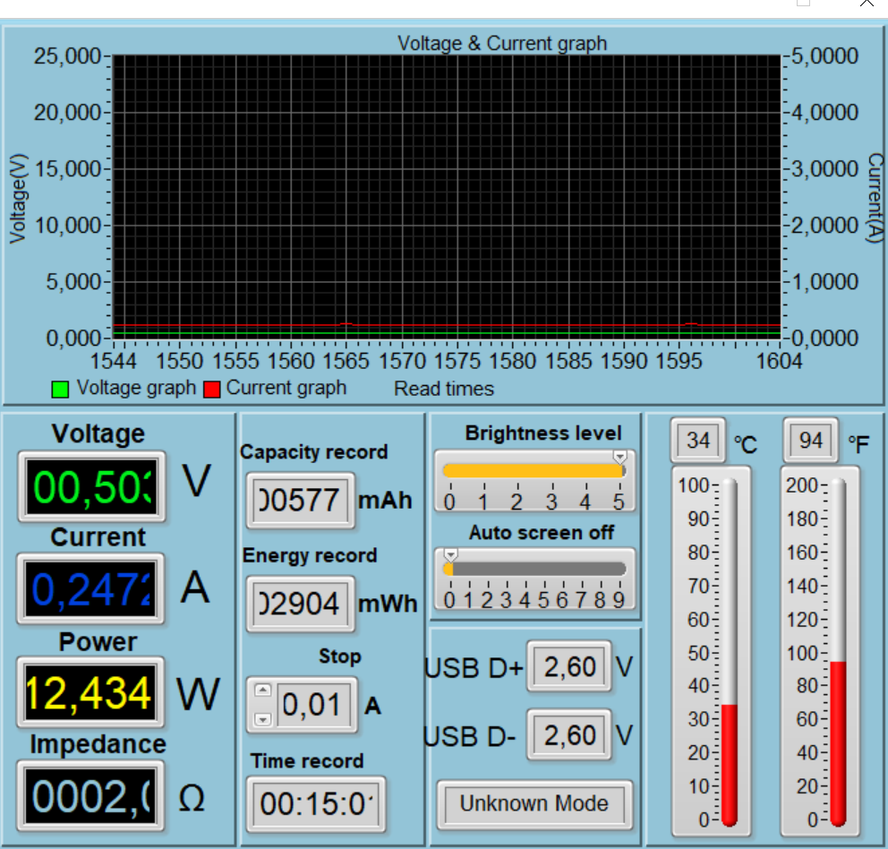

I do not have the opportunity to build a graph that would show the charging current-voltage *on *the charging contacts. However, though I criticize Xtar for something, but the algorithm and charging process have never caused me any complaints and I use the Xtar VC8 plus as my standard charger.

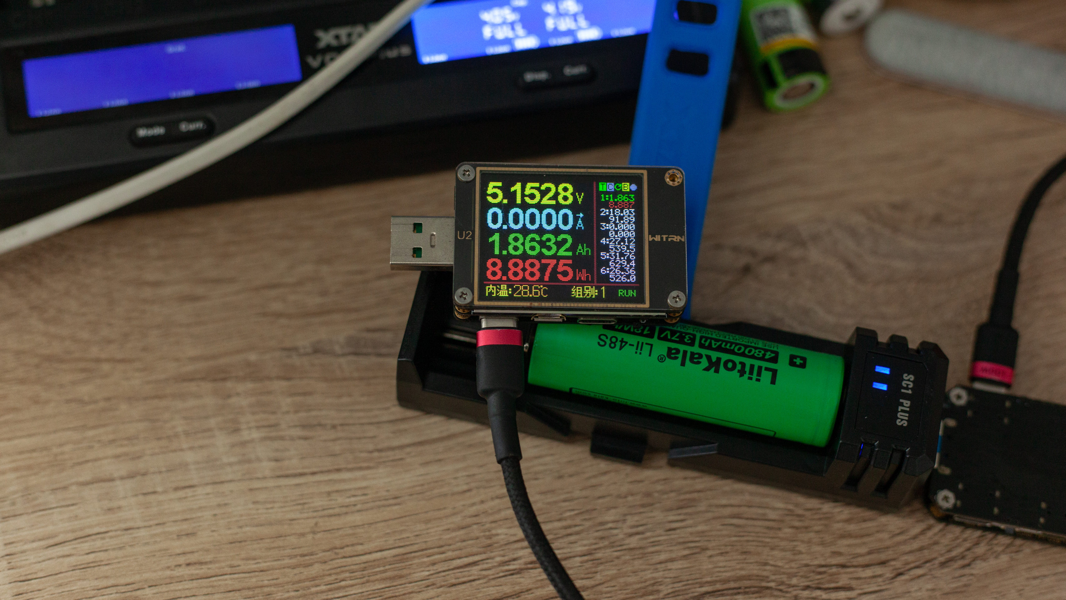

Xtar SC1 plus consumes about 12 watts, which means it is quite capable of delivering 3A to a battery that is being charged. The application from screenshot does not show correct numbers, showing the current and voltage by 1 order less, but the power here shows the real one.
The charging process is generally quick and you won’t have to wait. If you are charging a 21700 or 26650 battery, let alone a 26800 battery, then the charging speed will be quite decent. It is worth noting that the Xtar SC1 plus slightly undercharges the batteries, the voltage in my case was about 4.17-4.18v. But this is an insignificant difference that can be neglected - overcharging is way worse.

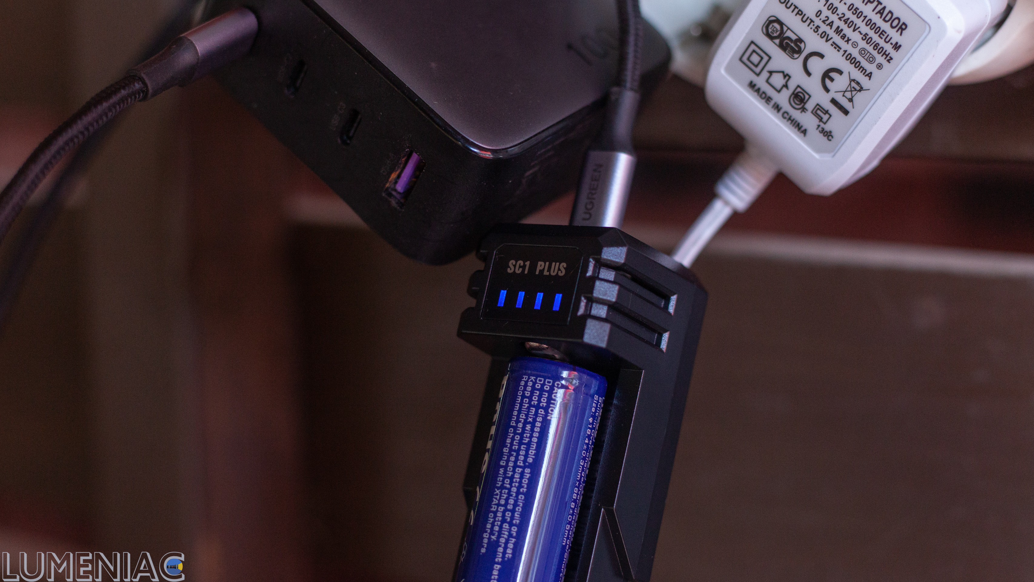

The rubber strap firmly holds the battery and you can charge it on the go from a power bank or even a solar panel
The power bank mode did not impress me. Yes, I got 2A output current, but in this mode Xtar SC1 plus stopped working at 3.7v. However, if you use a capacious 21700, 26500 or 26800 battery, it will help to at least half charge your phone.
