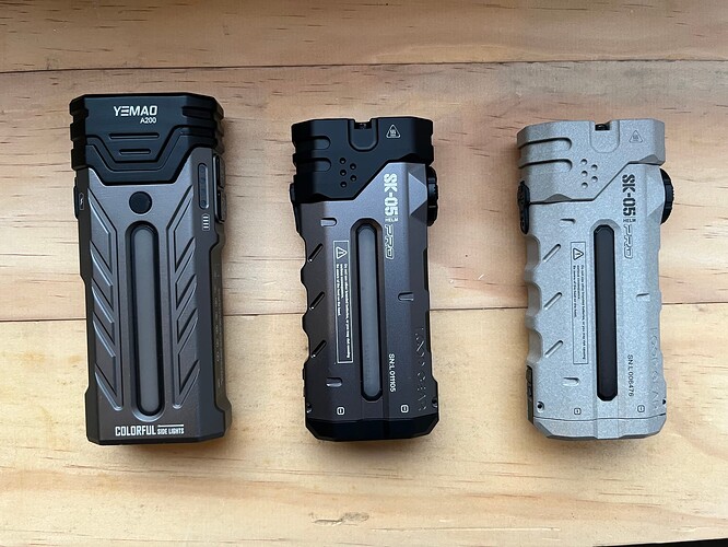

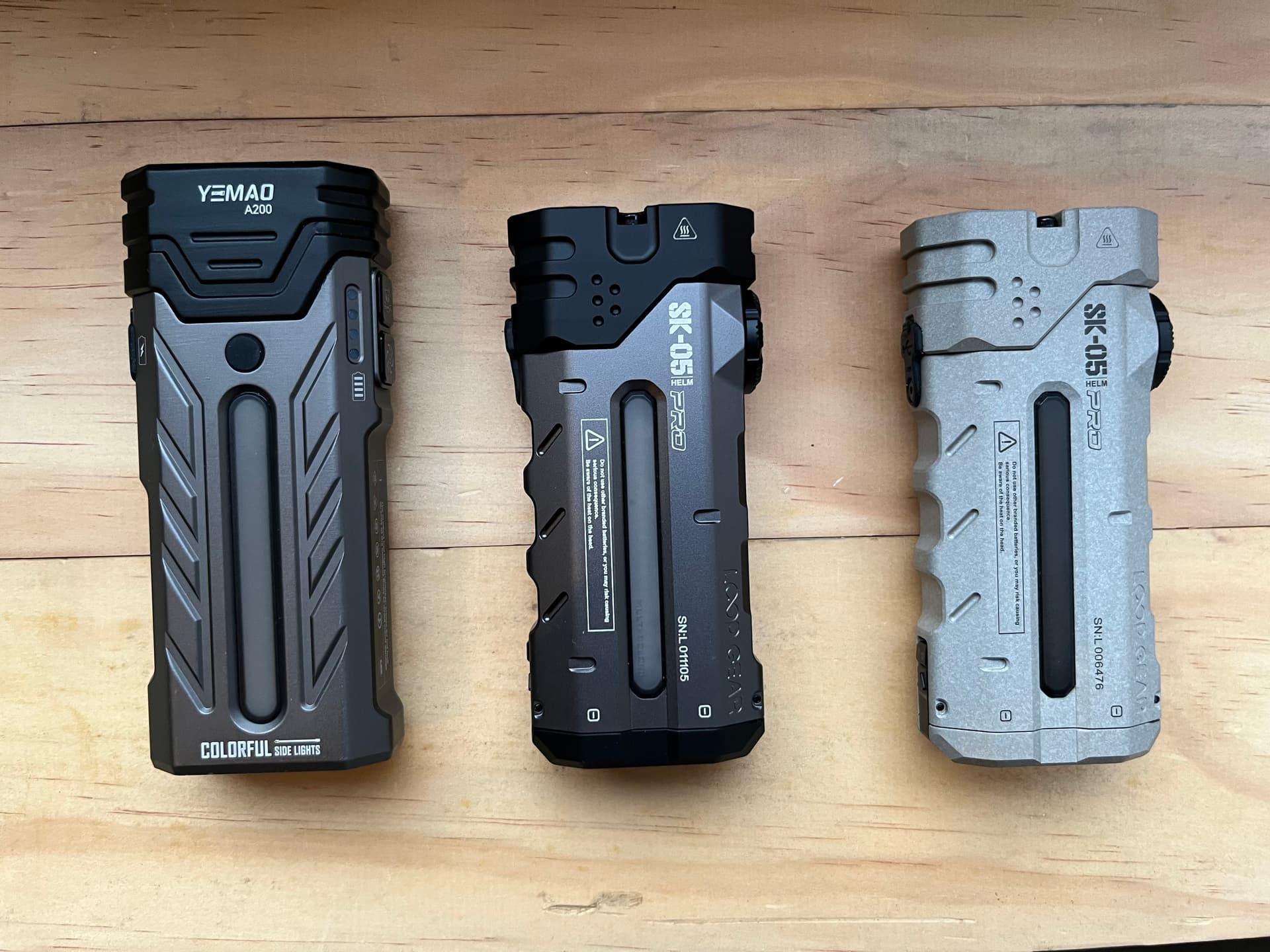

Sorry for the late reply.

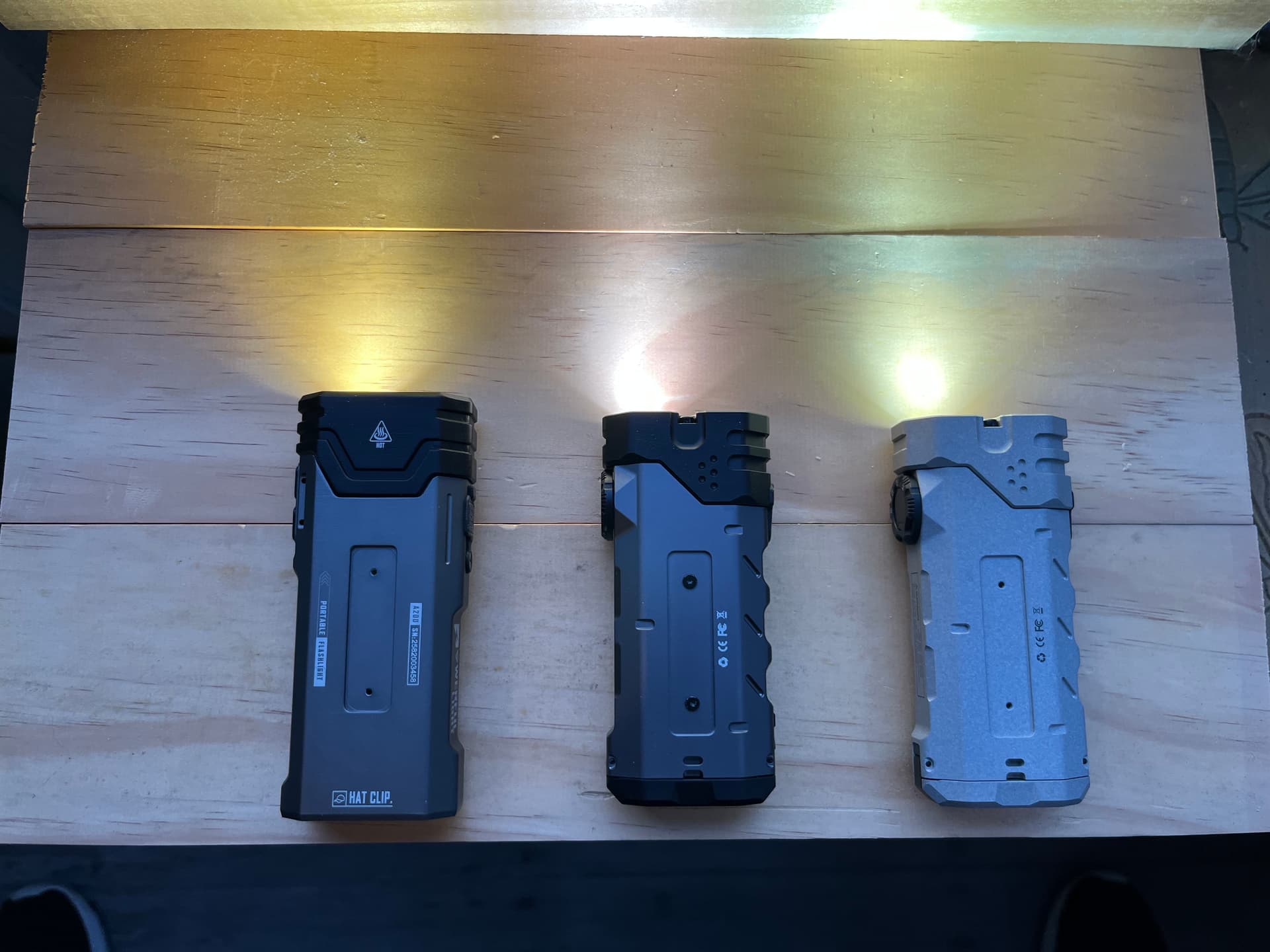

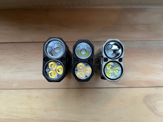

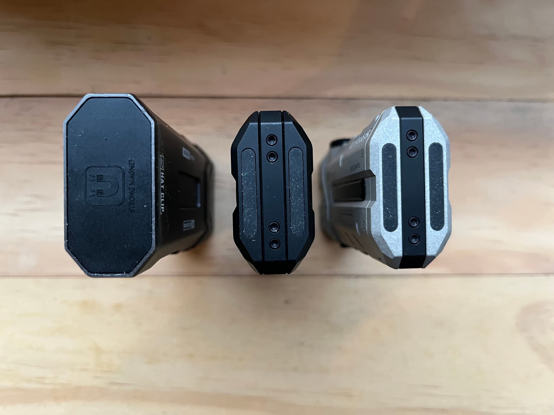

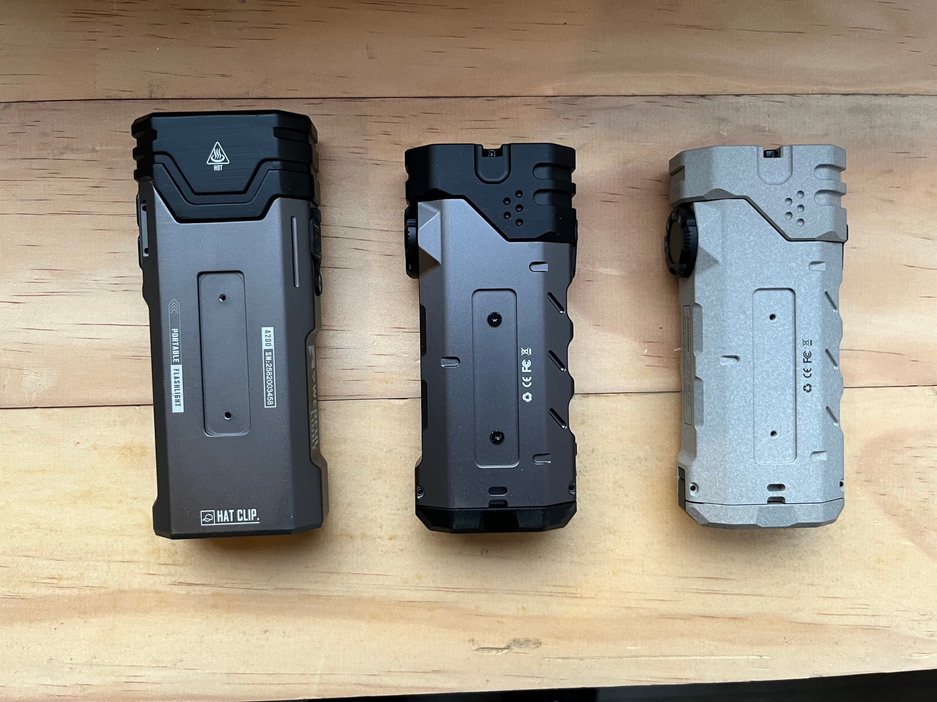

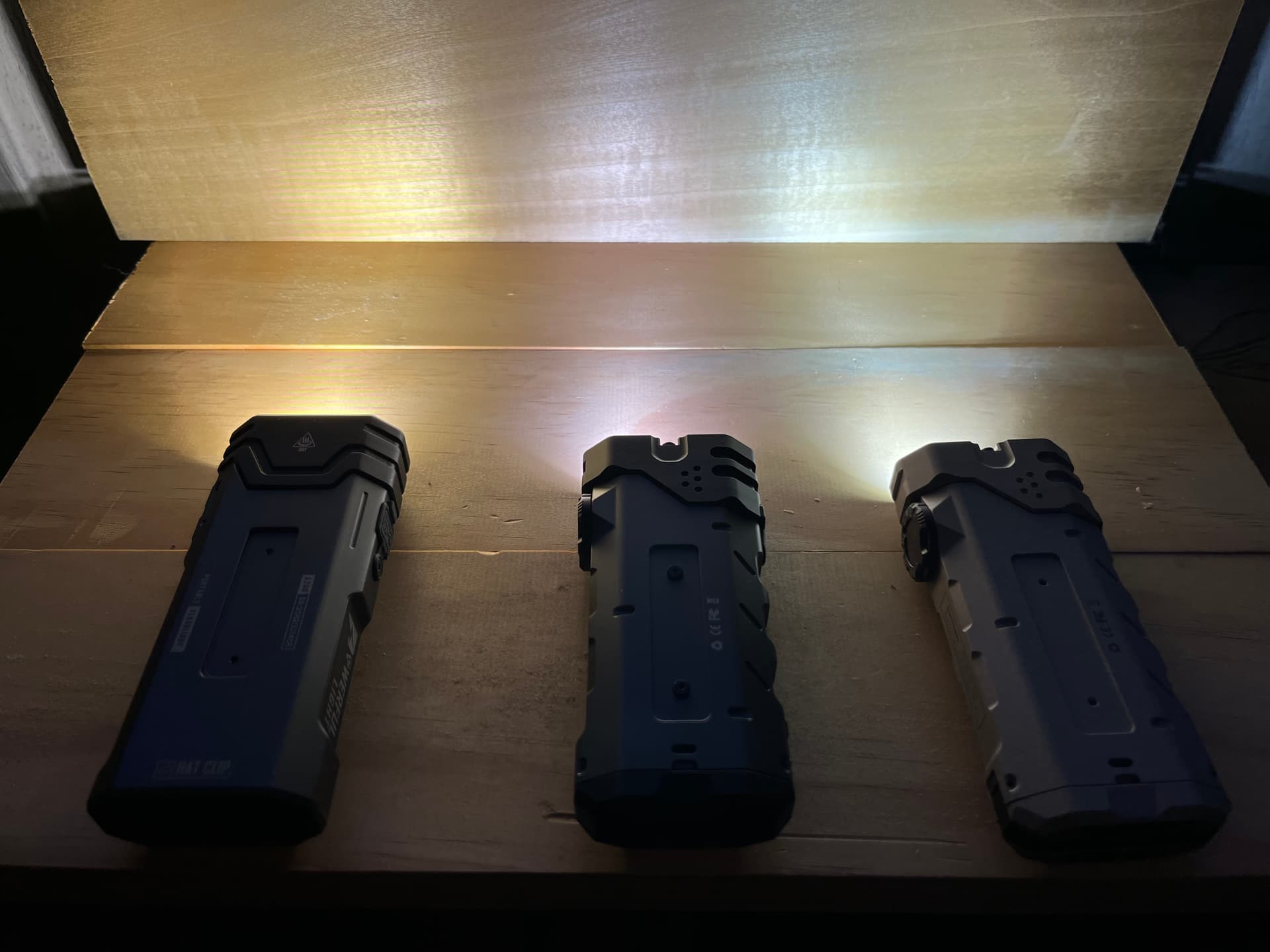

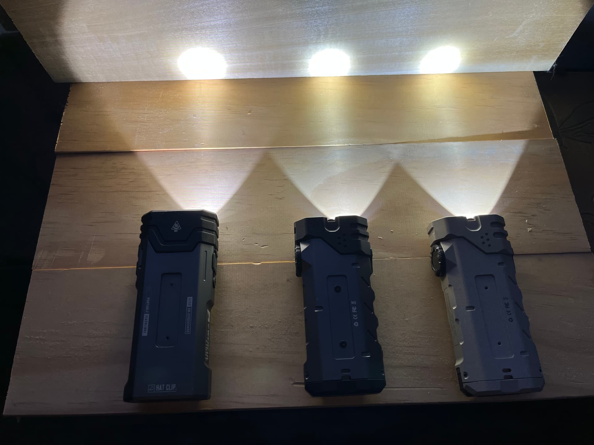

Below are comparison pictures between the A200, LoopGear SK05 Pro (grey and MAO).
The A200 is a pretty good clone of the SK05 (closer to the non-pro version since the battery is not accessible)
Overall, I’ve been very happy with it.
I’ll update with beam shots and lux measurements soon.
I did emitter swaps on the A200. Both flood and spot appeared to use the same LED with ~ 6000K tint.
I swapped the flood for LHD351D (4000K) and the spot with SFT-40 (5000K).
Weight (with battery) and dimensions below.
| A200 | SKO5 Pro (grey) | SK05 Pro (MAO | |
| Weight (g) | 238 | 226 | 230 |
| L (mm) | 113.7 | 106 | 106 |
| W (mm) | 50 | 48.8 | 48.8 |
| H (mm) | 25.7 | 24.4 | 24.4 |
