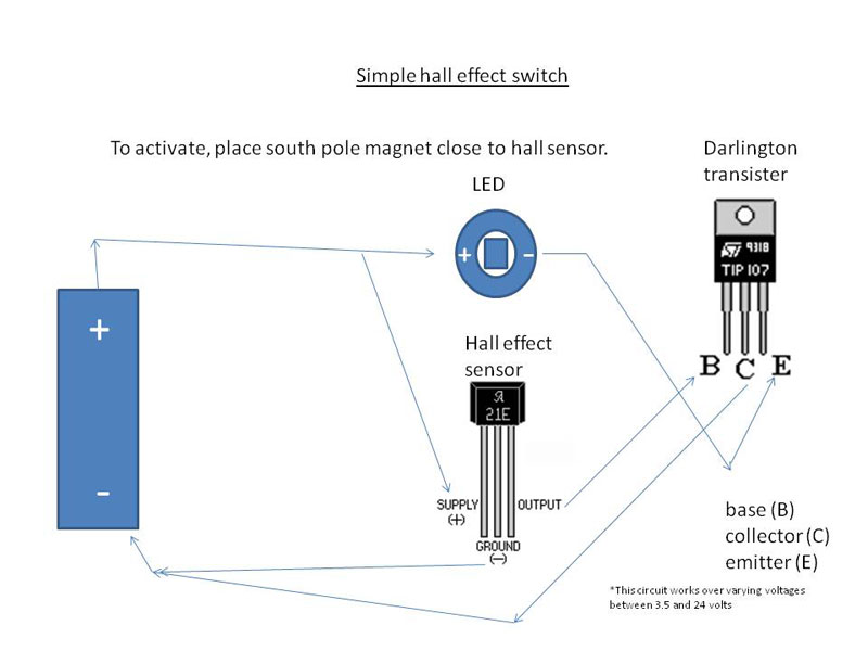

that has a magnetic switch ring, so the driver has hall sensors. You would need a specialized driver to swap that out. I've never seen compatible ones sold.
taskLED sells some (example). Guys have done dive light builds with them.
