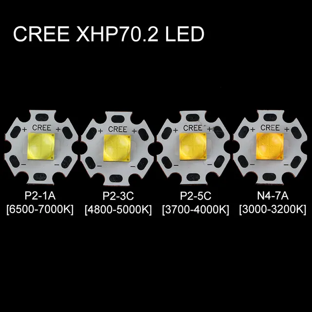

RMM charges $8 extra to slice the dome. Would that be a fair bump in price to get a dedomed SP70?
I don’t know if Sofirn can do it and if so, would they want to do it. It adds a lot of extra complication to the assembly as well as packaging since it will need to be kept seperate from the regular version. It may even slow down the production times. Maybe they could do a limited number for those few who want it and can’t slice it their self. It would probably cost extra, though.
I also don’t know if people would really like the sliced 70.2 beam. I’ve heard it gets warmer and the corona gets more yellow. I have not tried slicing a 70.2 myself. I’ve only sliced the older xhp70. It lost a noticeable amount of output, like 20% to 25% and I didn’t like that do I stuck a new emitter back in. I believe the 70.2 only losses around 15%.
Something as to consider is if Sofirn uses a neutral white 70.2 like a 5000K, and you slice it, you may get too warm a color so maybe a 5700 would be a good choice for a single tint. We have not talked about tints, but I’m sure we will eventually. Typical 70.2 tints I’ve seen are 3000K, 4000K, 5000K, 5700K, 6000K and 6500K.
From the Convoy store.
