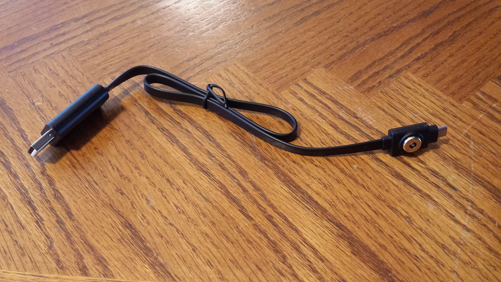

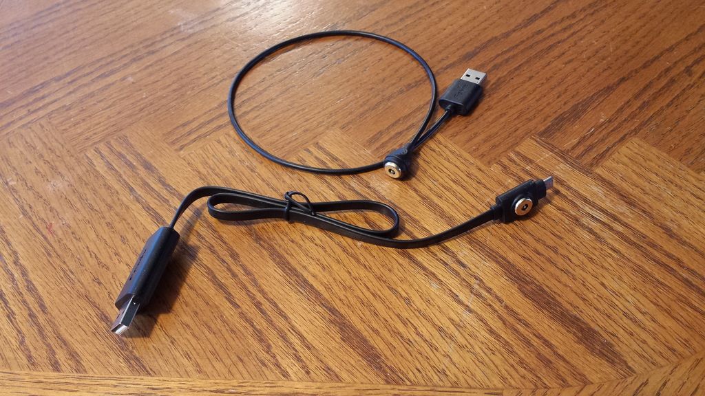

Magnetic Charging
The magnetic charging cable should have been longer. If you are plugging it into a wall socket with and USB charger and want to put the light on a desk like me, then the magnetic charging cable won't be long enough.
The magnetic charging cable is long enough if you plug it into a wall socket with a USB charger and set the light on the floor.
It is also long enough if you have a desktop computer on the floor or table, then just plug the cable into a USB port and set the light on the table.
The cable is also long enough if you have a laptop that you will be charging the light from.

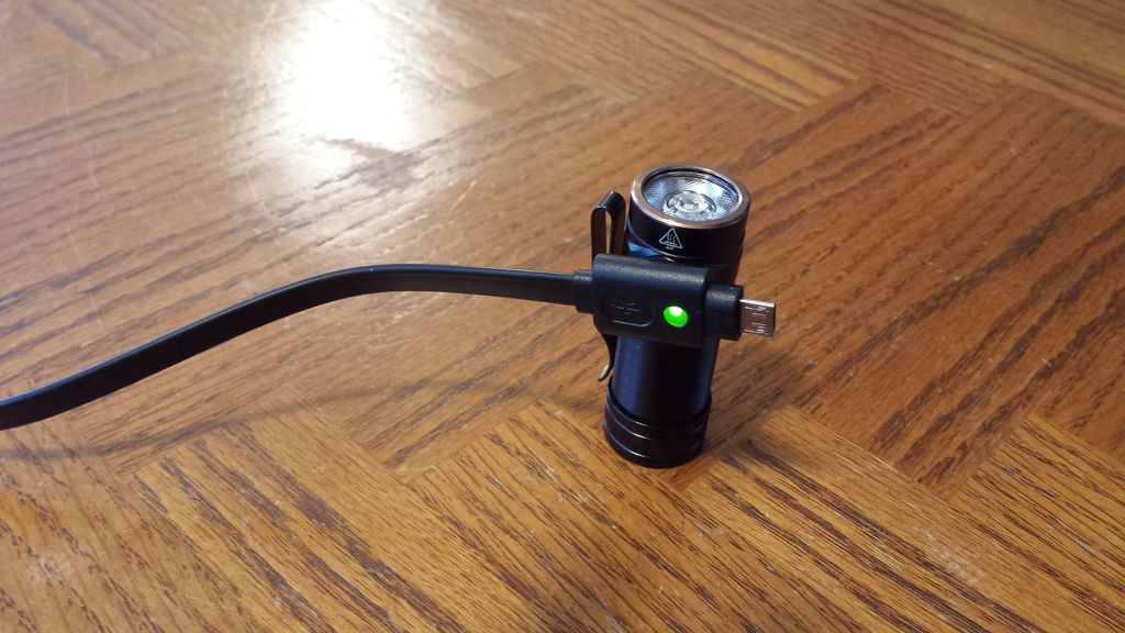

The magnetic charging cable has two LED lights in it. The orange/red LED color = charging, the green LED color = charging complete
You can use the light while it is charging but the charging time will be prolonged. I tried using the light while it was charging and it worked fine.
From the review that I have read the magnetic charging cable and magnetic port are not compatible with Fenix's other magnetic charging cables and magnetic ports.
One example is the Fenix RC11 magnetic charging cable can not be used on the Fenix E18R, and visa versa.
Update: 12/14/2018 - I just found out that Fenix does have a magnetic charging cable that will work for the RC05, RC09, RC11 and E18R.
Spare USB cable with magnetic connection plus MICRO USB connection, SKU: FX-MAGUSB. MSRP: $7.00
