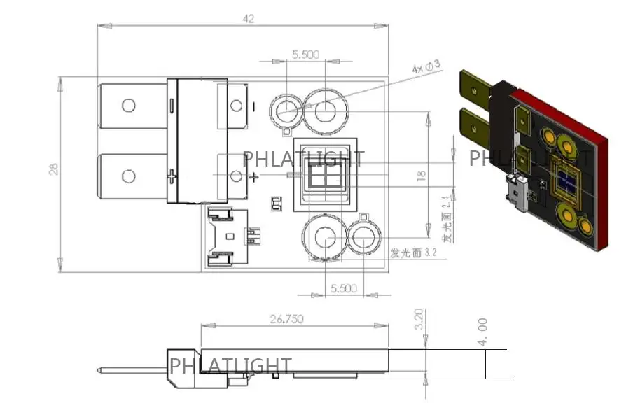

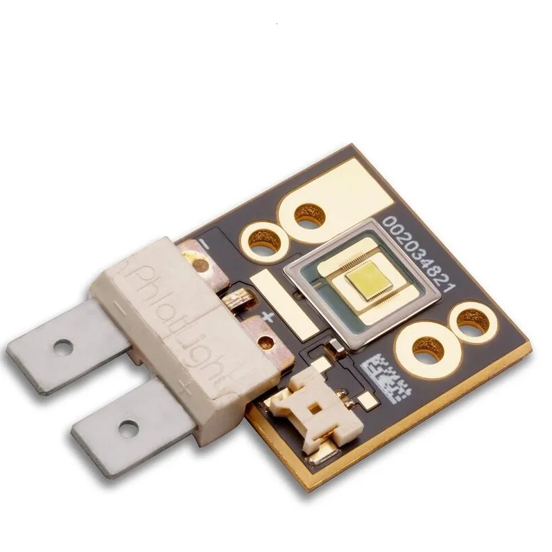

Recently I found some Chinese COBs meant for endoscopes, stage lights, projectors. They typically are styled after large Luminus LEDs but can have high CRI. This is a new area to me, so I’ll just give a few examples …
100W 7.68 mm² LED that’s advertised to beat SBT90.2 luminosity despite high CRI. Though the hole in the middle is an issue, if it matches the specs, it should be good.
https://www.aliexpress.com/item/4000339811390.html
Single die 60W 9mm², no strict CRI ratings
https://www.aliexpress.com/item/32333740921.html
