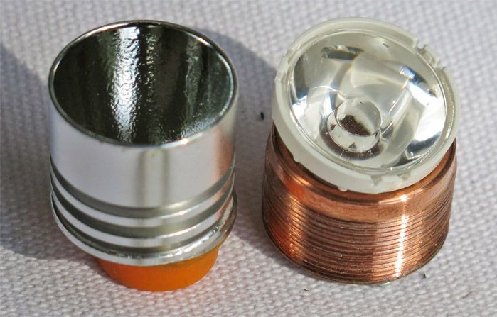

A 20mm reflector was also deemed necessary to replace the TIR which meant a new head built to suit the longer reflector. At the same time I'd at last be able to seal up the battery tube properly with some enclosed o'rings.
The reflector that replaced the TIR. The reflector is protected by a 20mm AR lens (not shown here).
The new parts that were used in the mod. For some reason the new head was not here at the time the picture was taken. I'll blame one of my assistants that got sacked while working on an earlier build.

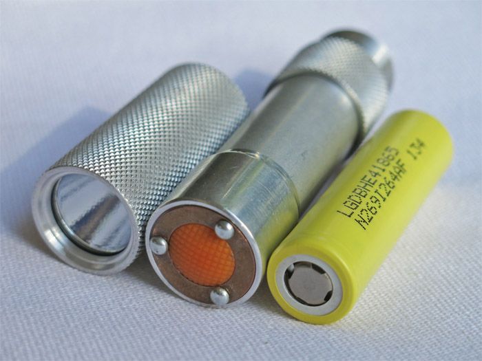

A shot of its rear and front along with an LG HE4 bought just for this light. Led was upgraded to a XML-2 U2 1A on a 16mm copper star. The switch spring has also had a piece of 22 AWG silicon wire soldered to it the same as the driver spring.

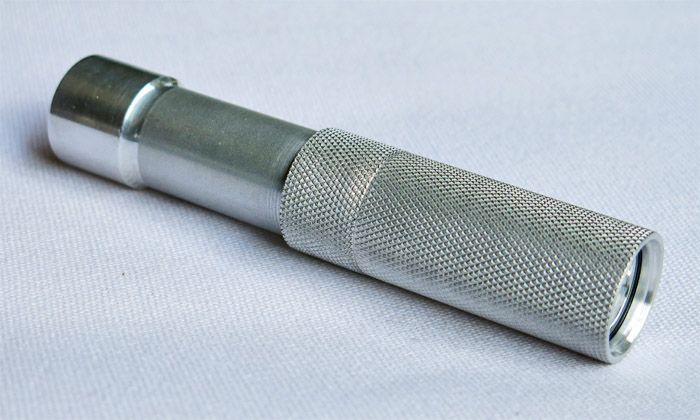

Ready for action.
