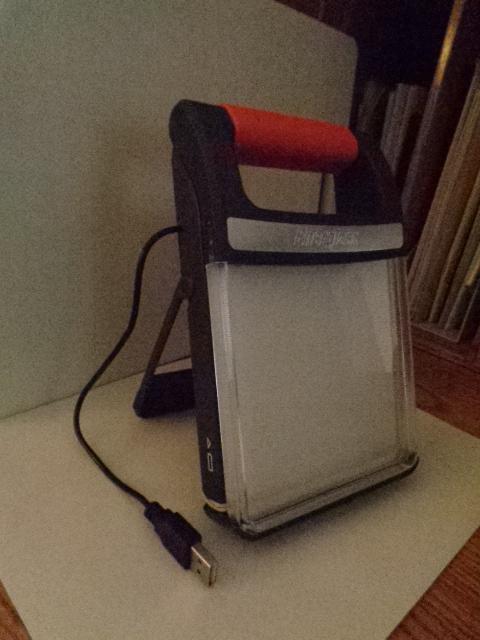

The Energizer Light Fusion Technology lantern might be an almost ideal lantern to convert to run off of a 18650 powered USB power box. About the lowest glare factor of any lantern I know of. It normally runs off of four or 8 AA batteries, alkaline or NiMH, so can handle 4.8 to 6 volts input. The 8 batteries are series/parallel so just increase run time at the same voltage as the 4 batteries. Looking at the construction it looks like just a matter of soldering in a male USB cable installed through a drilled hole and then plugging it into a USB power supply. I will first try it with a 2A or 2.4A USB source before also trying it with a 1A only limited current source.

I soldered a USB cable into the battery box of the Energizer 300 lumen folding lantern with light fusion technology. It works perfectly. The lantern is designed to work between 4V and 6V. The 5V output of a power bank is ideal. Overall it probably isn't the most efficient use of power, but it is VERY convenient.
Below is a link to a more complete review.
Here is a picture of the mod.
